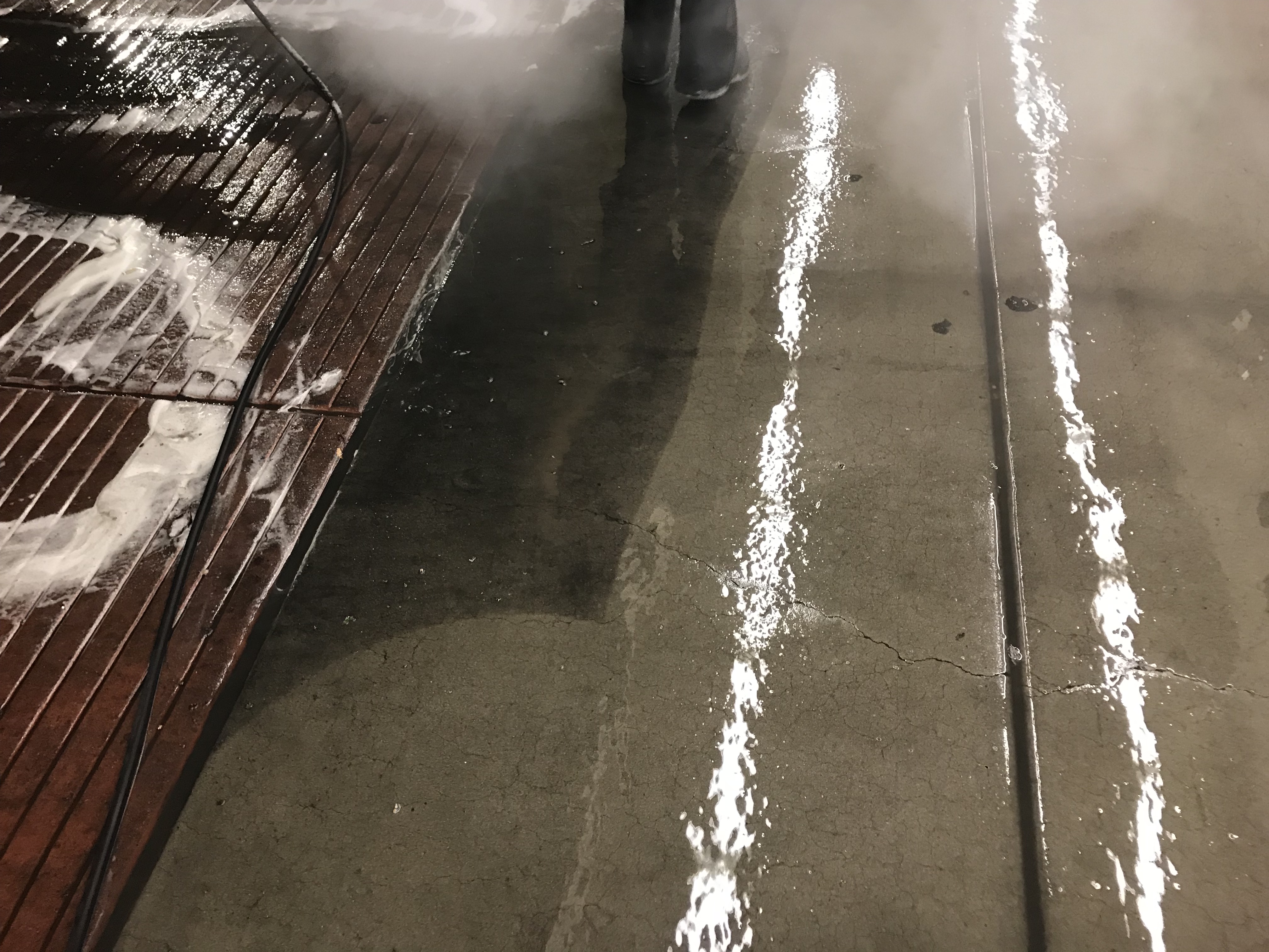

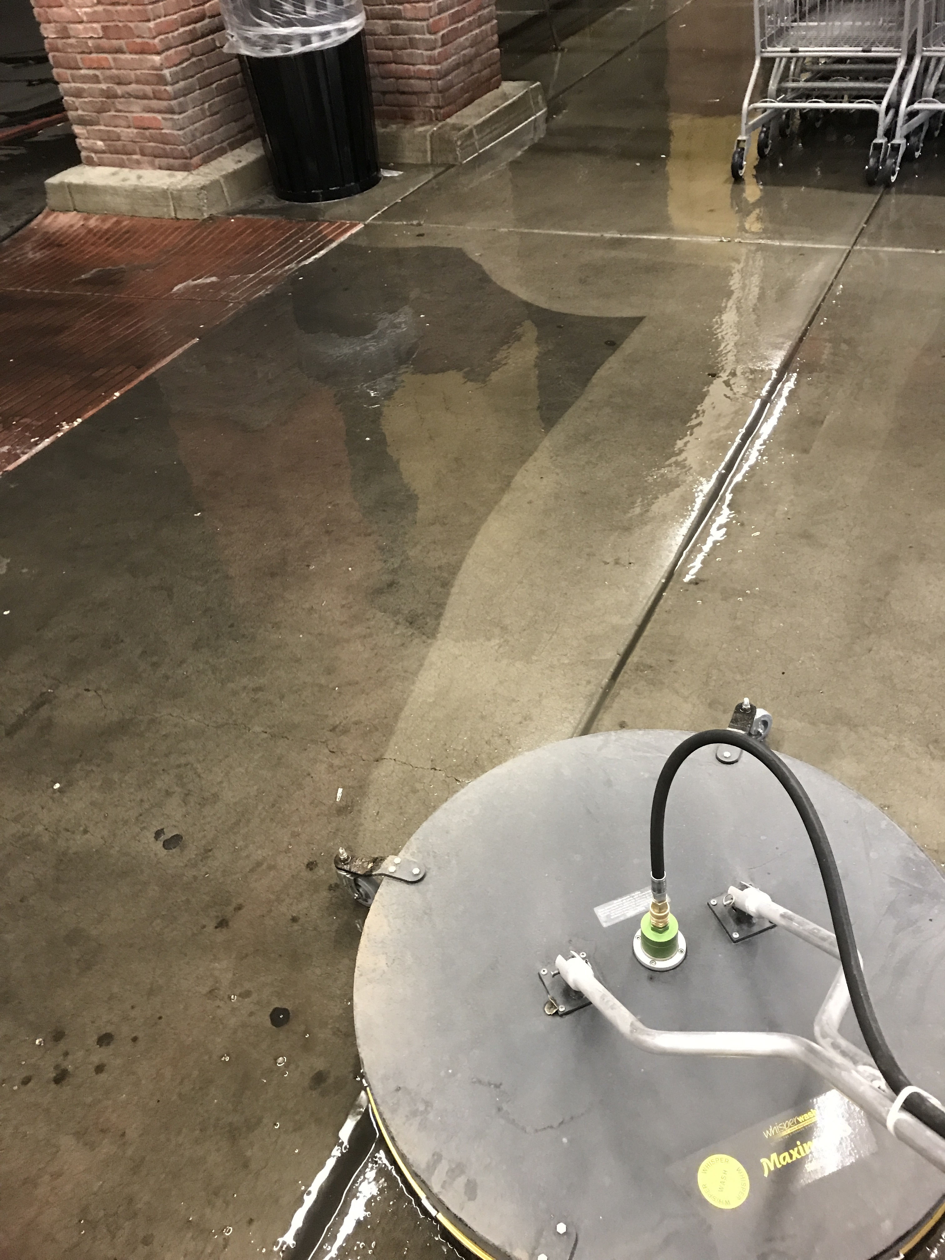

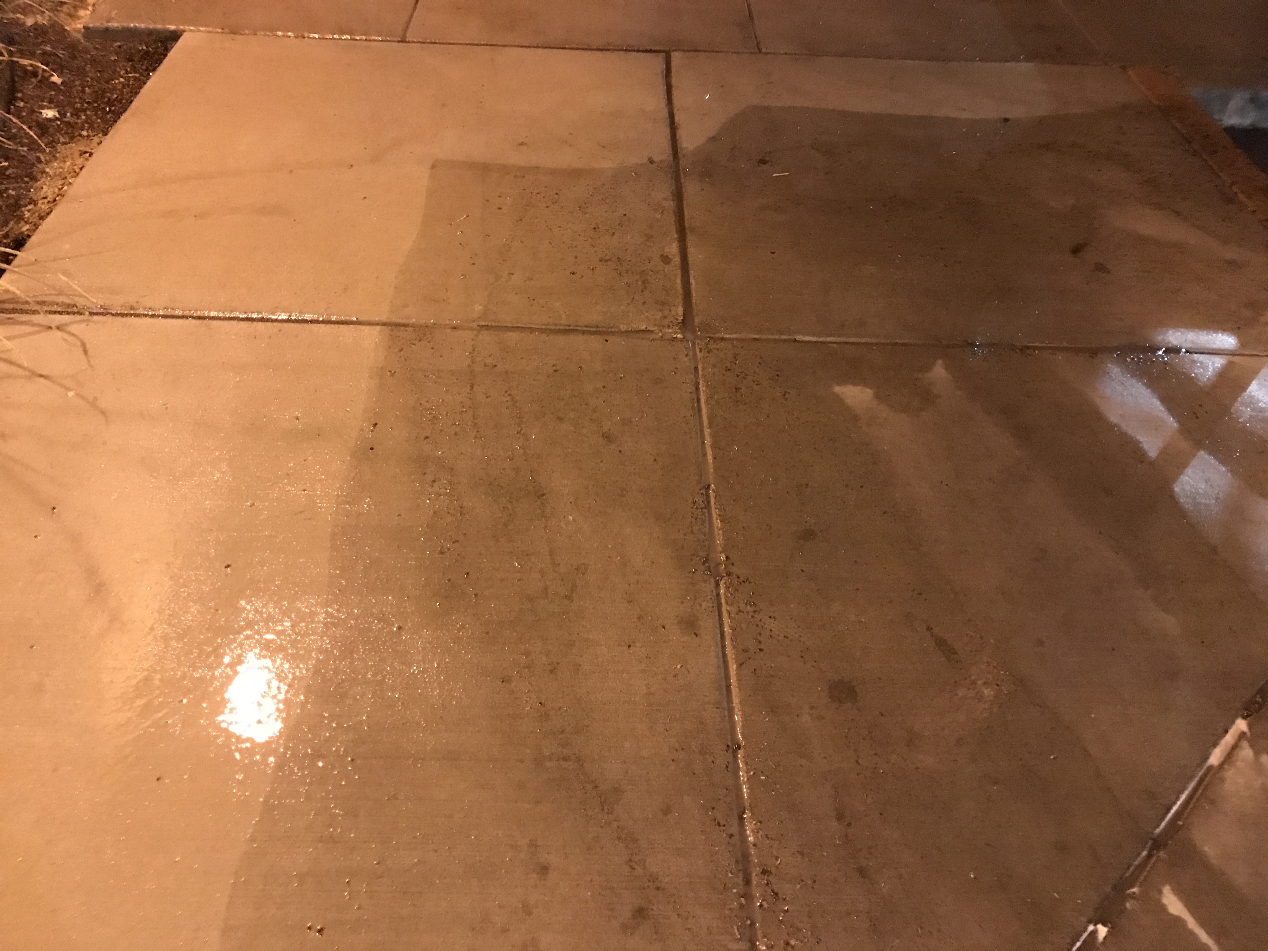

I don’t seem to have any videos of the surface cleaner in action, but I did come across a few satisfying photos (they also kind of show what we are cleaning up). I don’t believe we have anymore pressure washing scheduled until the first week of next month, I’ll try to remember to get a video when we knock out those accounts.
