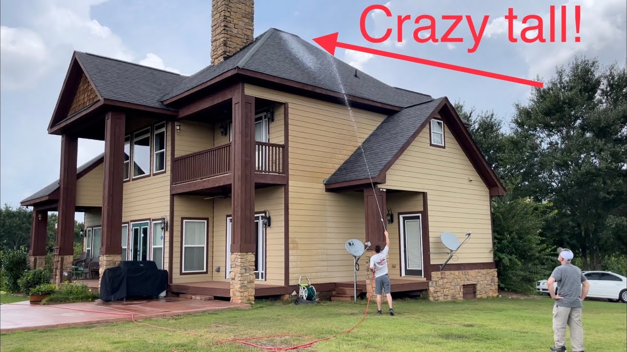

I haven’t used or tested a 24v but I’ve seen videos of good distance 50’ and 6GPM tested.
