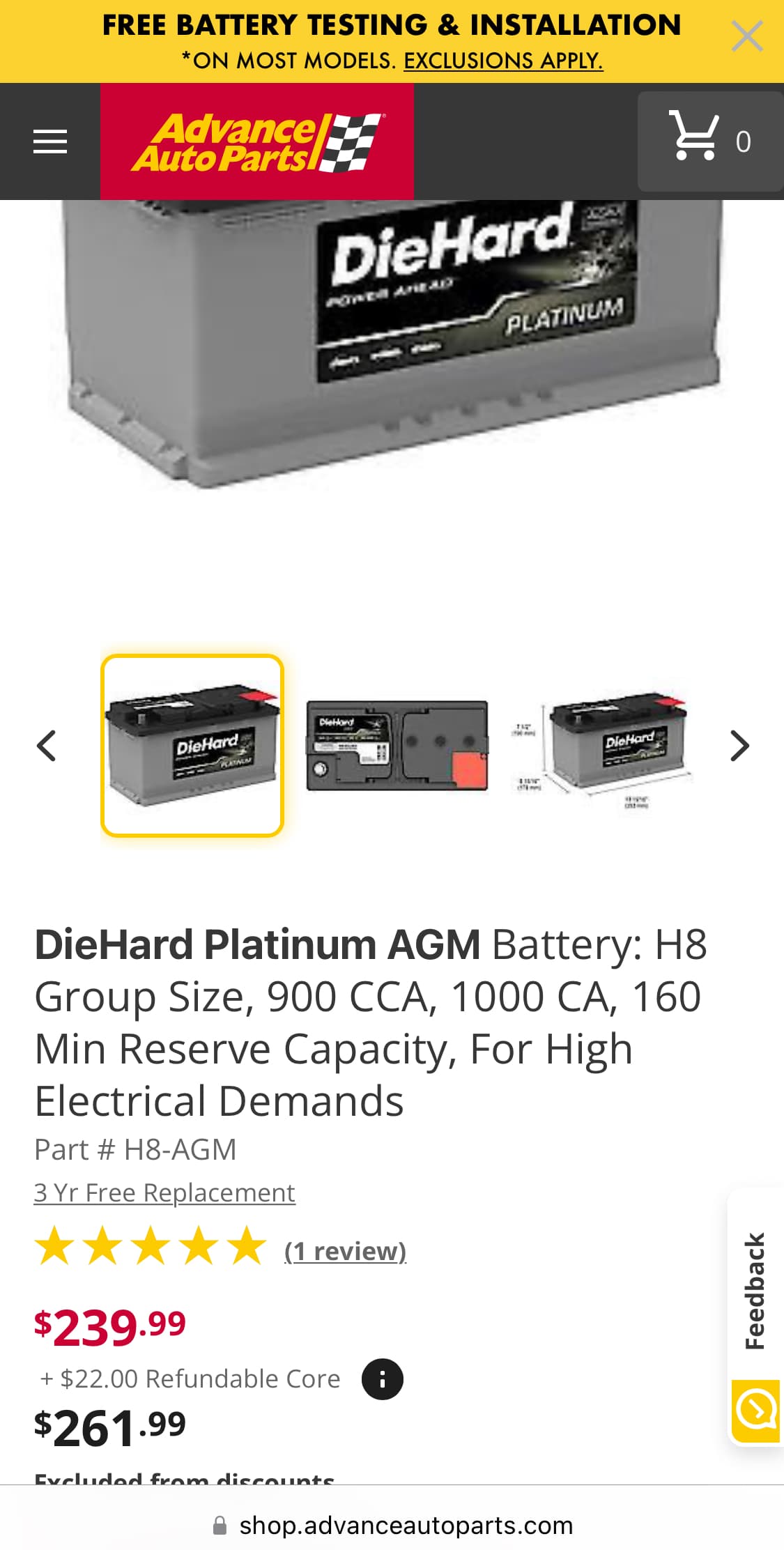

Anyone have objections to the following battery? I came across a “like new” one for $50 and am thinking of pulling the trigger on it. It would just be to run my 12v pump, one strobe light, and occasionally 2 pod lights.
https://shop.advanceautoparts.com/p/diehard-platinum-agm-battery-h8-group-size-900-cca-1000-ca-160-min-reserve-capacity-for-high-electrical-demands-h8-agm/10210828-P
Looks like a good deal to me….
$50 is a heckuva deal. I personally am not a huge fan of AGM batteries due to them losing their capacity over time and being sensitive to overcharging but for $50 I’d probably run it into the ground as many times as I could.
What @DisplacedTexan said. I tried a few of them over the years, wasn’t real happy with them, but for $50, what the heck
I can tell you that the Schertz Box absolutely nuked two AGM lawn mower batteries in less than two hours of run time. Brand new and theoretically not undersized but they just could not handle it. I now run the box off of the parallel 12v batteries for my soft wash system. I don’t think they even know that box is there.

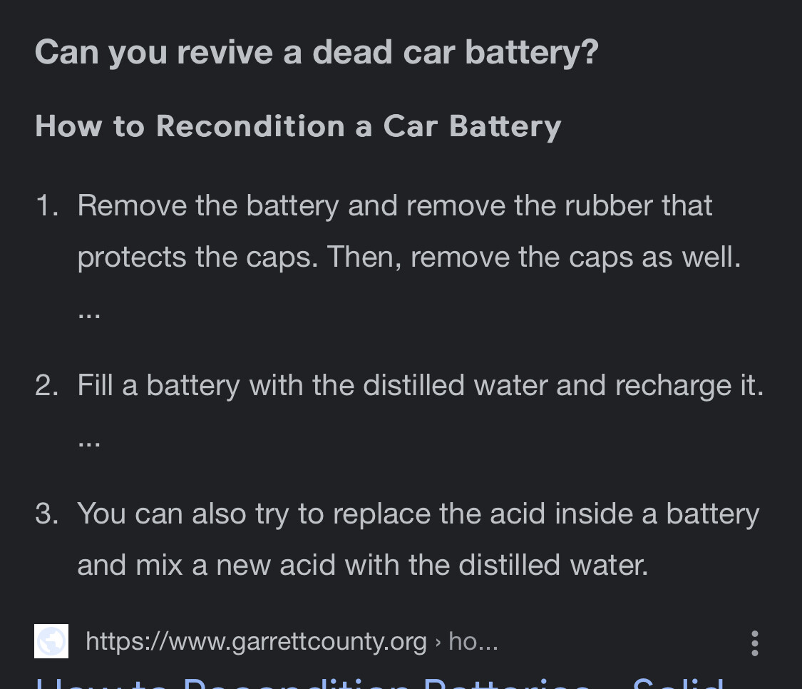

Have you tried reconditioning it? I’ve had pretty good luck with that on my little batteries in the past. Just not the AGM ones lol
I’ll have to look up whatever reconditioning a battery is.
:slight_smile:
Hell, I don’t get that involved. Just slap it on the charger and jam the “Recondition” button and voilá
Something about charging it at a higher voltage initially then dropping down to a lower voltage for an extended period. I don’t know. It works though!
You’re trying to drop the sulfation from the cells with the heavy current
