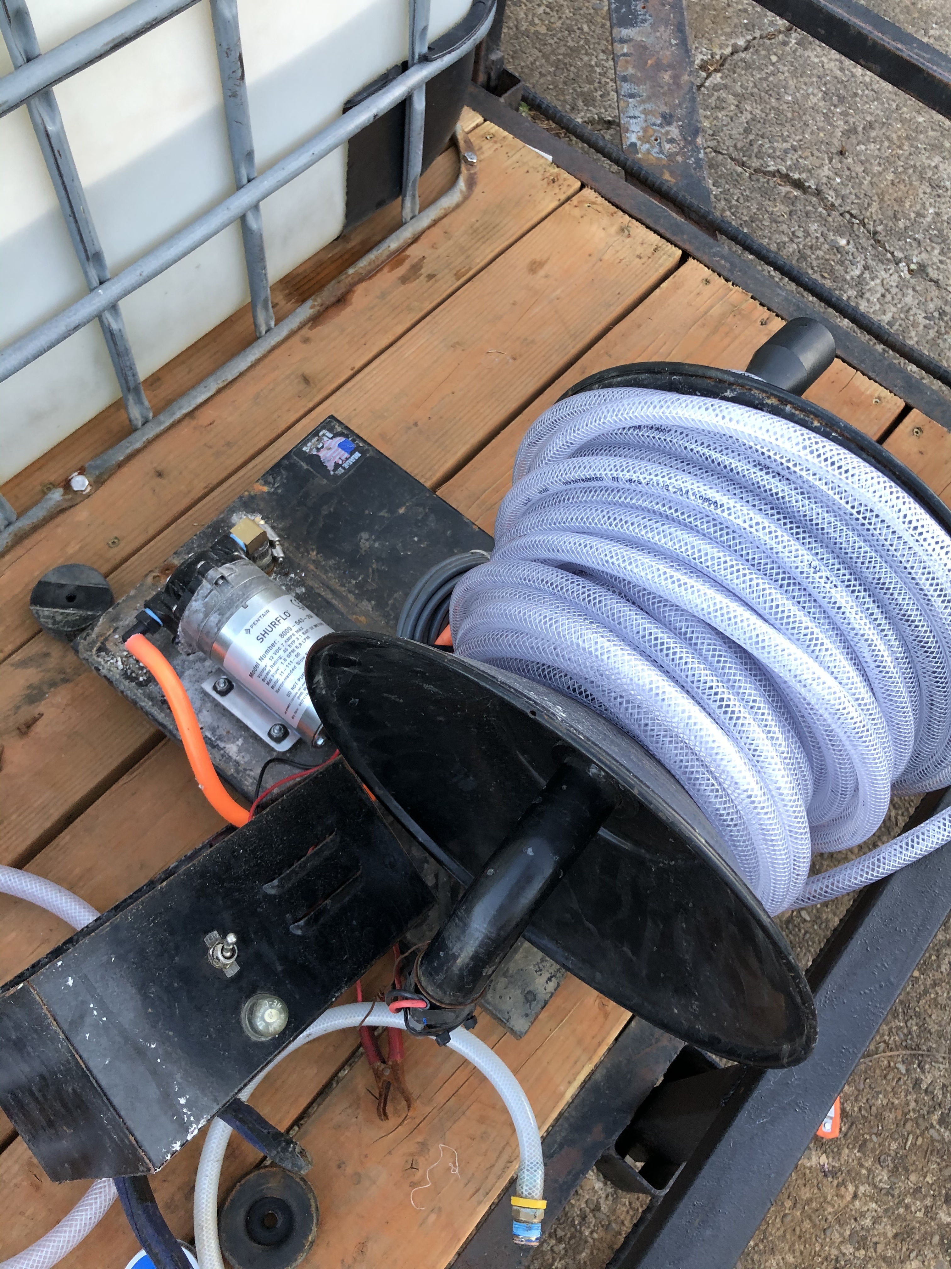

I recently did a roof with my xjet and that worked fine because I was on the ground, turned my motor down a bit to allow a bit more concentration. But for houses that I need to fight gravity with I have this small electric 12v pump. 1.8gpm , 120’ of hose on a reel. I can cover a 10x10 space in a couple Minutes. Is this practical?With such low GPM would that justify usage?
If not should I just buy a another pump. Thanks

Over haul the pump & hose + reel ! Get a 5.5-7gpm, up to 60-100 psi with 1/2 in di hose…
