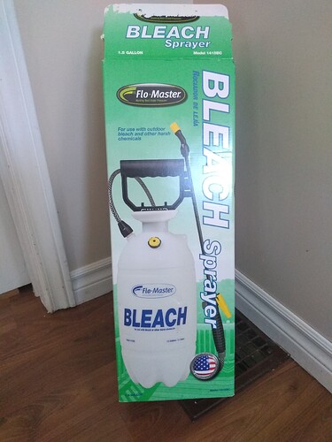

Lowes has a pump up made just for applying bleach. Although, I could not get a stream out of it, just fan, it sprays well.
