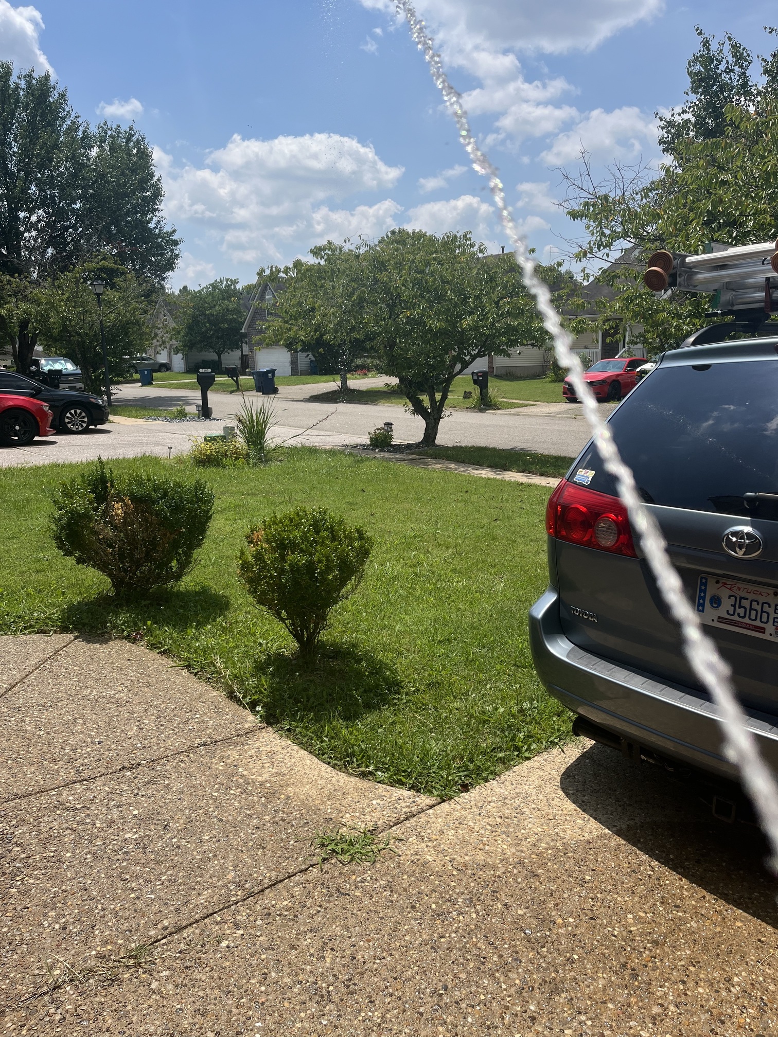

Edit: For the heck of it I hooked up a spare 2315. The plastic gun did 5 gallons at 1:30, the 2315 at 1:35. Yes it’s somewhat less free flowing but the distance is almost the same.
A little hard to see but it’s spraying to the corner of the sidewalk and neighbor’s driveway.

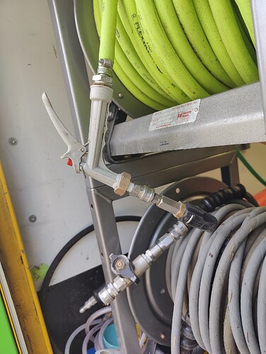

Have you tried a ball valve style garden hose sprayer? This is what I use:
It’s a bit heavy, but that’s because is extremely well built and comes with a 10 year warranty. There are cheaper options similar to this from Dramm. I have one of those too, but the thumb control on the Eley is super smooth and easy to move, so I prefer it.
How does that brass hold up?
Crap, didn’t think about that for a normal 12v setup. I’m not running SH through it, so I can’t tell you how well it will hold up for you. I would think as long as you rinsed it after using it, it would be fine. The Dramm one I’ve tried is a plastic ball valve inside, so it should hold up fine. The connections are brass, but not the inside.

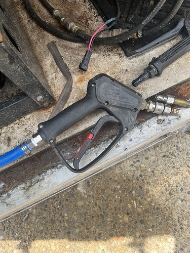

Edit to show the actual gun I use for 12v applications:
I’ve been using these…
They are dirt cheap and when my gun craps out (lasted all last year and a third of this one) I just swapped same brass hardware onto another new one. No trigger guard but I’ve not had many issues with it spraying crazy.
Been doing the same for a couple years now.

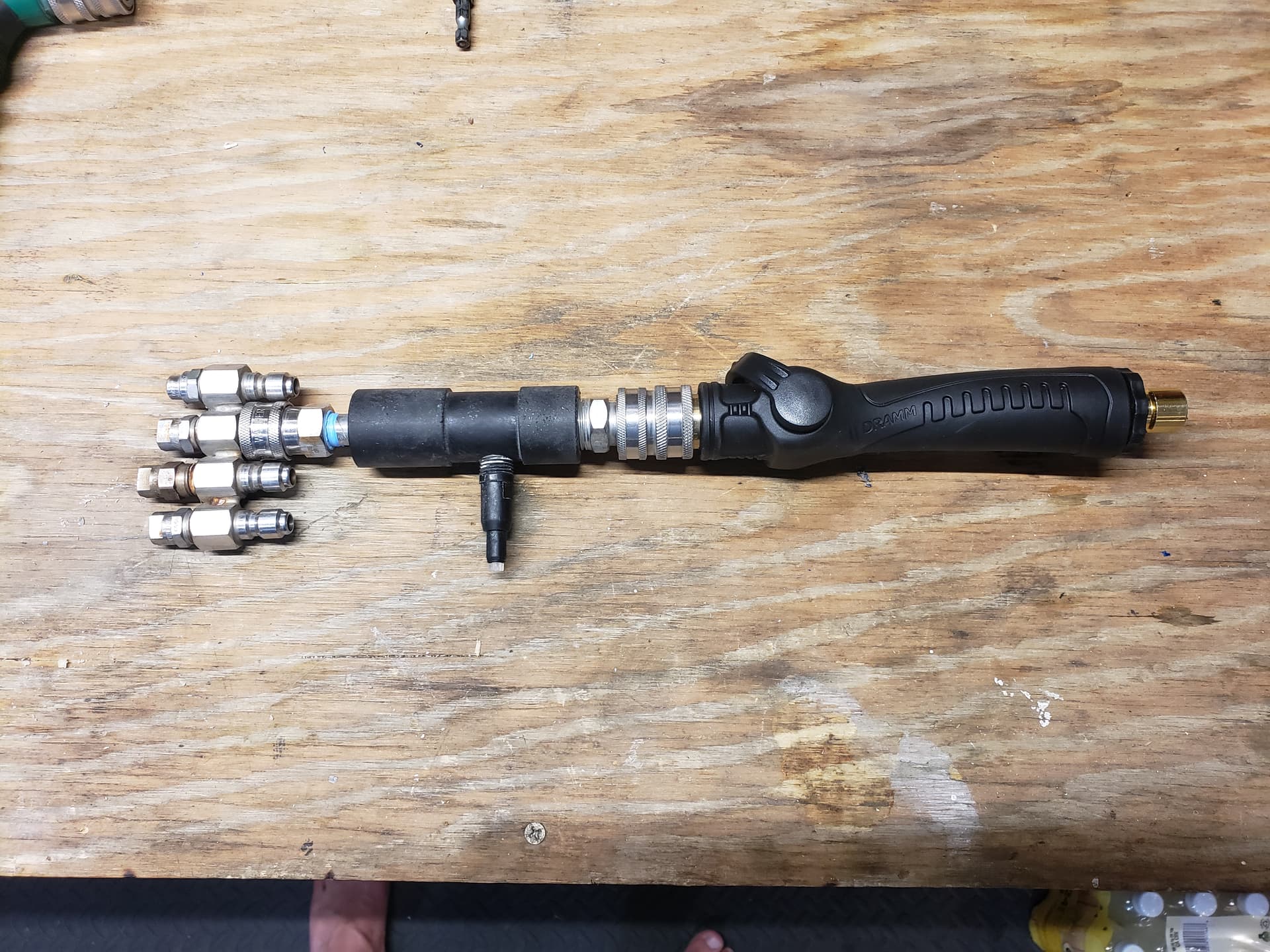

I appreciate the suggestions, really just trying to find a gun with a protected trigger. @Nickski That Dramm looks promising, can you send me a list of the fittings you used so I can get it to work with a quick connect?
I have an injector between mine and my j-rod. But, you just need a G3/4 to npt adapter, then your quick connect. Might need a reducer or nipple too depending on what fittings you find.
Just like what dallsheep is showing in his pic
