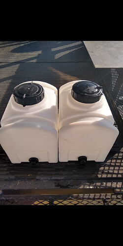

@dcbrock here is one I threw together. It gets a work out and used regular. I use it for transferring chemicals and have a 8 gallon tank I put in the wagon sometimes. Also have a 28 gallon tank I put on a hand dolly if I need it. You want regret building one. The 8 gallon works great with sealer. Also fill the 8 gallon with antifreeze and winterize all my equipment don’t take long at all and works great.
@dcbrock The 8 gallon tank fitts perfect in the wagon. Got it from northern tool. The 28 gallon come from Agri supply.
