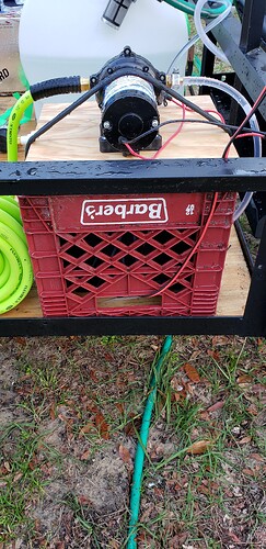

So, I finished my softwash setup this afternoon. I’m using a 5.5 gpm everflo pump, 1/2" flexzilla hose, 50’, and an 18" × 1/2" diy wand I made. I am just using a regular ole Walmart Ever Start battery. I tested all my pw tips, and the one the shot the farthest, was the Pink second story tip I got from Amazon. I tested it a few times, and each time I was hitting the top of my burn barrel. Pretty proud of myself now lol :laughing:

If your not using a reel be sure to not yank on the hose too hard, could rip the fitting out of the pump, at long distance doesn’t take much.

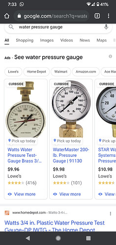

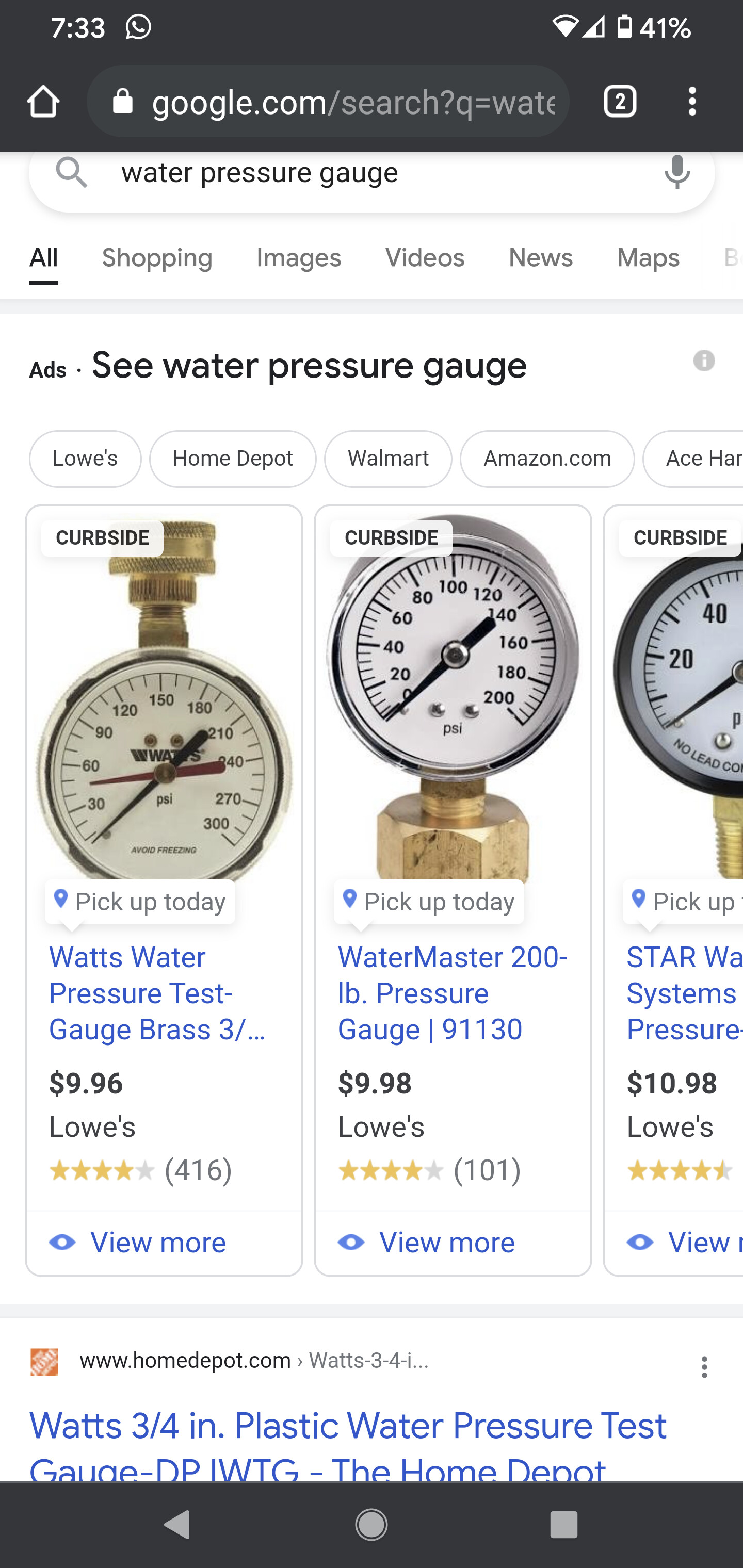

No worries. If you want to try out the Gilmour gun you can go to the store and get a water pressure gauge like pictured below and unscrew the fitting from it and screw a male 1/4" quick connect to it and you’re ready to go.
Thanks, I’ll definitely have to give that a look and figure out how to keep from pulling on the connection. Temporarily, I can tie it off to the side rail. Appreciate you bringing that to my attention.

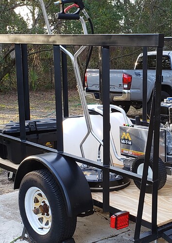

My surface cleaner has its own gun built in and it’s all 3/8 plumbing so no gun is going to connect to that.

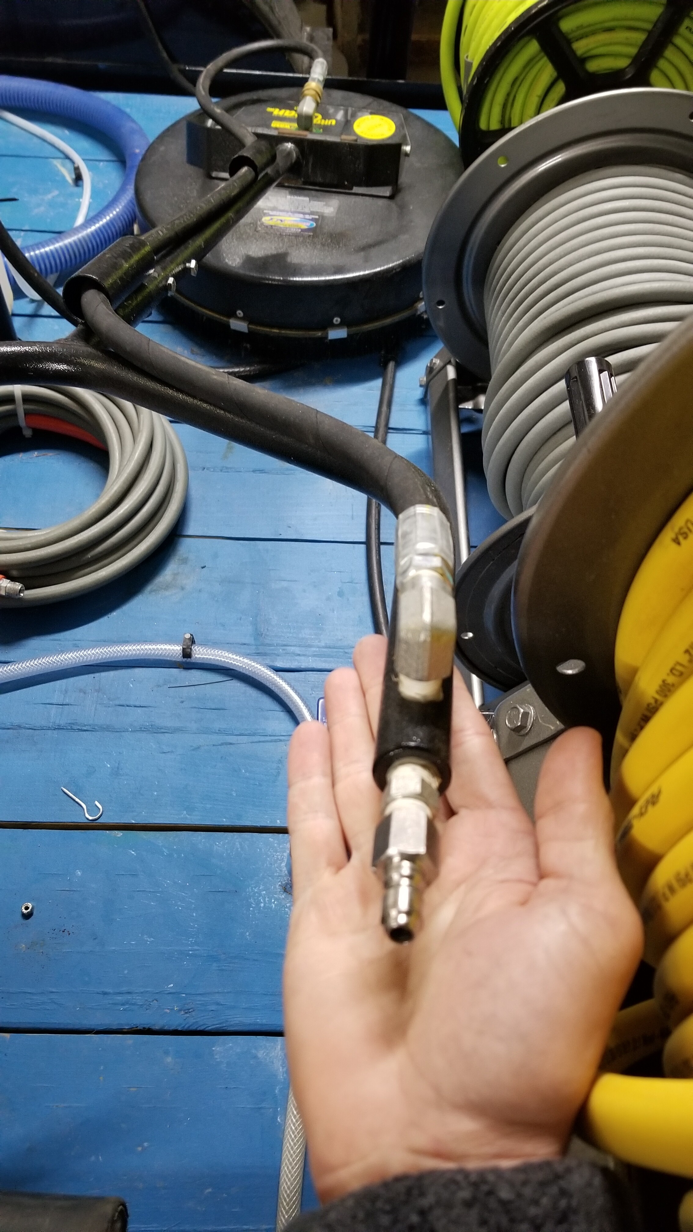

Mine came with its own gun too. I pulled it and replaced it with a male qc fitting
@DisplacedTexan my sc has built in gun also, and it is 3/8 also. Ok, so I am assuming you lead with the female end, starting at the outlet on the pump?

Gun plugs right in
No. Everything is male leading from the outlet of the pump. My ball valve just has females on both ends like @Racer has his set up. I find it works great that way
This is how mine looks
Agreed, all male leading hoses. Where they use a ball valve with females on both sides, I use a gun with females on both sides. Skips a step, I don’t have to turn off a valve to pop my gun off and hook up to a SC. I just keep the gun
