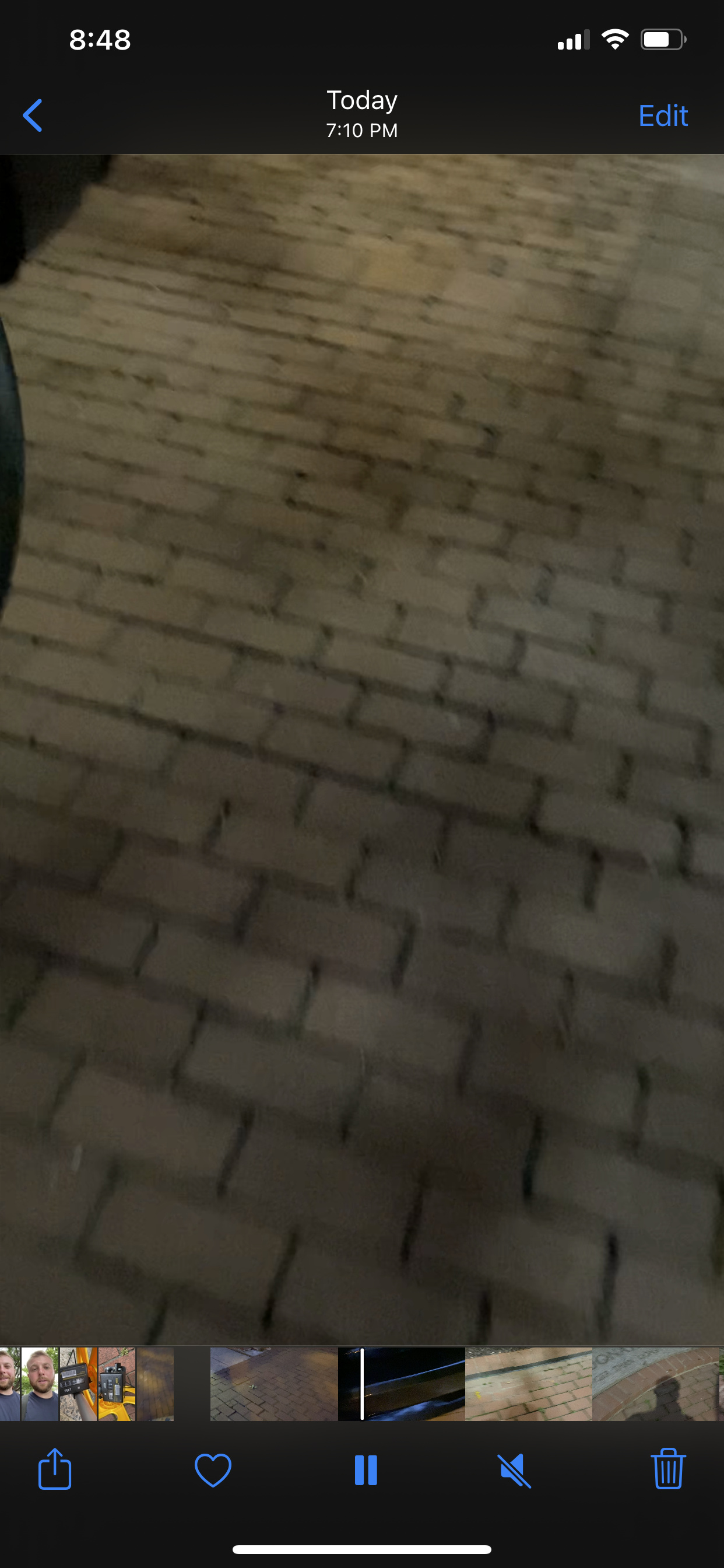

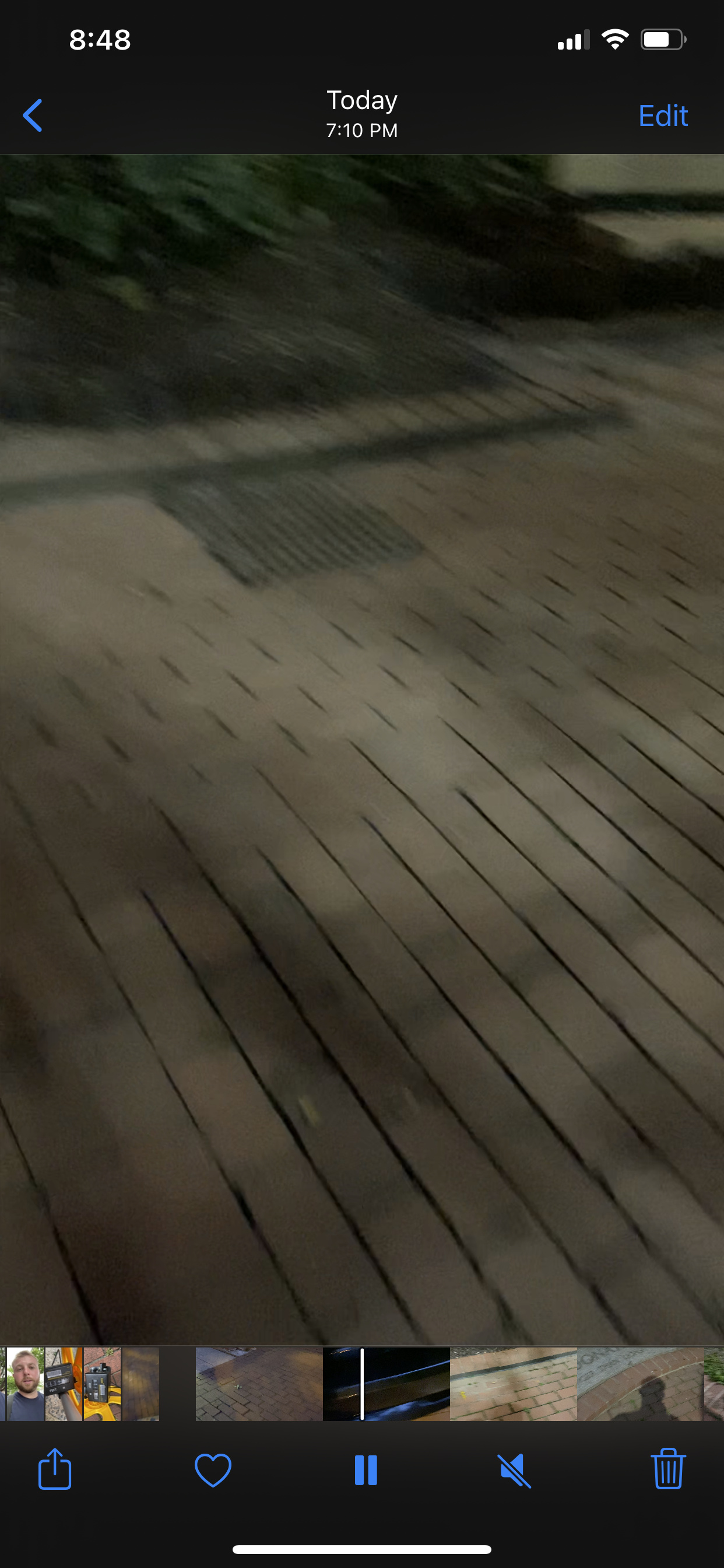

Hey guys. I’m new to the business and to the thread. I come here often to do research. I have my first estimate and it’s a fairly big brick sidewalk job. It covers 11,200 sq feet. It’s not too dirty but they want it cleaned. Can somebody give me help with pricing. I don’t want to over shoot it and miss out or go under and hurt myself. I’m thinking .17 cents a sq foot bringing it just under 1900. Please any help is greatly appreciated. Thank you!!

No sand. I will ad pictures at the end
There are weeds growing in between the brick.

Lol were you running when you took those pics??? :joy:
Hahaha I use to be a UPS driver. Running is my walk hahaha. I didn’t take any picture and just snapped them from my video.

Damn bud, you snap those photos with a toaster?

You may be a little high, but it looks like there’s a fair amount of algae in those cracks, so you’re going to have to pre-treat with a 3-4% mix and then clean. Plus you’ve got that raised edge all around that’s going to take a little extra time. Also how’s it drain, how far you have to chase the dirty water, water supply, etc all come into play. You may be cheap at your price depending on variables. No need messing with it unless you make some decent money.
Hahaha I didn’t take any pictures. It’s a screen shot from a video lol
I saw the video on the FB page. It looks like the joint sand has washed out and has allowed weeds to grow in the cracks. Areas such as 3:05 of your video. It may be a smart idea for them to resend it after you’ve washed as it would help prevent ingress of water in the joints which would weaken the paved area, which in turn could cause failure in the pad.
