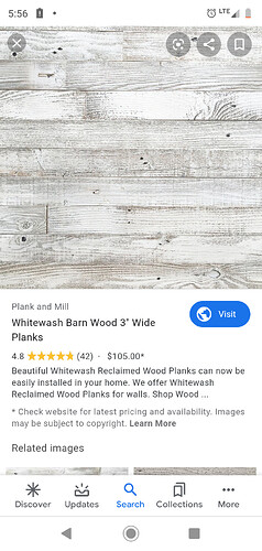

Customer just sent this and said she is going to do a white wash. If this makes any difference.

This is what they plan on doing so I’m thinking I can just hit it with some sh and let it ride. Do you think I still should neutralize the wood?
That will probably look very ugly when they are done lol.
Ya i would still use ox. Putting the ox on is my favorite part anyways. It makes the wood look so nice. How much are you planning on charging to clean it.

That’s a good place to start. Sodium hypochlorite can bleach out the wood so you don’t see as much difference following with ox. A lot of this stuff still goes back to what type of stain they are going to use. Ox is not going to hurt the wood, it will also
remove iron oxide stains from nails or other fasteners.
