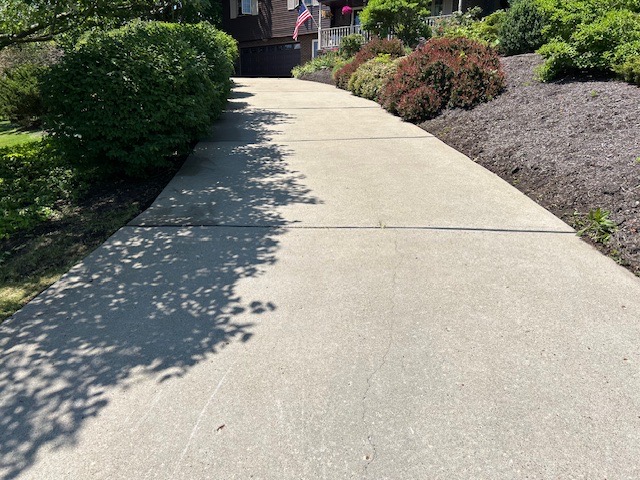

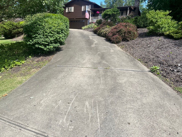

I’ll agree, the first picture, yes not etching. However, the other cases, on my street, are confusing me. I posted that second picture on a facebook group and everyone agreed it was etching. Pressure gauge right before the surface cleaner.

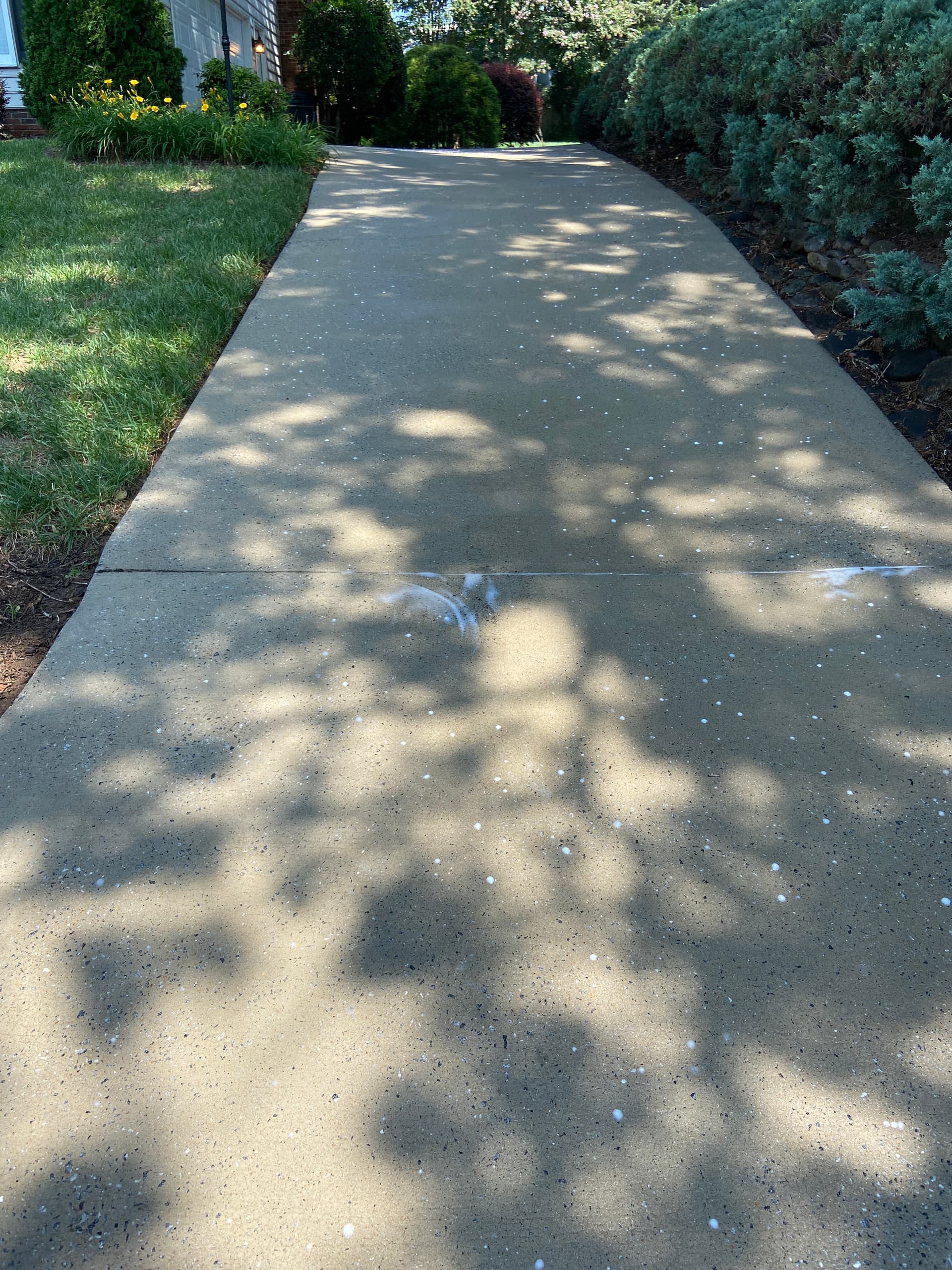

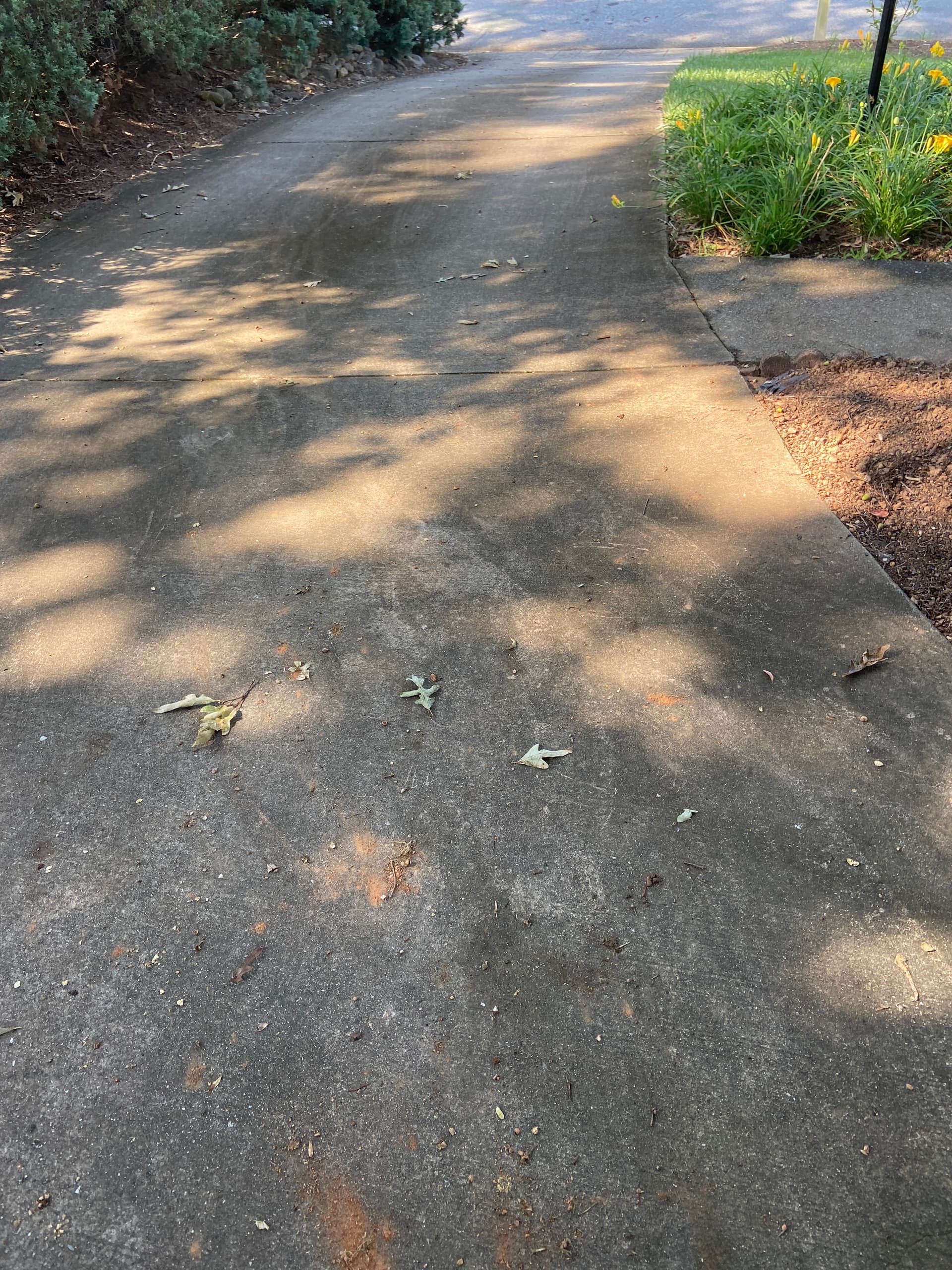

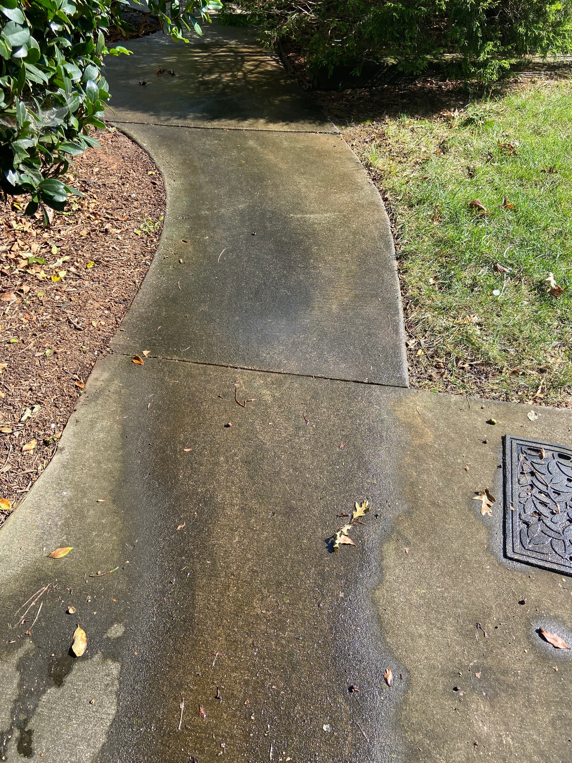

These are pictures of what I did today. Switched back to 25025 tips. 1% pre treat. Went slow. Only one pass. No lines to be see. Then, I post treated with 3% and lines showed up? What the hell. So I rinsed all the SH, and the lines either completely went away or faded in most places. And this gave me the idea, is me post treating making my lines show up like this? That makes no sense. The before/after picture shows the post treat on the concrete (line appeared) and what it looked like after I rinsed the post treat (line disappeared). Any insight would be appreciated.

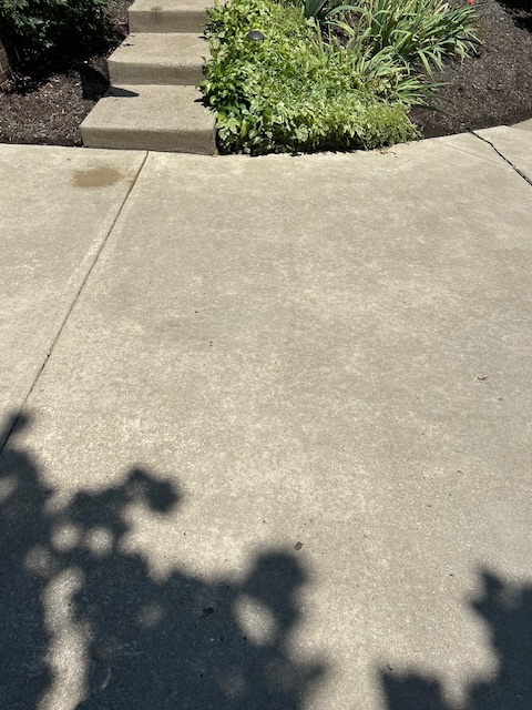

Next time, show us a before, so we can see what you’re dealing with. The ones you’re cleaning don’t look like they were terribly dirty.

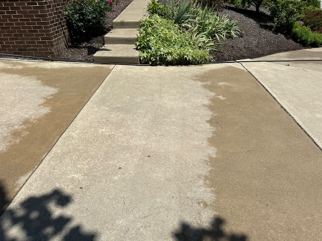

This the crap I deal with regularly - hw pre-treat, 2 passes - hw post treat - Sometimes if really dirty, like below, I’ll hit driveway with hw pre-treat when I first get there, let it sit while I do house, and then hit it again right before I wash it.
Maybe I should’ve been more specific. Why did the post treatment, as pictured, make lines appear that weren’t previously there. Then, why after it was washed away, did it nearly go back to normal? This is what I was asking.

This one was decently dirty but came out good

Rinsing it did have an effect. It made the lines that had appeared when I applied the post treat disappear. Thats what this is about–my post treat making lines appear when the concrete was spotless before hand. That’s what I’m asking you. Why is SH making lines randomly appear?
learn to do random patterns will make everything look even . you are not mowing a yard. I uses a sweeping type pattern side to side . No strips or lines can be seen. Then rinse with a fan tip off my j=rod . Works like a charm.
We weren’t there, so we don’t know exactly what you did or the time frame. Anytime you re-wet the concrete right after you’ve cleaned it, with anything, you’re going to see the lines for awhile. You’re not making any sense. If you post treated and you saw them, how long did you wait till you rinsed it? Was it totally dry for 30 min or what? It’s good now, so quit worrying about it. Now you know you don’t need to use 3% most the time if you clean it thoroughly. You’ll learn. Every job is different. Once you clean a few hundred, you’ll get a feel for it.
