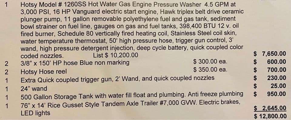

I went down the pressure washer porn rabbit hole the last two weeks. I’ve searched out all the online players. Sadly, there is next to nothing in stock when I call. I found an in stock 5.5gpm cold, and no hots. Told two months on Hydros. I was hoping to get some jobs in for family and friends before winter (and get the photos) and then build out the trailer and website.
Went to a local dealer and got sticker shock on their hots and colds and then checked out FB. I was taken back by the used trailers for sale. Exact same units I was quoted $16k at the local dealership. This Hotsy one was for sale for 12k with 3.5 hours on it! Another one three hours a way had 30 hours for 10k and was bought for 15k. One thing I was hesitant on was the low gpms for the price. Quite a lot more trailers in a 500 hour radius.
Any advice on buying used? Things or brands to watch out for? Kind of surprised at the number of Hotsys since I thought they had a good reputation.
Thanks for all your help.
Landa ,Hotsy, hydro tek, hydro max are all good well built hot machines, get new if you can afford it and get it soon ,there’s a 20% increase on the horizon on all machines. Also pressure pro ain’t half bad on hot skids. Cold pressure pro skids suck imo. And if that’s a rice trailer your looking at your not far from me lol.
A lot of guys come in to this business and think a nice rig is all you need to make money. Low hours means they did not do anything to grow the business and likely gave up. Test out the used stuff and if it fits your needs buy it.
