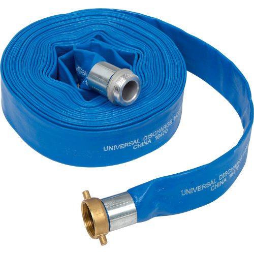

OK Pal’s I have a new question… On this 8gpm unit I’m getting I’m putting a 300 gallon tank on it…
I pull up to a house empty tank… SO I read how fast 8gpm will take a tank empty… I was thinking of getting a bigger hose…
I got 3/4… I have seen a 1" even a 1 1/2"…
Experts what is the way of thinking on this, I now have 200tank 3/4" hose 4gpm 3500 takes a bit to run it down

just asking do I need can I get a bigger hose to fill up my 300gallon tank.
Do anybody use a bigger hose to put water in a big tank.

You’re restricted to how much water the spigot puts out. I’m pretty sure (someone will correct me if I’m wrong) that a 3/4" house is sufficient to handle what a home spigot can pump to your tank. Going larger won’t help I don’t believe.
Emptying your 300gl tank is easy math 300/8=37.5 minutes to empty. This is on trigger time (no letting off) and doesn’t account for the water entering the tank.
So if you were pumping in 5 gallons a minute into the tank and your machine is pumping out 8gpm, then in reality you’re only using 3 gallons a minute in which case, you’d have a solid 60 minutes of trigger time in that scenario.
your right spigot size is what it is not putting more out…faster fill up?
3/4 is faster then 5/8 size… 1" faster fill up than 3/4?
thanks for your input/thinking on this. I just stay with the 3/4

No it’s not legal. I use hydrants everyday and pay for meters, water fees and install fees. 5/8 hose is all i use. 3/4 takes up top much space on the reel. 300 gallons is over a ton of water to be hauling around. I run 2 eight gpm machines on 125 gallon tanks. Big risk hauling water.

I have one truck with 2 8 gpm machines. You don’t need a big tank if you have good water flow. I woek of off hydrants mainly but even with houses it’s ok. Just hook up to two spigots.
I think maybe this is what you’re missing:
Keep the water supply turned on, and the float valve will shut the flow off when the tank gets full. That way you don’t have to keep stopping what you’re doing to refill the tank.
