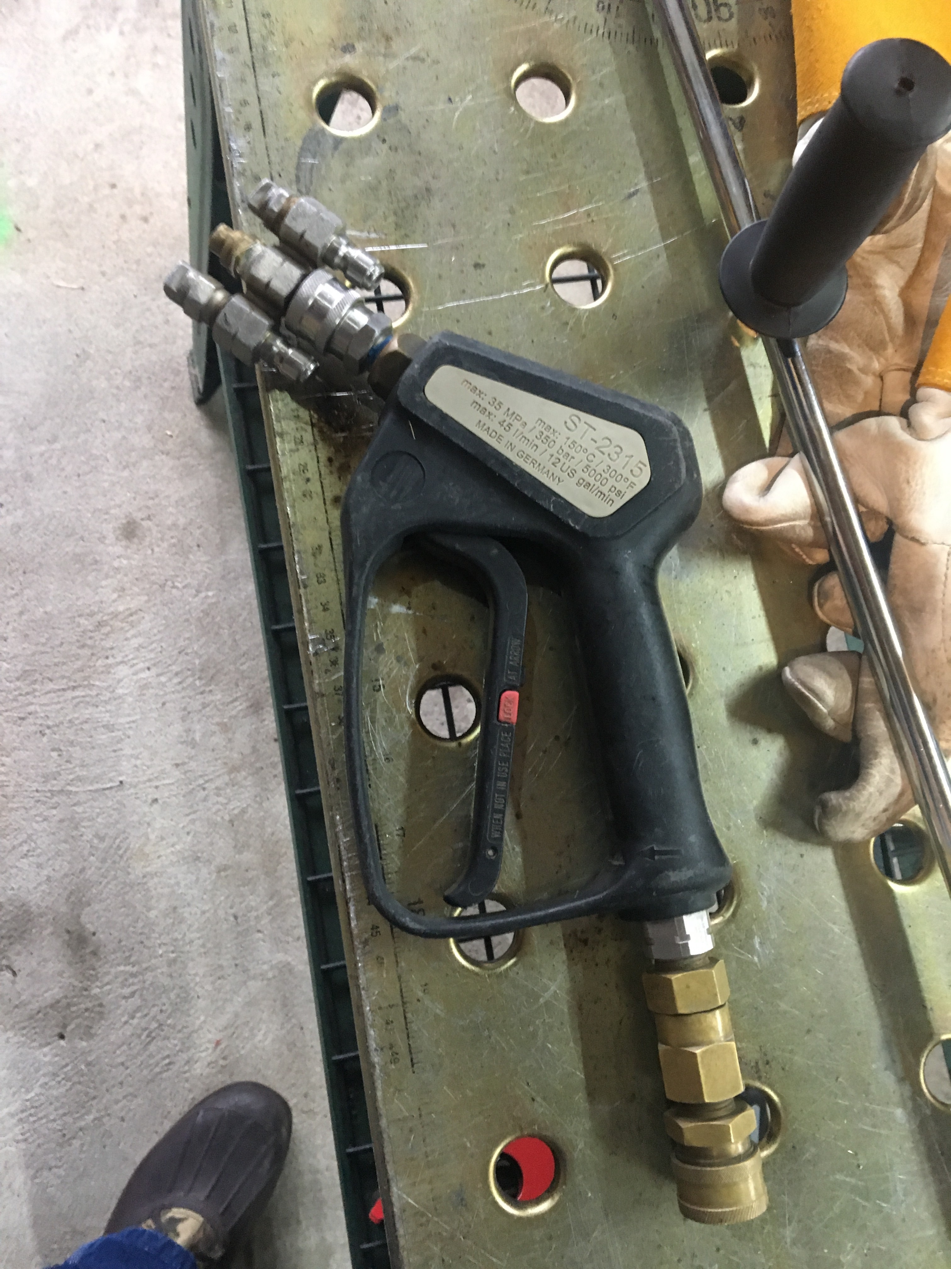

@trevord 99% of the time the short gun is what I use and have no problem hitting peaks 40’ in the air. This long wand will quick connect to the short gun in about 2 days. Just ordered parts, but worse case scenario I’d have two guns.
That nozzle looks like it had had NC water flowing thru it
Is that what you call the j rod tip
Kinda. Jarrods had 4 nozzles
It’s called the Spam & Cheerwine Tidewater Tosser. I’m kidding. @Innocentbystander sent this to me a year ago? Or less?
Honestly, I’ve never had a clue what jrod honestly even meant. I just know pressuretek sells ganged nozzle holders and you can buy 0040 and 0050 and 4040 and 4050 you can use those to soap and hit peaks and put them in the connected nozzle holder. There’s a 45 degree pressure tip In the other ganged nozzles, but the last one I just leave empty. This one Will sent me with only 3 and that’s how I run the others.
Thanks guys im looking into it now… my only problem now is i have two different units one is 4gpm and the other is 5.6 i guess ill choose which ever one i use the most
Doesn’t matter. They’ll both work in those machines. Go with the 0040 and 4040 though. Lowe’s even sells a “second story” kit with a pink nozzle in it. People joke about it, but I carried that pink nozzle in my pocket for two years. It worked.
The ganged nozzle holders are a lot easier to use than digging in your pockets for sure.
Mine are 40 degree. Not 45z
Thanks squid
Make or buy or bunch of them. There are at least a half dozen on each truck. They get lost, walk off, go thru my guys washing machines(don’t laugh, a wife wanted me to buy her another washer). Make up a couple for each machine. Like Brodie said, one nozzle size will probably work for both machines. Jrod was named after a cat named Jarrod Gumboldt that pitched the idea to Bob at pressuretek.
Thanks Will! If it wasn’t for your Spam & Cheerwine Tidewater Tosser we’d still be carrying pink nozzles
What 3 nozzles do you carry? @squidskc
@Innocentbystander ?
I’ve got 8/3500 machine, have the jrod 0060, 0550, 1550, 2550
0050, 2540, 4030. Or something like that. I don’t use nozzles to stop soap. 2 low pressure tips and a gum popper
That’s so many soap nozzles. LOL all you need is one high reach soap nozzle, one fan soap nozzle, and one 40° pressure tip that brings your psi anywhere from 2500 or 3000. That’s my less than scientific math and innocent bystander fully influenced answer.
Thanks for the quick responses guys
I’ve used the same Jrod for both 4 gpm and 5.5 gpm with no difference in height.
