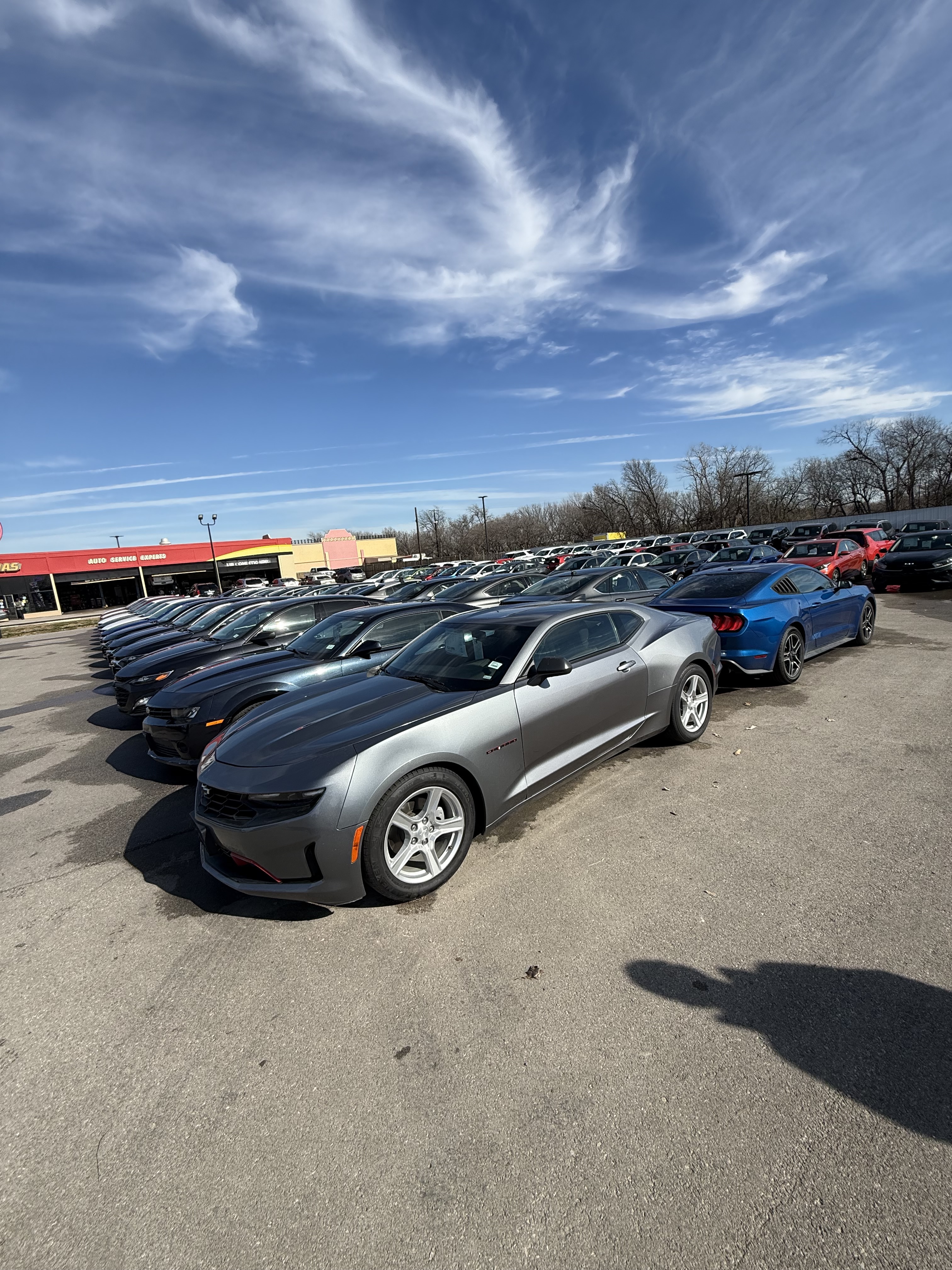

Follow up - we have cleaned 1000+ cars this week. It took us around 16hr for each round of 500. Cars look good, few outliers get touched up on the final walk around as we count the cars for the invoice.
Congrats, amigo! Did you have any issues you weren’t anticipating?
Honestly, not many surprises. The car squeegee was a game-changer. At first I was definitely scratching my head trying to only use the smaller microfibers.
Other than that, biggest challenge is maneuvering around the cars. When they’re parked back-to-back in rows it’s hard to get through the backs, then if you keep spraying nearby it will mess up the guy drying.
But what we did is just run our hose up the middle of the row, then spray away from the backs to the fronts to avoid overspray on the dry cars.
We were worried at first the cars would look terrible but they honestly look good
