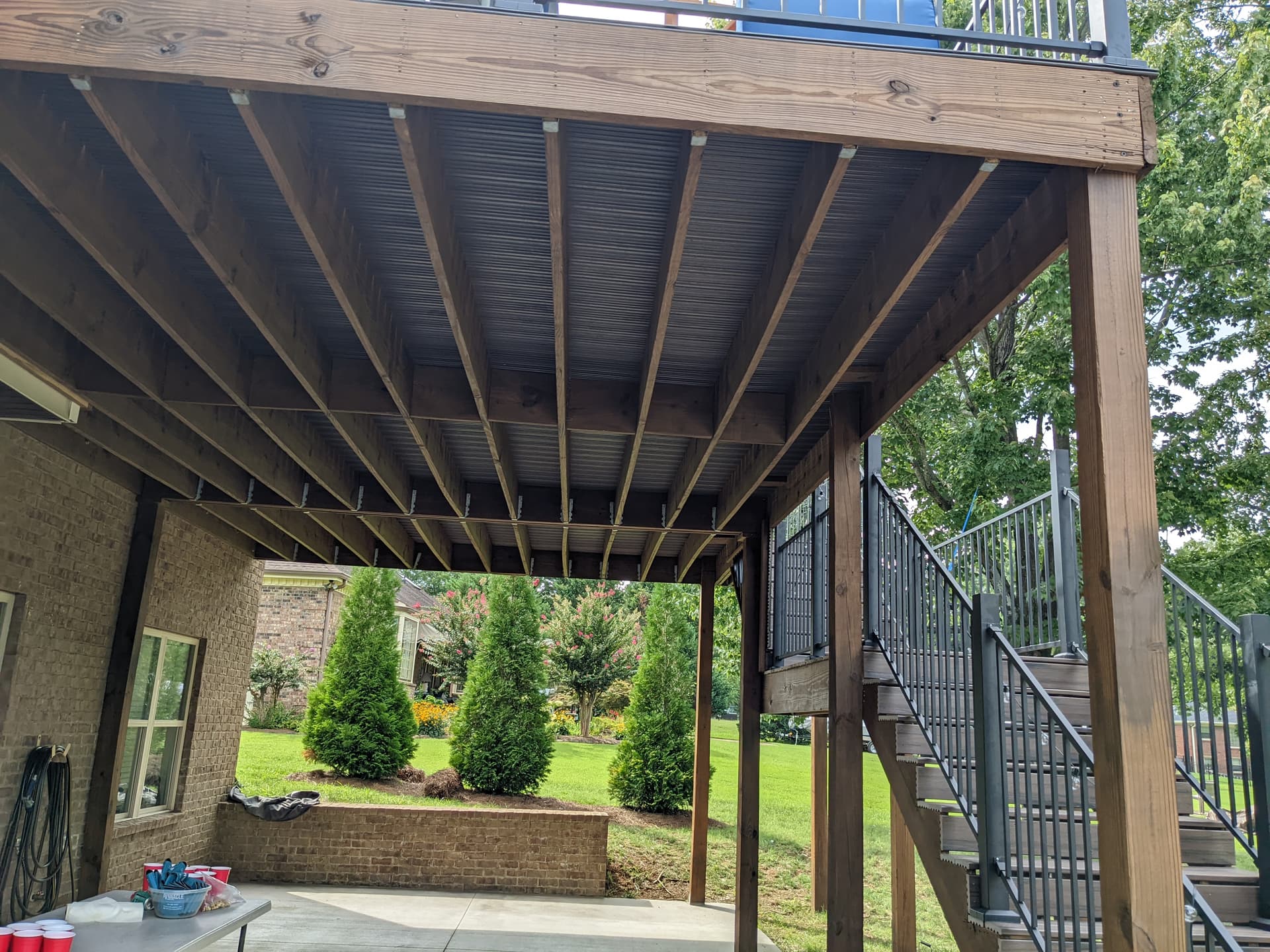

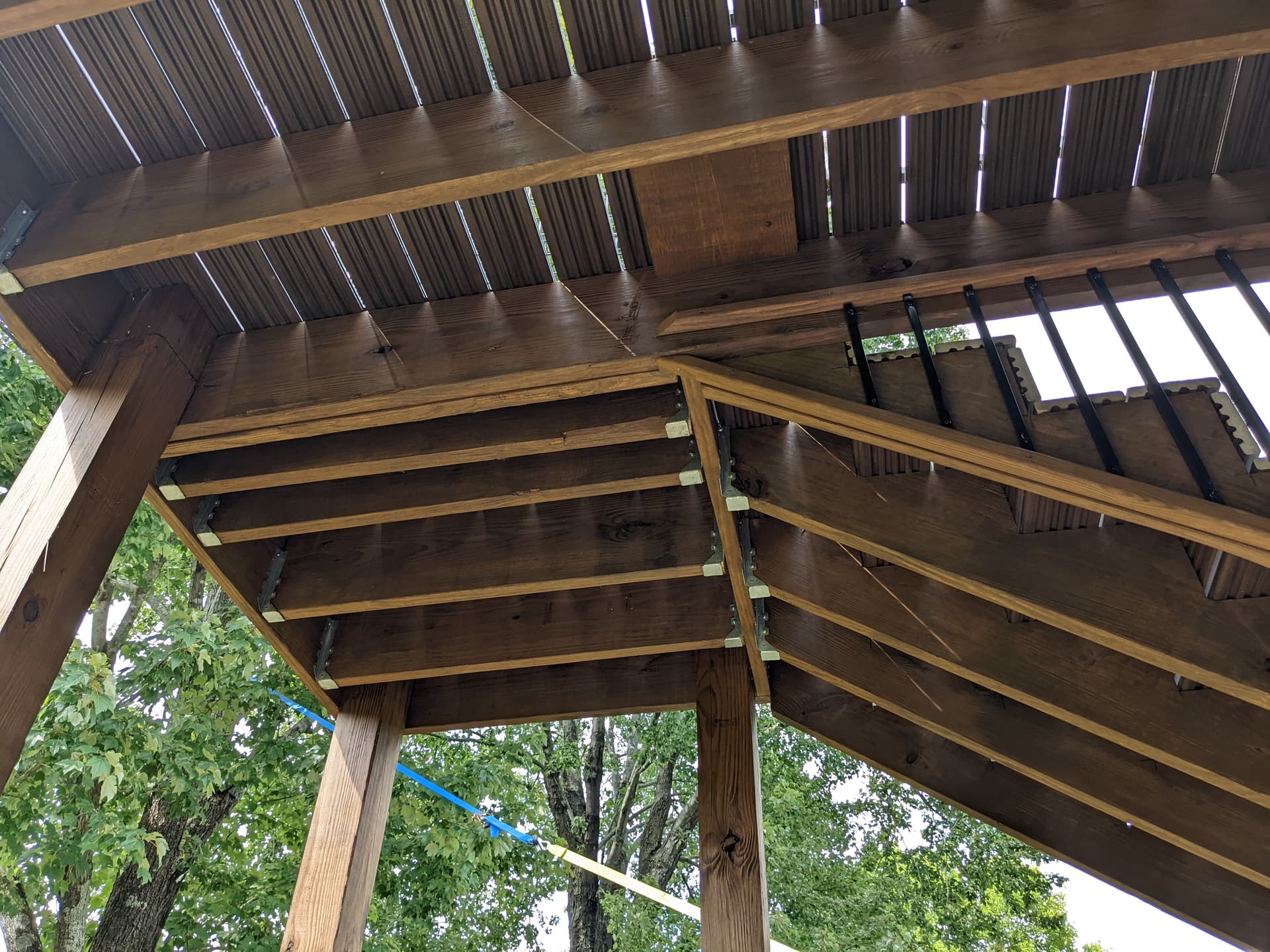

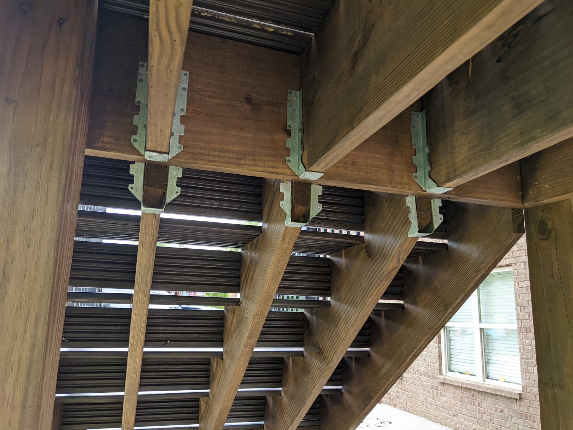

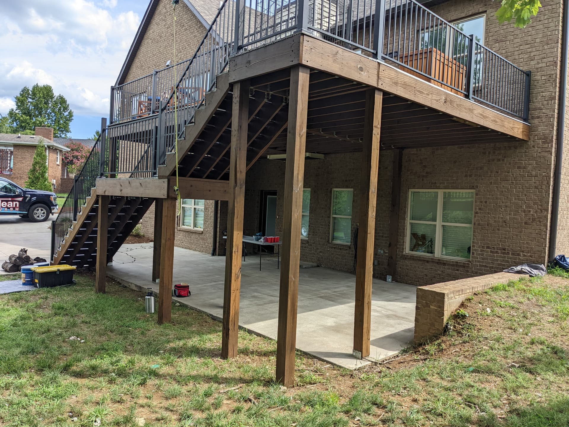

Almost forgot to send y’all final pics! I used scaffolding, a 4" china brush and a short bendy 2" china brush for crevices. The 2.5" natural Purdy would be a great cut in for regular staining but in this job was my least favorite because it was too long to get in small places and too small to do what the 4" could do. I ordered a lamb mitt and it worked for one particular area where only my arm could fit but I hated the amount of lint produced. (Forgot to prewash it, my bad) all in all it was a HUGE pain in the ■■■ but I’m hoping less ridiculous stain jobs come in the future from the photos. (I so wish I could have sprayed but I didn’t want stain all over the composite top boards and thus I brushed the whole thing) This is my first year in business full time in this area so I’ve had plenty of spare time to complete this project. Took about 1 full week of man-hours stretched across 3 weeks. And made a laughable $15/hr after supplies n gas. Not the worst money I ever made!
He was really happy with how it turned out and wanted to pay more but I told him it wasn’t his fault it took longer than I anticipated. Stuck to the original quote.
I’m not a $99 guy messing with the market but as I’m learning new things I find a much greater value in the lesson learned than the first few bucks. Next customer is gonna pay $$ and I’m spraying plus hiring a helper to get it done in one morning alone!
