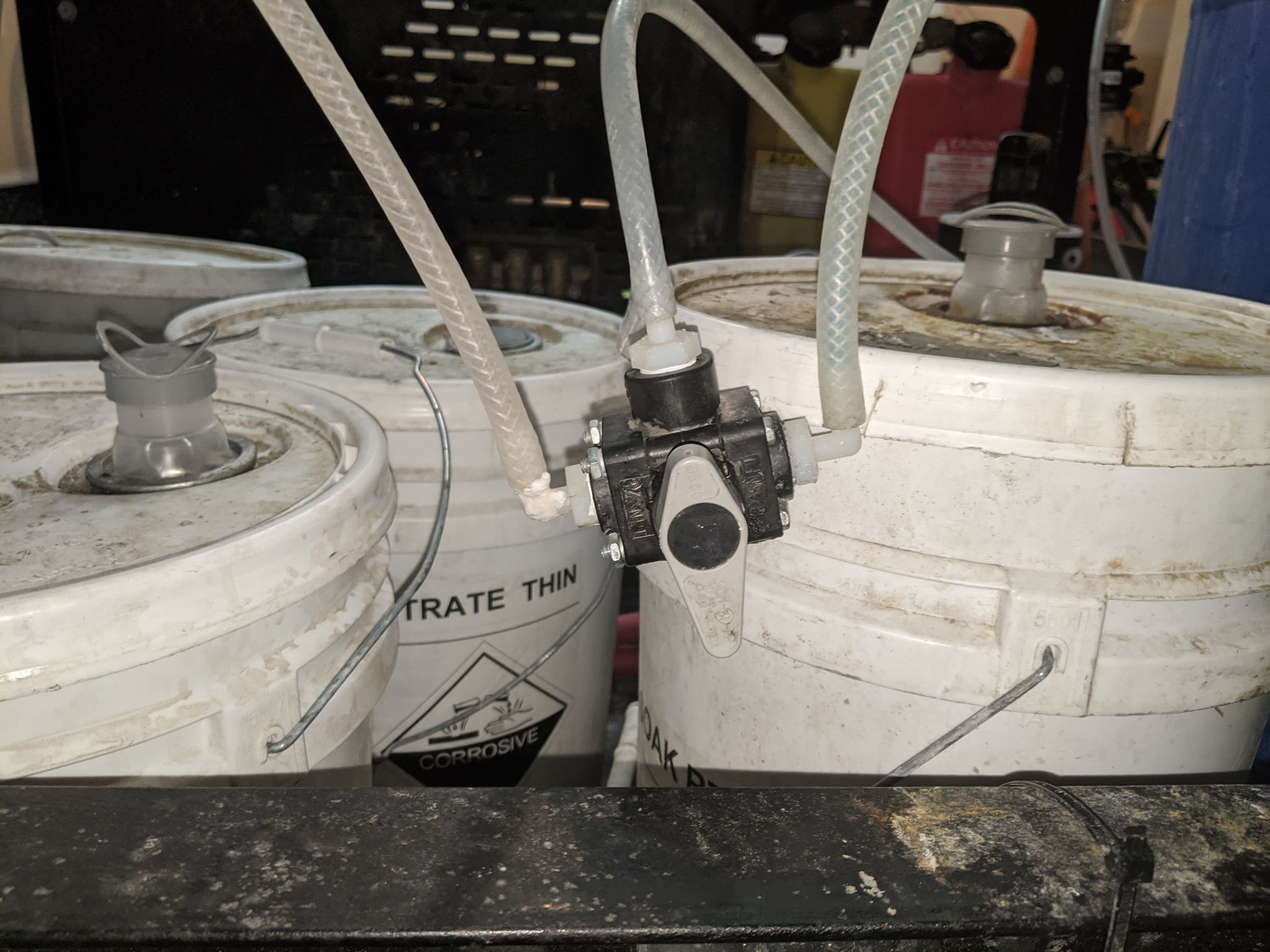

You’ll have the 1/4" line from your DS injector and that should go to a 3 way ball valve.
https://www.amazon.com/gp/product/B00QB1GU88/ref=ppx_yo_dt_b_asin_title_o05_s00?ie=UTF8&psc=1
From that valve it’ll go to your acid/soap.

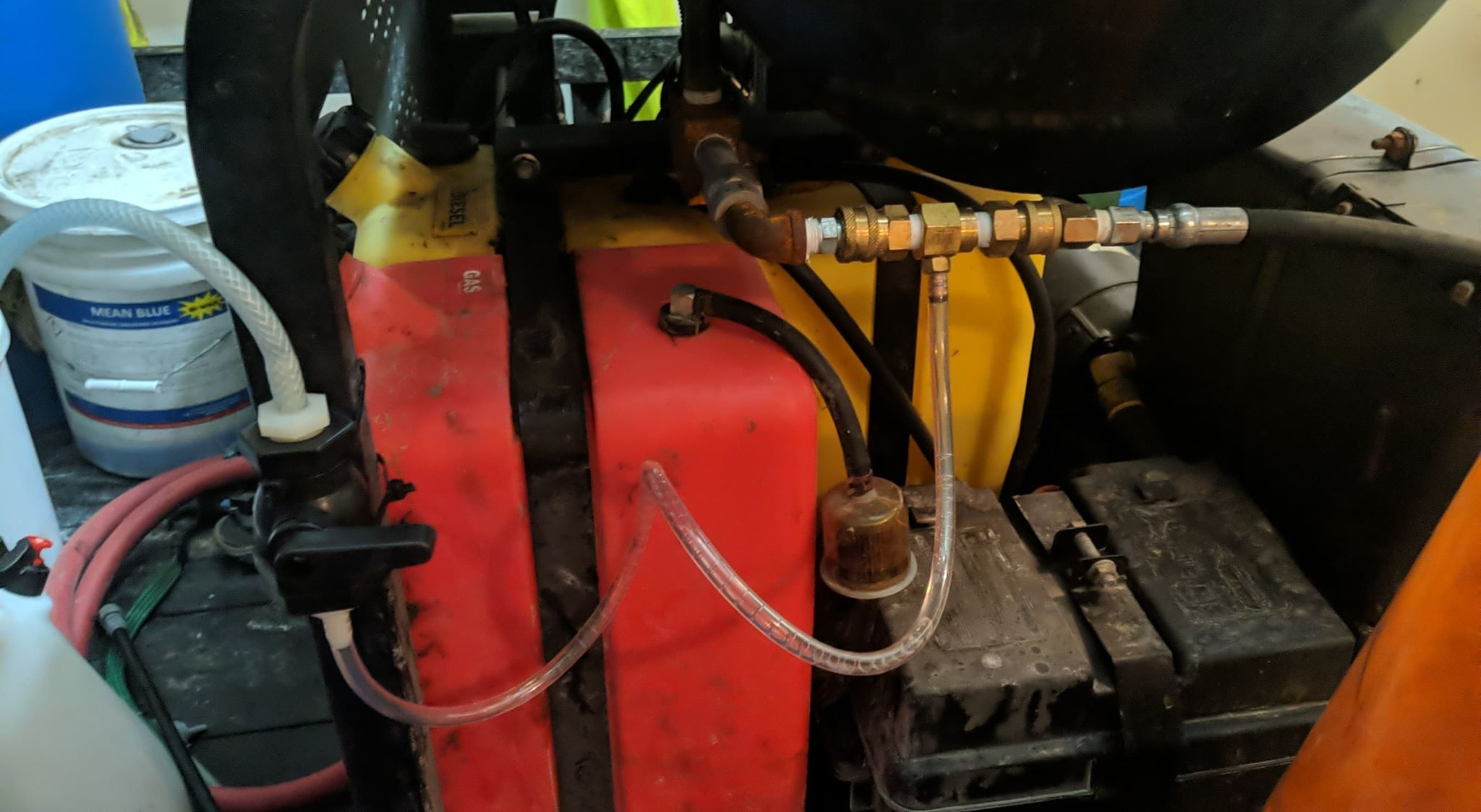

I use this to shut off my injector from pulling soaps:
I don’t trust that clear vinyl to not collapse under the smallest vacuum
Or the summer heat, ask me why I know this…
It was all they had at Tractor Supply as a last minute pickup. Said it was good for acids and up to 70psi if I remember correctly. I still have about 10 more feet left if I need to use it.
I got it so I can have a shutoff valve for my DS Injector.
You should be alright in the colder months, I had it collapse and kink on me on 100 degree days.
I did the same exact thing 2 years ago, ran out of the braided and went to local TSC.

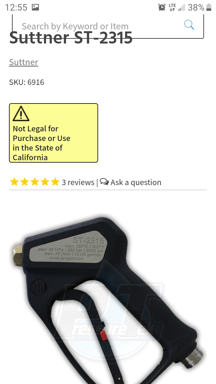

What guns do you like @dperez ? You’ve been doing this longer than both of us put together.
What do you use? Just WD-40?
ST-1500’s but the ST-2315’s are great for your acid
I bought the 2605 because it was supposed to be for acids and it was an easy pull. Now I cannot find where I saw that so I can’t back it up
