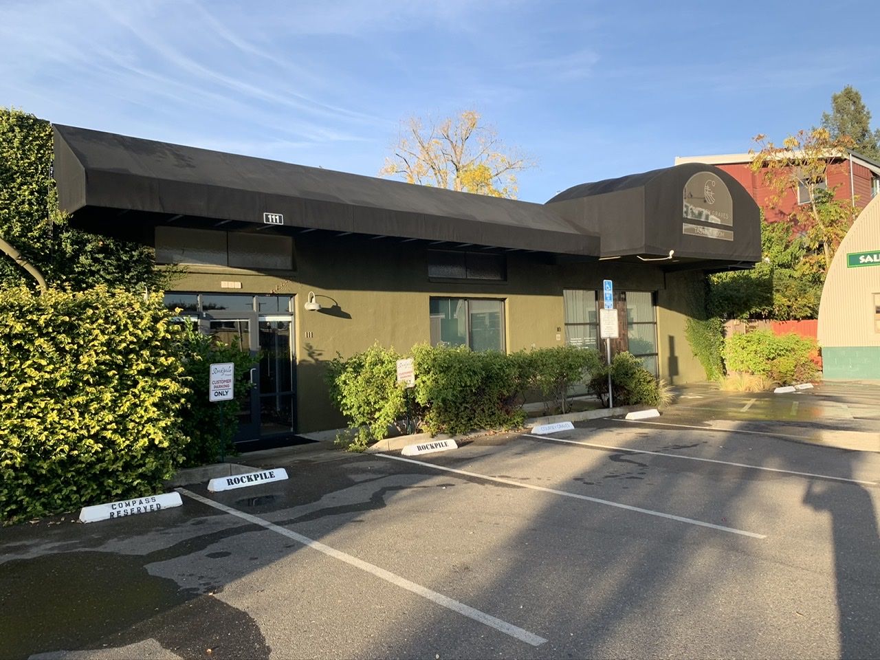

So took all of your advice. Went back today with my new my4sons battery sprayer and treated 50/50. Agitated and it came way better. Took the bucket truck so just rinsed with the hose and the scrub mit while rinsing. Got another roof job today (#2) and ordered most of the maverick system from Cody at Powerwash.com I needed to get something right away as the customer needs it done early next week. Got a 7gpm 12v pump, 200’ of the 1/2” orange ag hose, poly ja gun, lance and fittings! Looking forward to using it!

You take any pictures?

Still wet and honestly need to go back again with the new setup next week and a 16 orfice tip to rinse with 1000 psi
