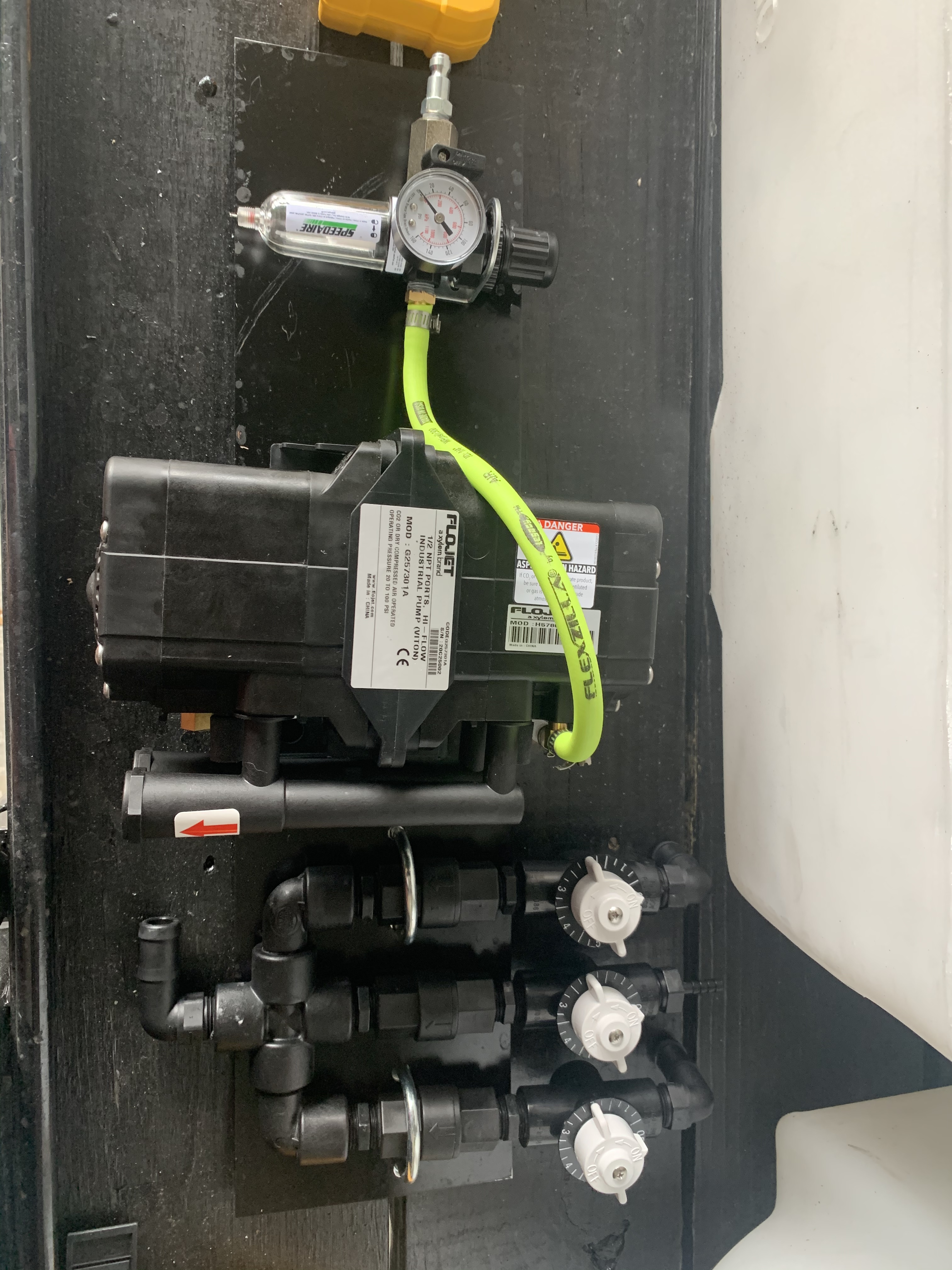

The pump could be stalling. Also have you tried removing the filtration water separator and going straight from the compressor to the pump to further remove any potential issues?

I haven’t, I figured since it a new filter regulator, and it doesn’t lose pressure when sitting idle, that there isn’t a problem on the air side. Do you think it’s something I should try?

I would try air compressor to pump and supply. Reduce variables. If the pump is still having issues and the compressor is not stuttering I’d suspect the pump. Check hoses to ensure they’re not collapsing or leaking air.
What size is the flowjet, 3/8, 1/2?
1/2 inch inlet and outlet.

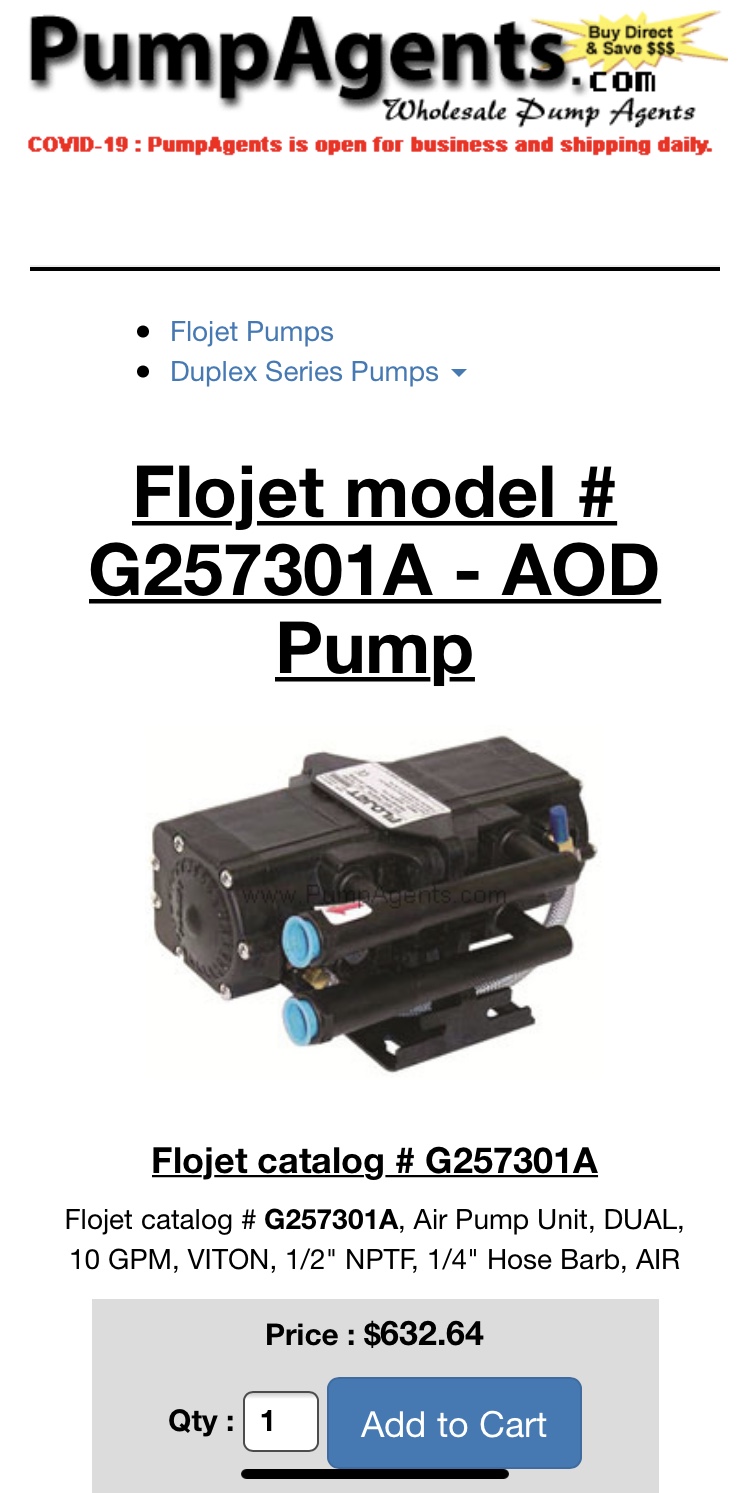

This is the pump I have.

I’m scared to ask but you didn’t pay $632 for that did you?
Close to it, yea :-1:
Not sure where you’re located but Kleen-rite has good prices on certain things. $234 10GPM FloJet Pump
I’m in Melbourne Fl. I actually ordered this through this other guy here in Florida that selling these as “kits”
So basically you get a Filter/regulator, 10gpm pump, and proportioner mounted on a steel plate. It seemed like a great thing at the time, and still does as long as I can get it to work. Being a newbie at this I figured that was an easy option to have it come “completed” for me.
That makes sense. Hopefully you get it figured out. Trouble shooting 101: remove all but the minimum required to function. If that fixes the issue start added pieces back in until you find whats restricting the flow.
