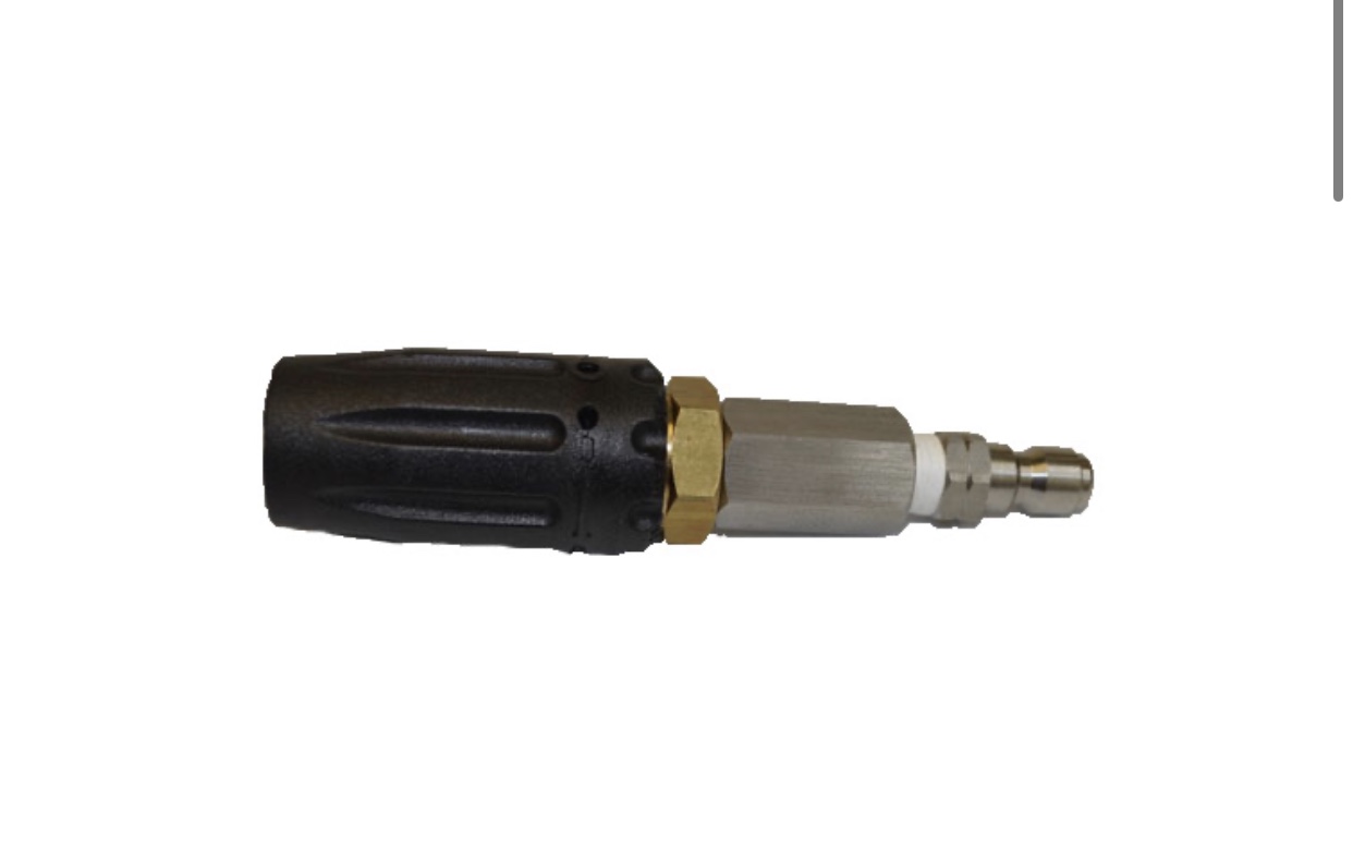

@Patriotspwashing If you rinse a house with your x-jet does it pull soap?
@Patriotspwashing Im down streaming with a j rod but looking for a better rinse nozzle without running back to the trailer
@JohnH
I believe @Racer uses this x jet to soap and rinse and he uses a remote ball valve on his injector bypass to turn soap on and off and just twists the nozzle to change height and spray pattern. Time saver and efficient.
Thank you for getting back to me. I have a 4 gpm and also use a remote ball valve i made up witch works great, I think i copped it from someone on this site. I notice a loss in gpm when I switch the ball valve off so i was wondering if there was a good rinse nozzle to not draw soap instead of the ball valve set up. Hoping to keep as much water volume as i can till I set up a new trailer with an 8 gpm over the winter.
You spray more water using a ball valve to switch from soap to water than you do using a high pressure tip to stop soap
Leaving the injector on the hose cuts down on GPM a bit, it’s not the ball valve doing it.
