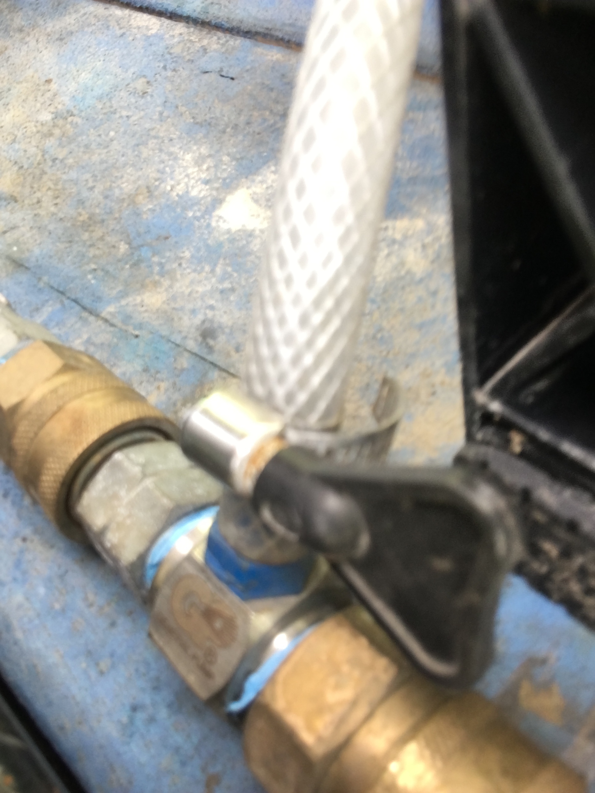

This is the original I installed prior to making the plumbing walkthrough video and showed in that video. I even talked about the knick in the Kevlar piece in that video. I made that video over 6 months ago so I’ve been using it for nearly 8 months with zero issues.

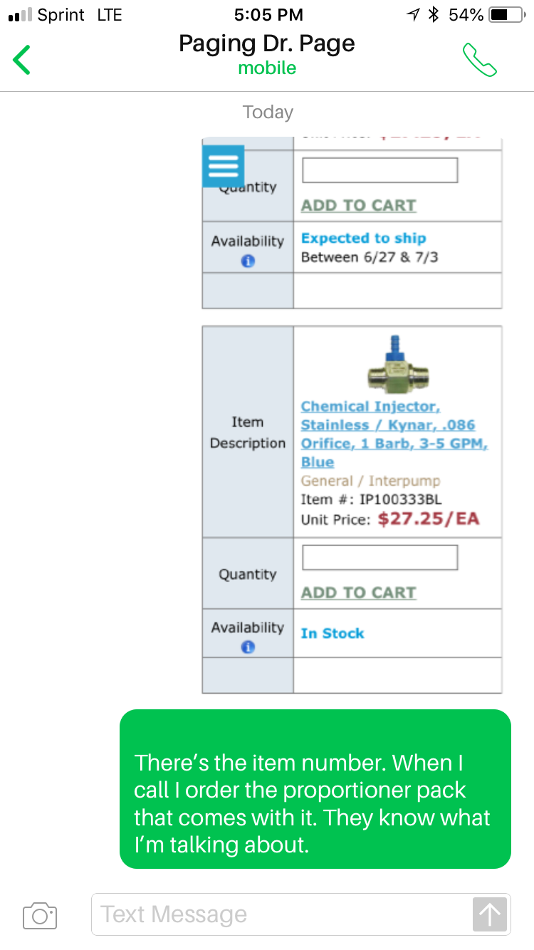

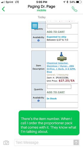

Already sent this to IBS, but here’s the item number.
Cool, thanks for the input. I was about to order some more regular injectors and just stumbled on this thread while researching some other stuff. Will give these a shot.
