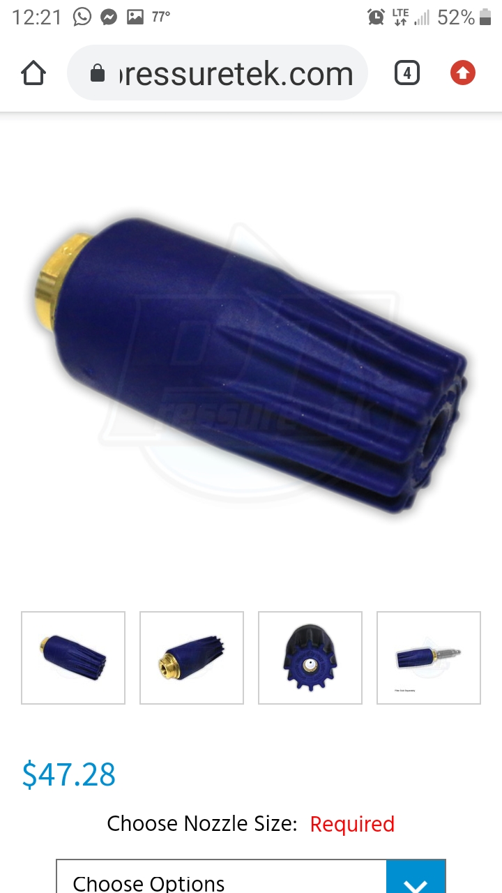

My question about the recommended tubo
I looked at Pressure tek, since I have a roughly 8gpm machine I should order the #8 of this
https://pressuretek.com/pa-ur32-turbo-nozzle-5100-psi/
or should I get a #10 in the suttner. My reasoning is that I don’t want to buy a paint stripping turbo, then a brick and retaining wall turbo too. Maybe I am still being cheap. Looking to the pros for answers, I didn’t read up on this stuff too much (or maybe enough) and I am not looking to waste loot right now (or ever to be honest). My understanding is that this is a rotating zero degree nozzle. I get that I could stand further away from an object to reduce the pressure but jokingly standing 10’ away isn’t good.
Padawan sprayer seeks guidance.
I got the blue ones for my 5.5gpm. red one is an over kill in my opinion even for you but to each there own . @Infinity runs the red one I believe, Both are Awesome turbos ! Way better than the suttners, those PA one’s can start in any position.
And yes sir you want the #8…
You don’t need a wet paint stripper because your particular job doesn’t want all the paint removed, Just the loose stuff. That pa blue/red turbo will serve you well. Up to you but i also buy the $8 filter that doesn’t come with it. But I’d recommend it.
We use #10 w/filters running 2700 psi with 255’ of hose, 8gpm units.

THe #10 suttner sir? no punishing marks on retaining blocks, brick, or cement? I have used a zero degree nozzle (not turbo) to take masonry off bricks before so I am very leary to use too much pressure. The softer bricks got etched, the harder fire brick ones weren’t fased by the zero degree. I did hundreds of them. All the bricks came from an old school house they were tearing down from the early 1900’s. Makes me a nervous nelly with zero degree now.
Ole Coop is telling you to get the #10 to Calm it down, If you get the #8 , which matches your gpm t
will put you at your max ,around 3300 psi ish at the gun. I run the 5.5 because my machines are 5.5 gpm @3500 psi. I want all the psi I can get on my nasty jobs. Those turbos are like a red tip on crack, My help calls um pissed off bumblebees, If you haven’t ran one your in for a treat, A chain saw head shield would come in very handy, We’re to stupid to wear it though. :crazy_face:

I’m too lazy to look in the truck, but not too lazy to look up the ptek invoice. This is the one I bought:
UR25 PA BLUE ROTATING NOZZLE 3650PSI 7.0
