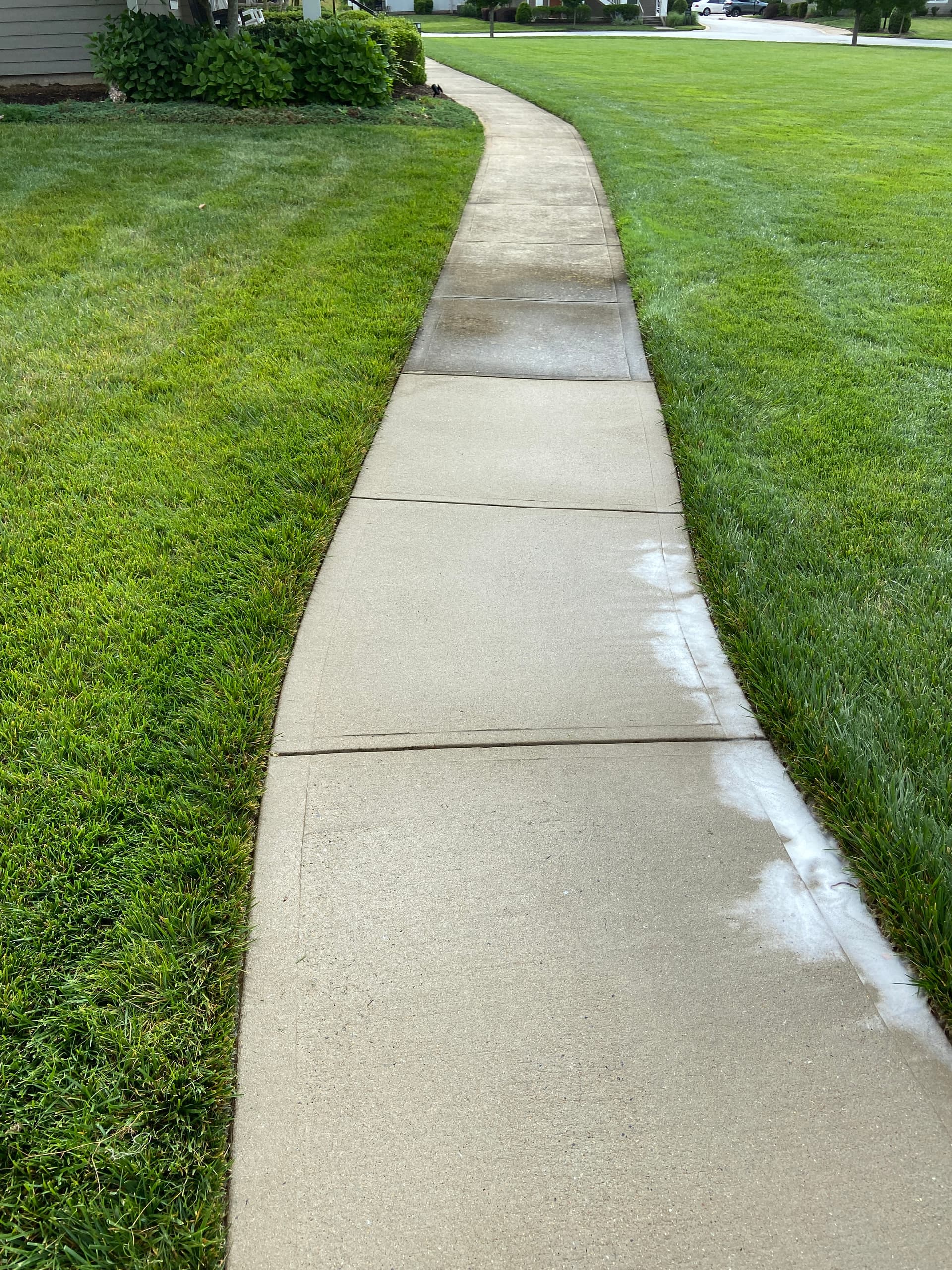

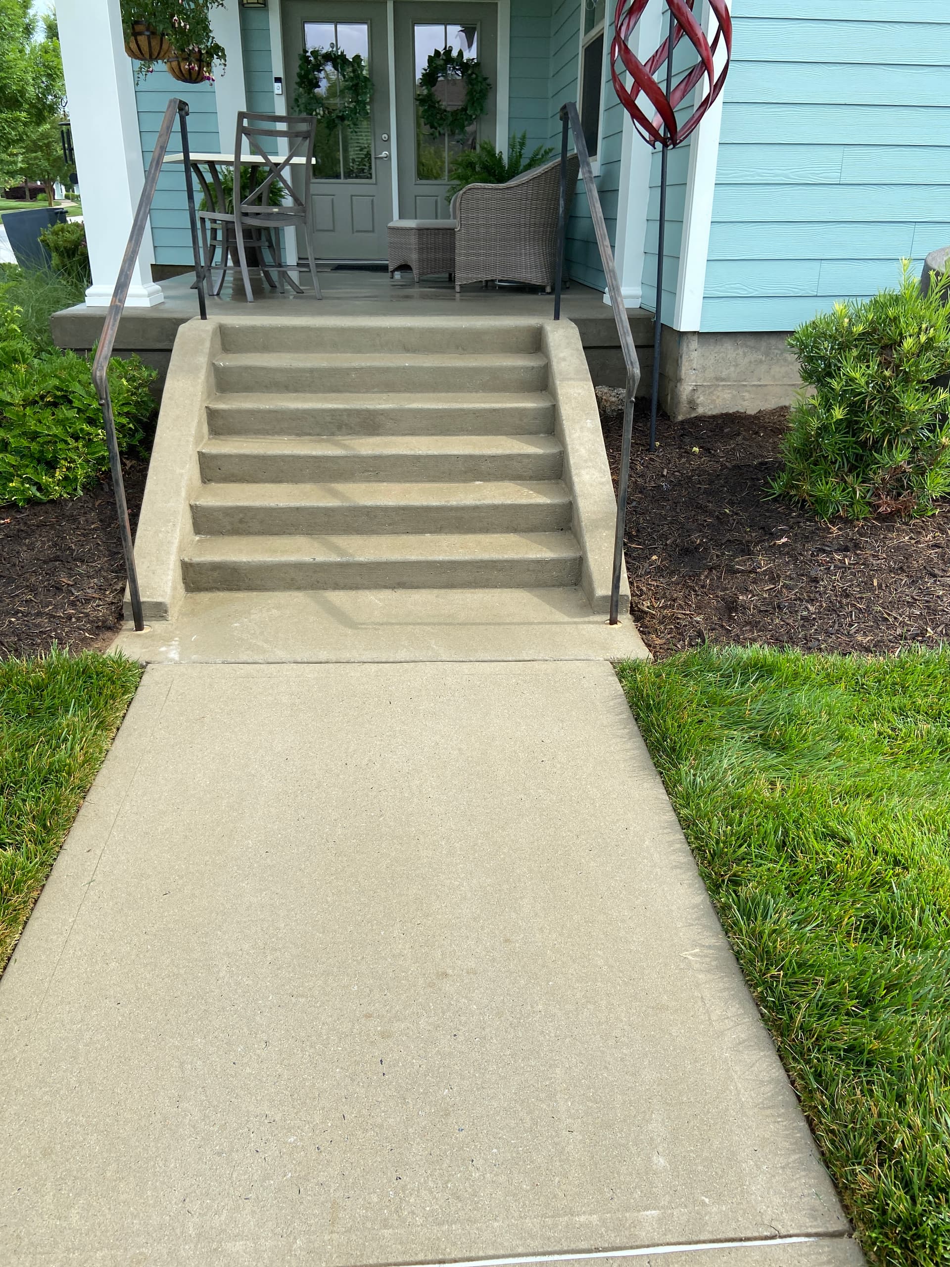

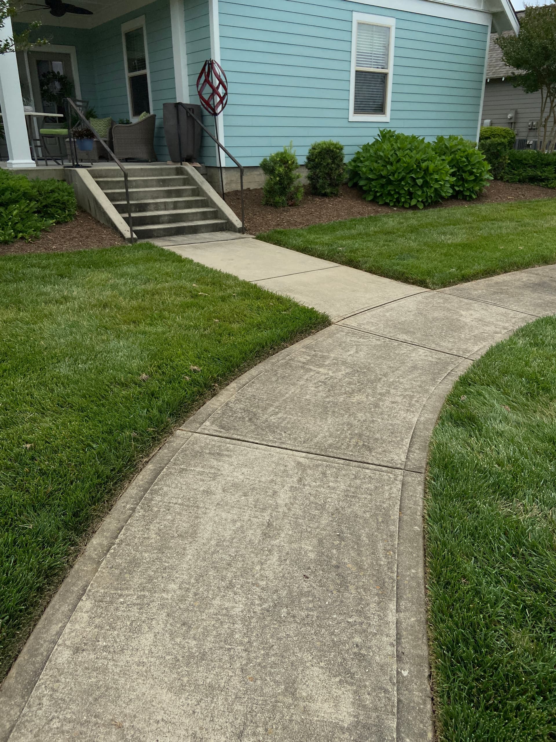

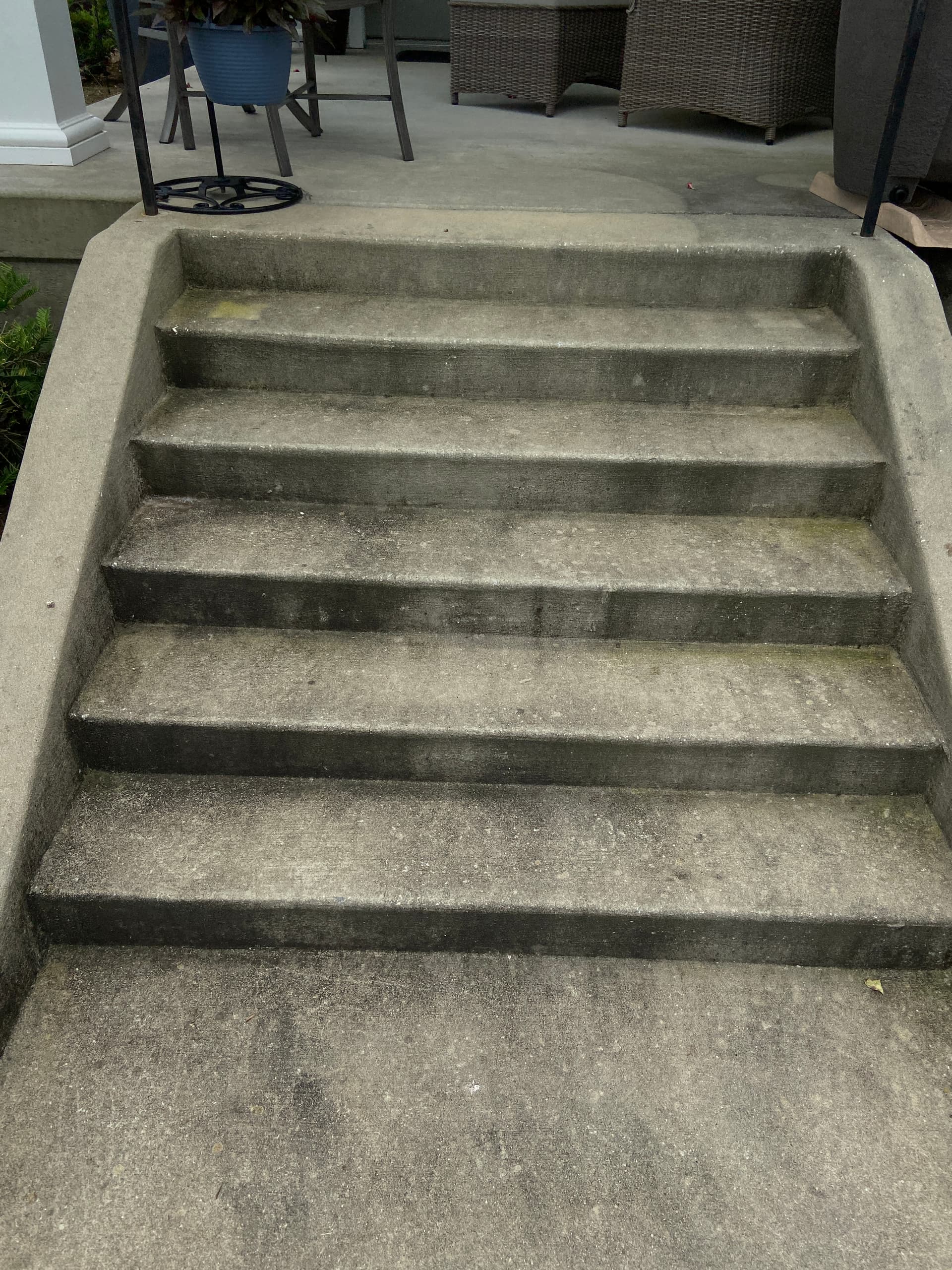

The below pics shot yesterday at an apartment complex where I was cleaning some walks between rain storms
The only thing I used stronger than my standard HW mix was on on the steps, just used my pump up of SH to hit the face of the steps and top of sides.
Look at that piece of beauty!! Nice work here @Racer

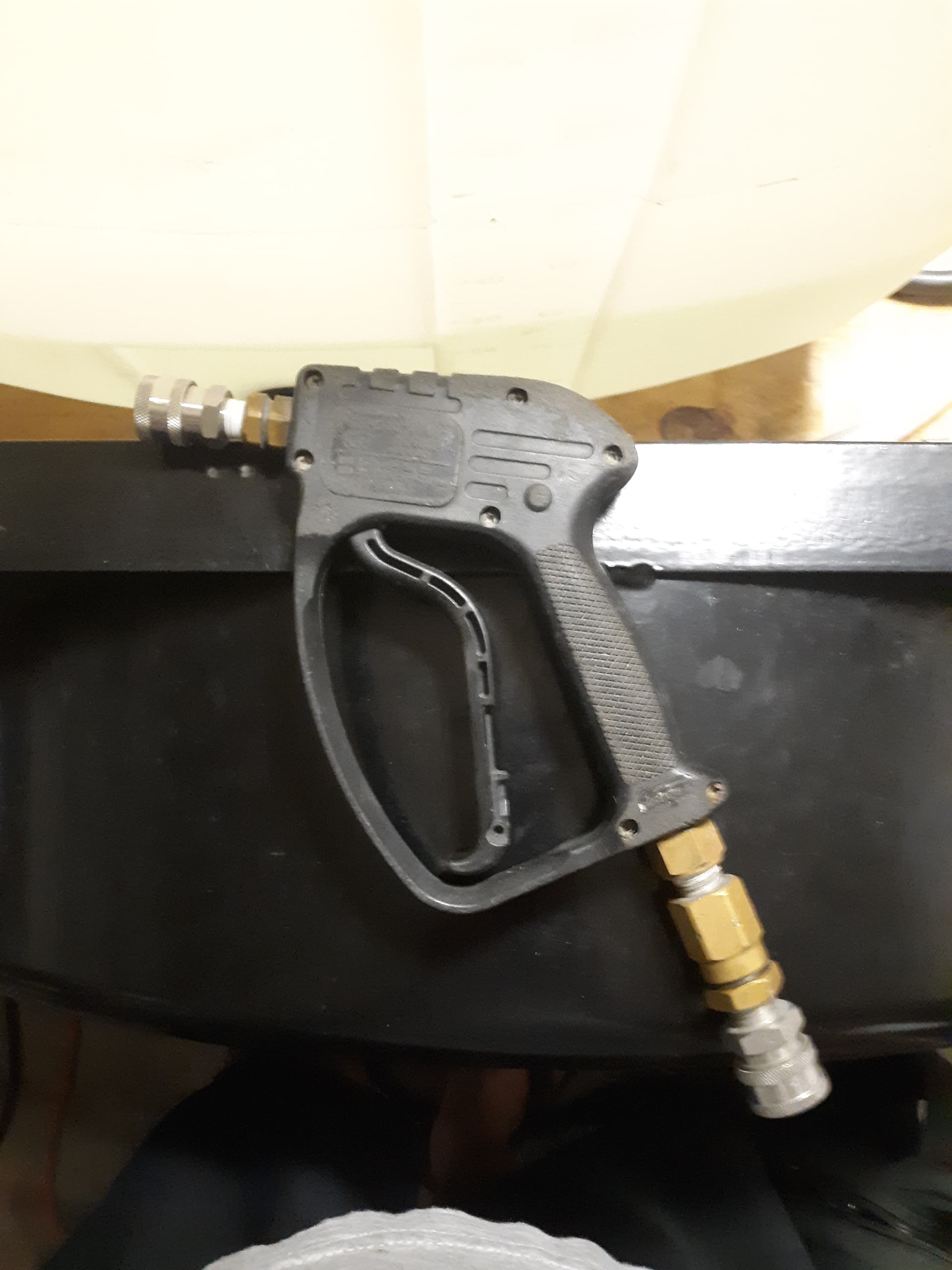

@CaptainSparrow. Im wondering how your trigger handle is setup. It should look like this. 1/4" socket coming out to accept 1/4" plug. Now the handle is your valve
YWIA
My setup as well.
That’s an unnatural way to hold your hands unless you’re really long limbed. You’d have to walk with your right shoulder dipped all the time or walk with your handle up above your belly, lol. Plus if you need to pop a random piece of gum, clean out an edge or one of the 10 other things I use a BV for, then you have to go find your wand, plug it in, then unplug it, plug back into Sc, etc. But then I spend 50% or more of my time behind a SC. If you’re only doing occasional, each to their own.
I stick the short wash wand/jrod in my belt loop. The longer one gets thrown in the yard somewhere as needed.
