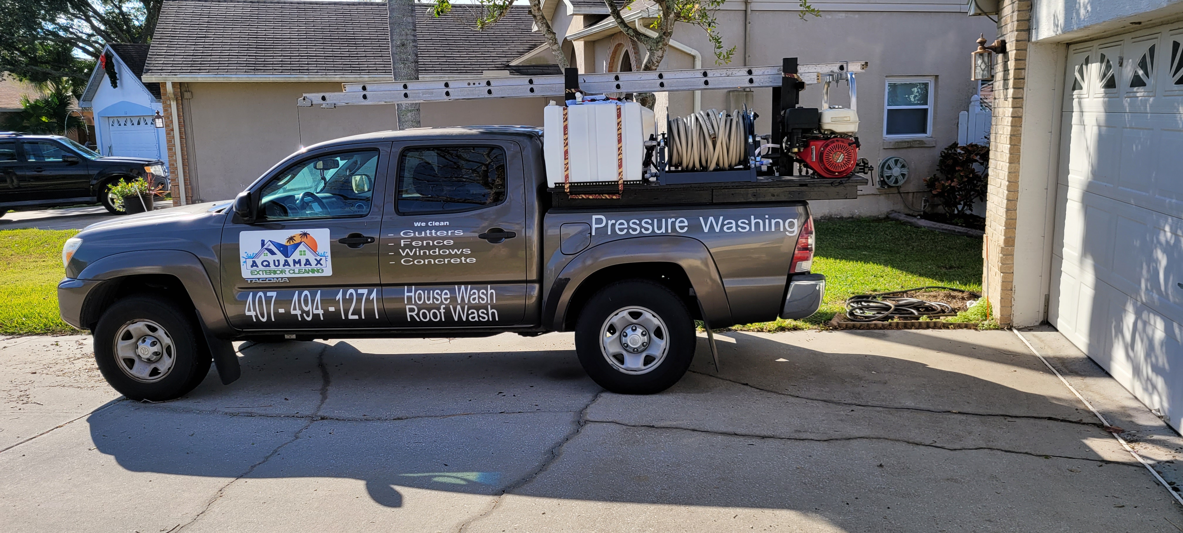

I use my 100PSI 12v pump to apply Mix on most jobs.
Here in Florida growth can be really bad, a lot of stucco also, need a stronger Mix to do it in 1 pass etc…
12v is nice and quiet with good control of quantity and strength of spray. Good for normal size house jobs.
I have a 10-1 Injector that works well when needed.
I made the calculator to help guys with batch mix math.
I use mixing valves to adjust my SH, Soap, and Water mix pulled by the 12v pump.
That way I dont need a batch tank, I can change mix strength at any time, and no leftover mix .
Saves room on my short bed Tacoma truck.
