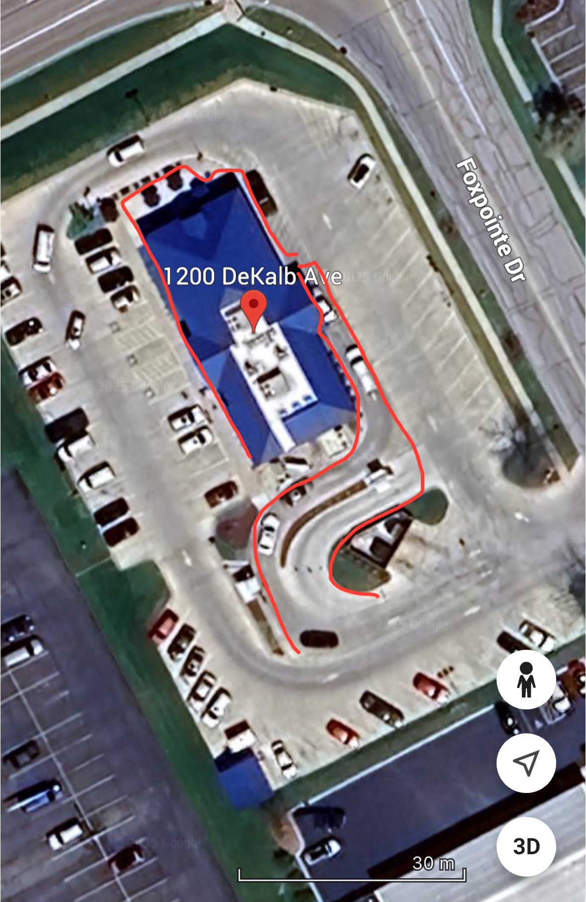

Here’s a Culver’s. I would like to know where you guys are at on this for pricing. I do not have a hot water machine. Maybe depending on the bid I could justify purchasing one but I don’t do a lot of commercial that requires hot water. Was thinking Gold Assassin or EBC. Thanks in advance!
It would be the drive-thru lanes and sidewalks specifically, and any other spots where grease and such builds up. They are also looking to have the building power washed at least once or twice over the summer.
I’d be renting a hot water unit TBH. Sure would speed things up instead of futzing around with degreasers.
Yes I actually think that would be the best option!
Heat for sure helps….
Do you all have an hourly rate you shoot for on commercial?
On most drive-thrus, once you clean it once, thry’re probably going to only want the portion done where cars consistently sit in line. may only be the last 100’ before pickup window. The cars sit there and drip oil, there will also be a lot of gum, where people throw out their gum as they’re getting ready to pick up food. To do it efficiently and quickly, really need hot water. Typically, I’ll walk thru with a pump up and hit the really bad spots with pretty strong mix, say 20-40% degreaser, let sit while you’re getting setup, then downstream with warm water your degreaser, including over spots you’ve already hit, then start cleaning, typically around 140-150 degrees, unless really, really bad. 150+ will give you quickest results on gum
