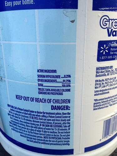

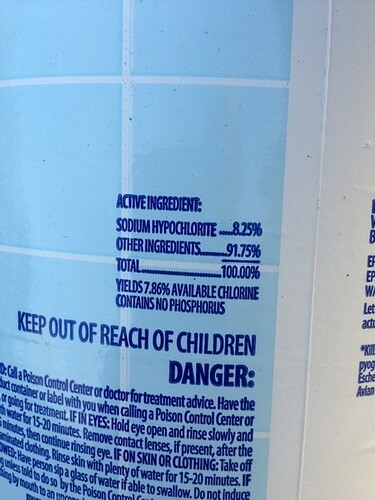

Store bleach here is 8.25%. But, you never know how fresh it is.
You must be using the Clorox outdoor bleach
No. The regular bleach, Walmart brand or regular Clorox, is 8.25 here.
Here, too.

How are you figuring that? Clorox from the factory is 6% out the door and Walmart (or any store brand bleach is 3%) Your Clorox outdoor bleach is 8.5%. That’s standard around the country. They add Sodium Hydroxide in it for some stabilization.
That’s how Walmart, Kmart, Dollar general, etc can sell their store brand cheaper. It is regular Clorox cut in half with water. That is why you never buy the store bought brand because you’re getting cheated. Some store bought brand things are ok to buy…like milk. In the produce industry, there are tiers to who gets the better shelving. The dominate brand is usually second grade (or sometimes first grade depending on the product) and just private labeled for the store. Most always, the dominantly displayed milk will be who private labels the milk for Walmart. Around here, it’s Purity milk. Same thing, only a dollar or two cheaper. Store bought bleach is totally different because they are cutting it with water to make it cheaper and sell it cheaper.
When house washing you want around .5% sh applied to the house. Just about everyone here downstreams their solution with a pressure washer. So if you are using a pump up sprayer you want to get to .5% solution you would take the bleach strength say 6% and figure out how much water to add to it. Which is about 10 parts water to 1 part sh. This is the equivalent of down streaming the solution. You will probably need around 30 gals of solution to do your house with a pump up sprayer.
I stand corrected. The new Clorox concentrated is 8.5% Sodium Hypochlorite.
http://www.maine.gov/dhhs/mecdc/environmental-health/water/documents/CloroxConcentratedDosageGuidance.pdf
Use the Clorox that they sell for outdoor use. Mix as recommended and adjust your mix if needed.
Also, I never said I am using it. I am using 12.5%, but if you’re in a pinch, the Walmart Great Value is 8.25%. And I’m figuring it by looking at it right now. Not something I would give false info about.
Wyatt, my apologies. I didn’t know Walmart changed how they did their bleach. It USE TO BE only 3% SH because they cut it. Thank you for showing that, as I haven’t kept up to date with it, as I, like you, use 12.5% from a Chem manufacturer.
