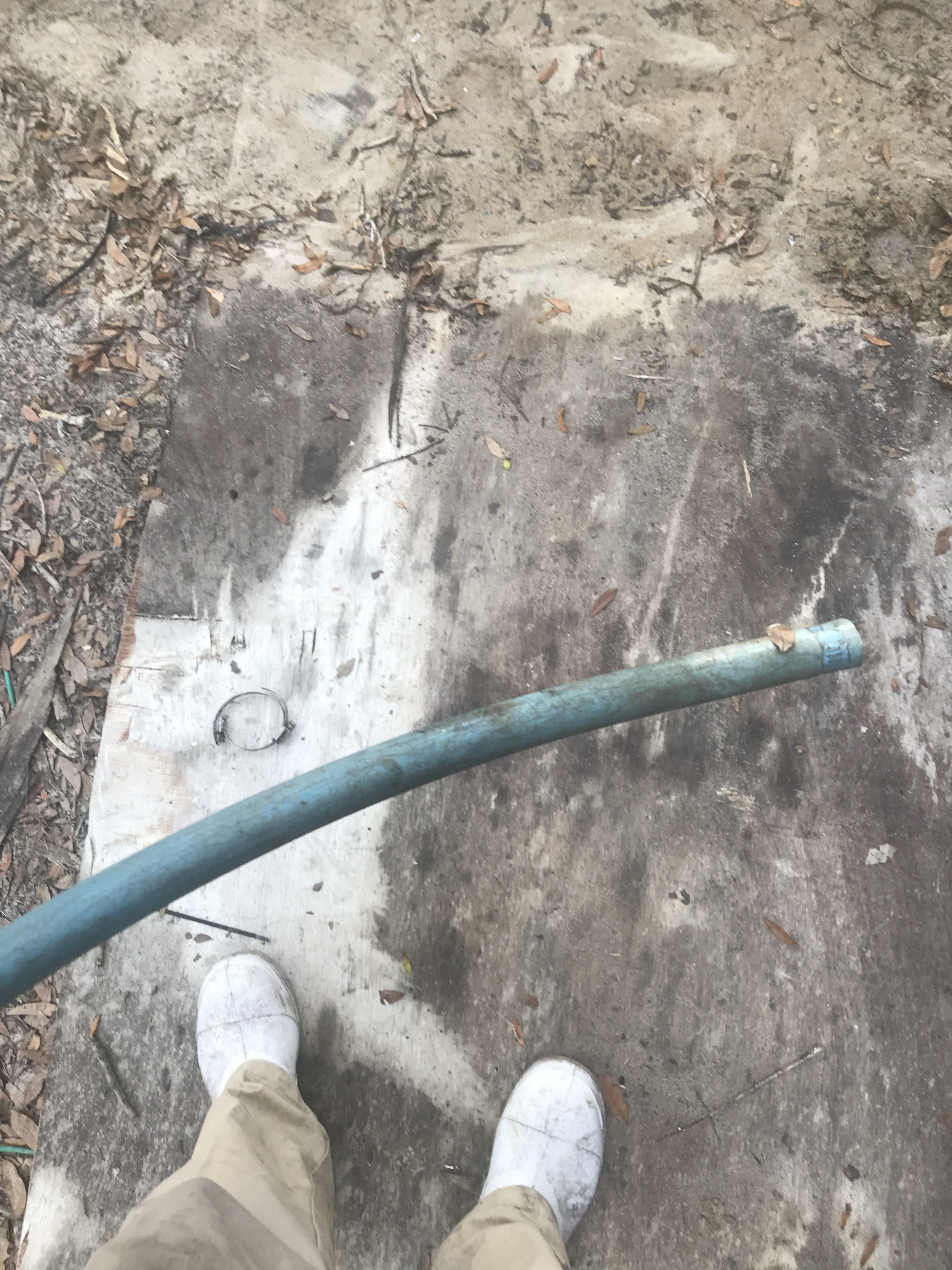

Third photo with the blue hose is 5 years old . That’s five years of being dragged down streets/ over sharp gutters and ran over by cars at least once a week . It’s still in working condition. I only replaced it because is 250ft and I needed 300

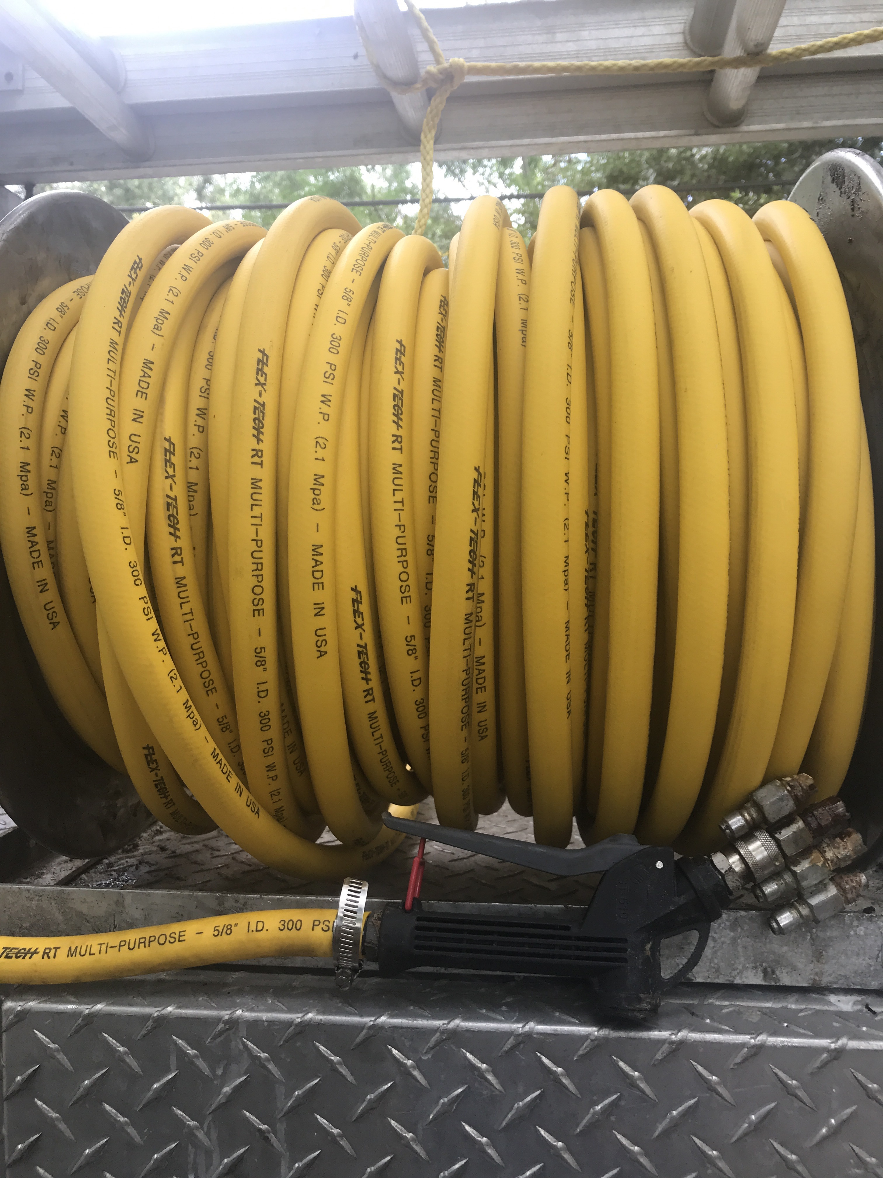

That blue hose iis it the flex tek or kuri tek
Flex tech r/t 5/8. I’m not familiar with specs using 12volt pumps . But generally 1/2 is good up to 200ft after that is starts to choke out the pumps . 5/8 won’t have that problem even at 300ft . It’s not much heavier either never noticed much difference in weight while using it
I run an Aluminum titan w/ SS manifold and super swivel. 18" Run about 250-260’ of hose
1/2 or 5/8 @Racer
1/2 inch
