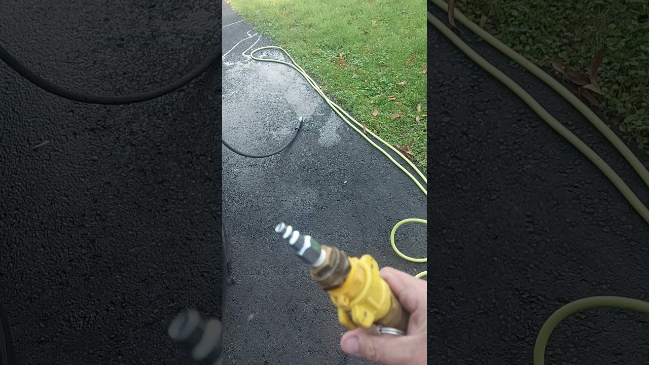

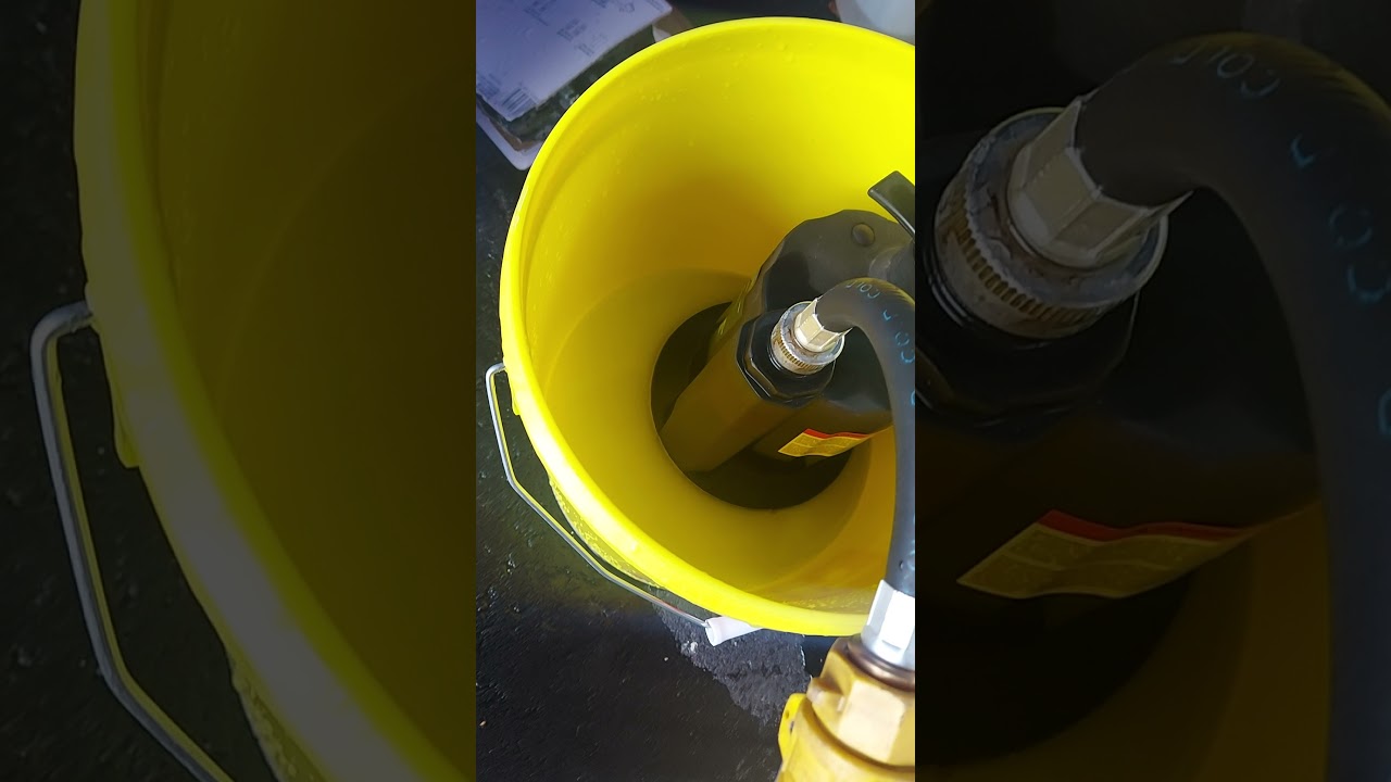

So, where I am in Canada, we can work during the day in the fall and early spring, but we have to keep our stuff from freezing overnight. I used to use a heater and a blanket, but that was risky, and a major fire hazard, not to mention expensive.
A buddy of mine inspired me to do nightly winterization at the small cost of a jug of windsheild wash, small price to pay to be up and running the next day:
[![](https://img.youtube.com/vi/Ep3vzJNa-r0/maxresdefault.jpg "Air compressor fitting for pressure washer") ](https://www.youtube.com/watch?v=Ep3vzJNa-r0)
and:
[![](https://img.youtube.com/vi/STHq1cE7tH4/maxresdefault.jpg "Winterizing a pressure washer") ](https://www.youtube.com/watch?v=STHq1cE7tH4)
