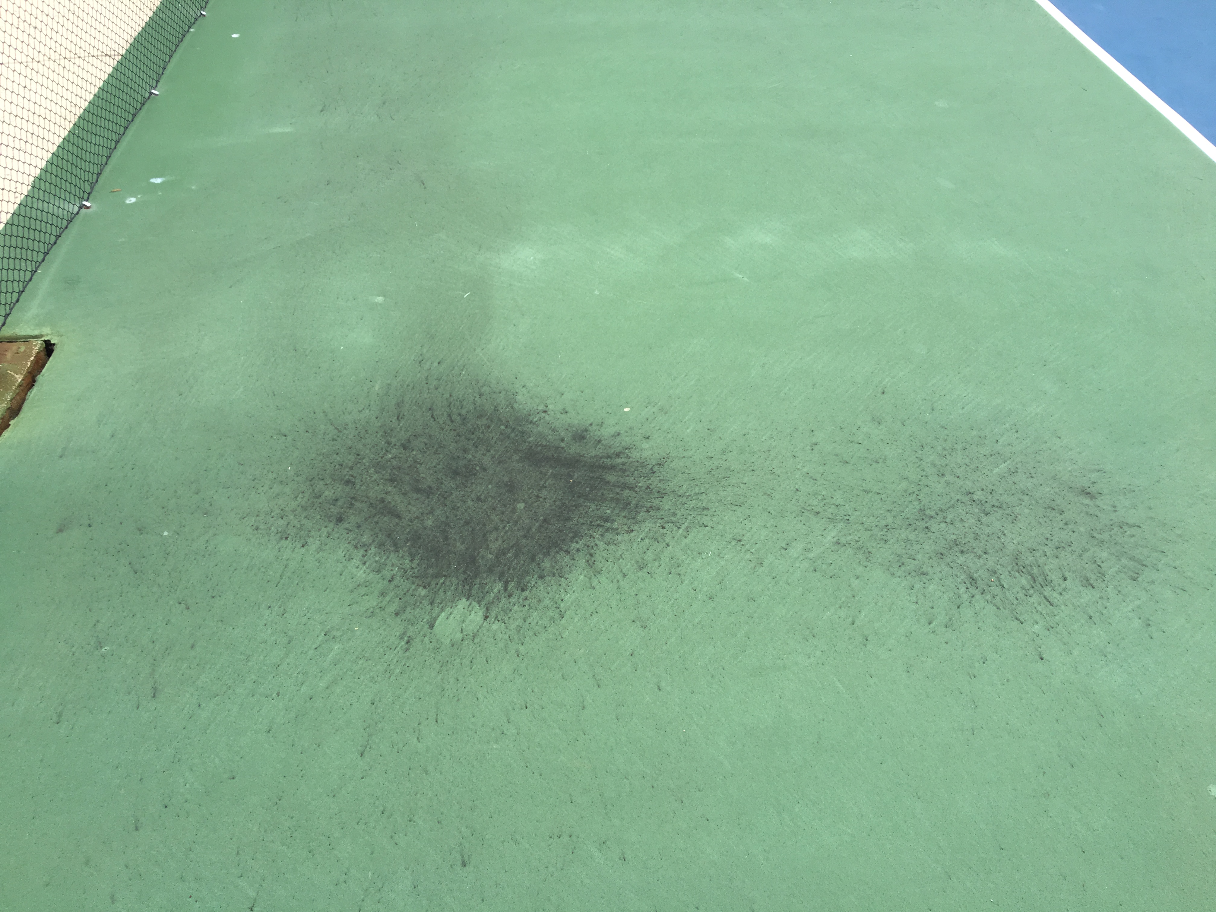

How old are the courts? Have they ever been washed? How is the drainage? Is there black algae? I did a Tennis Court last year and it was the worst job ever. The court was older, never been washed, and had thick black algae in areas where water would sit when it rained. I threw down a 50/50 SH mix twice and used a surface cleaner at 4,000 psi. 90% of the court came out great just from the SH, but in areas that never got sun and had bad drainage pressure would barely touch it. I know hot water will/ can strip the paint. I underestimated the surface, and was super happy when it was done. I would maybe spot clean one of the worst ones and see how your results are. Good drainage and plenty of sun it wouldn’t be to bad.
Those pics don’t look to bad, the ones I did was a red court that looked black from a distance

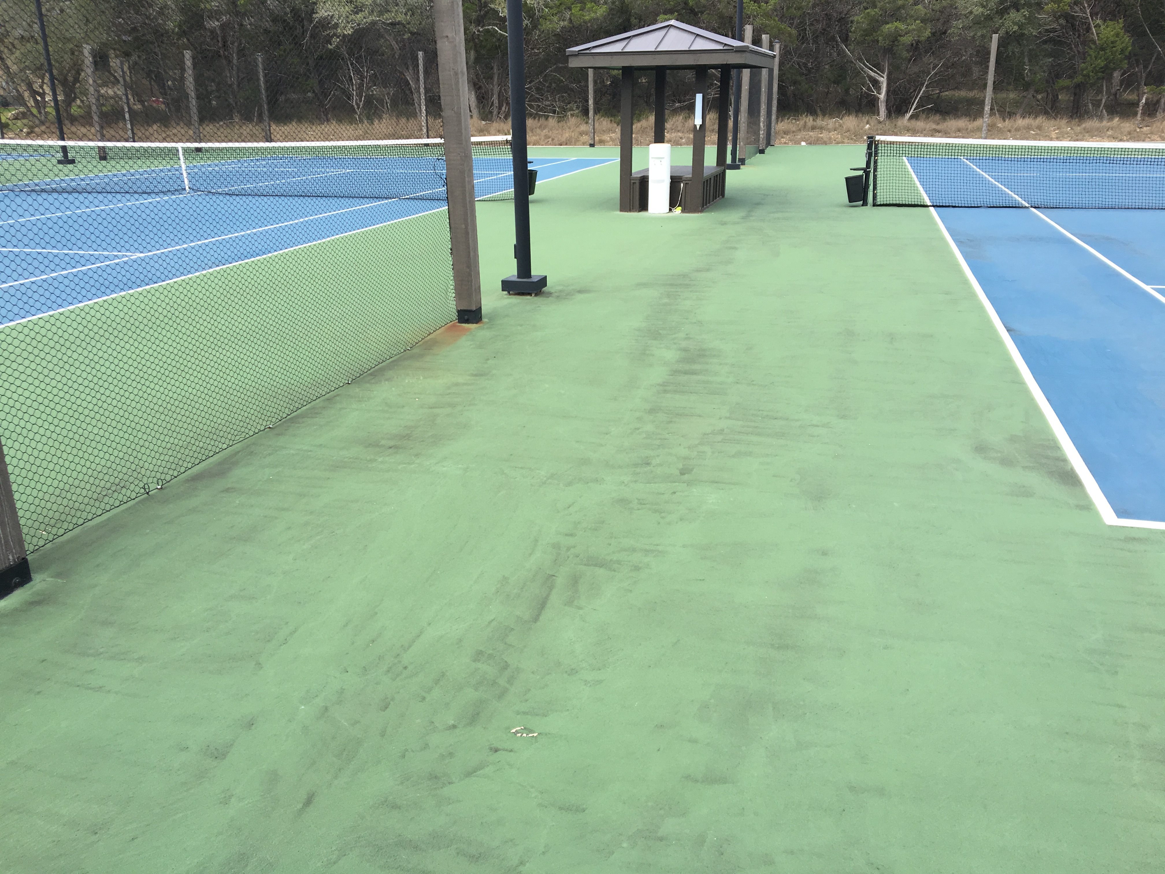

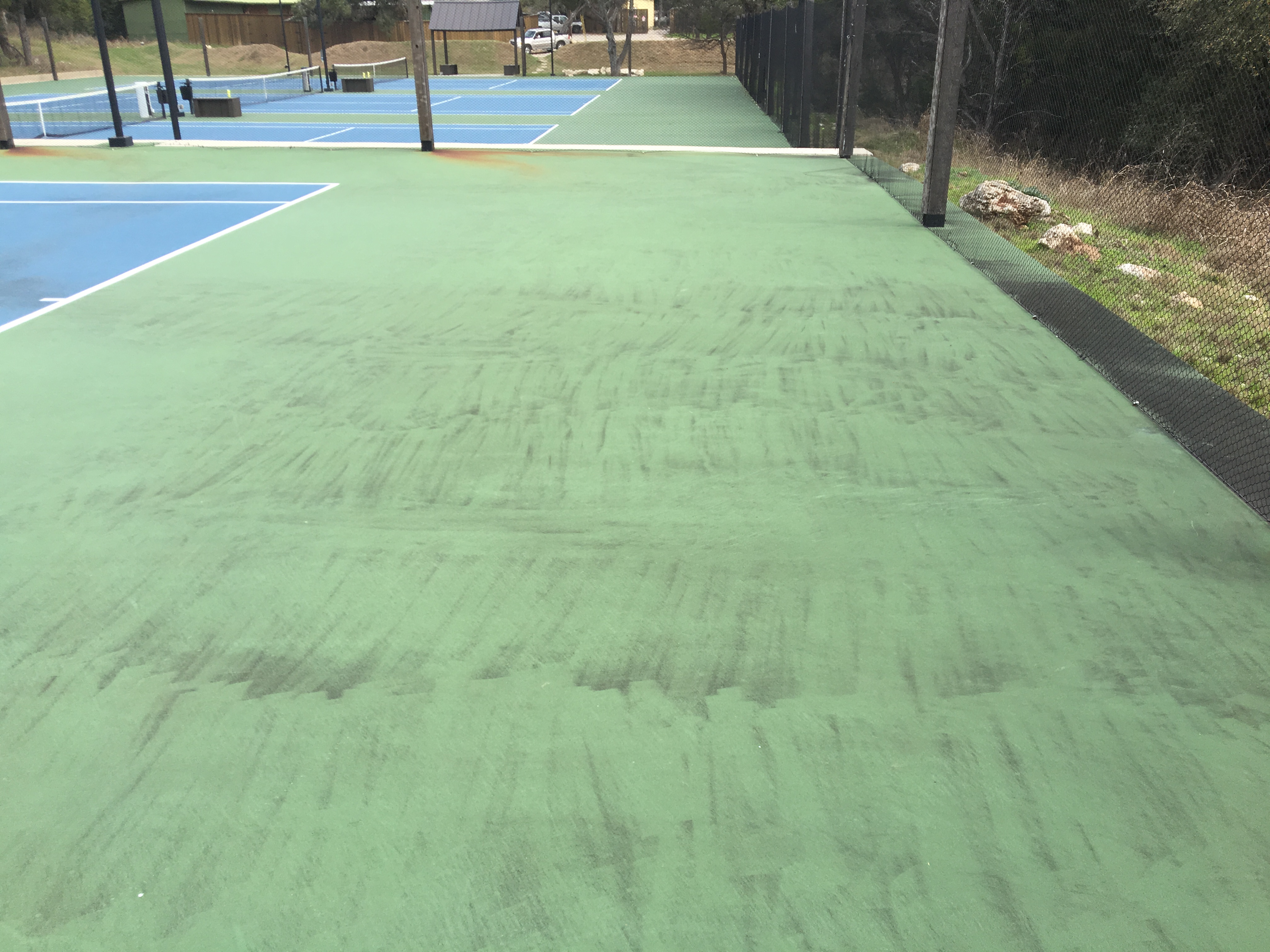

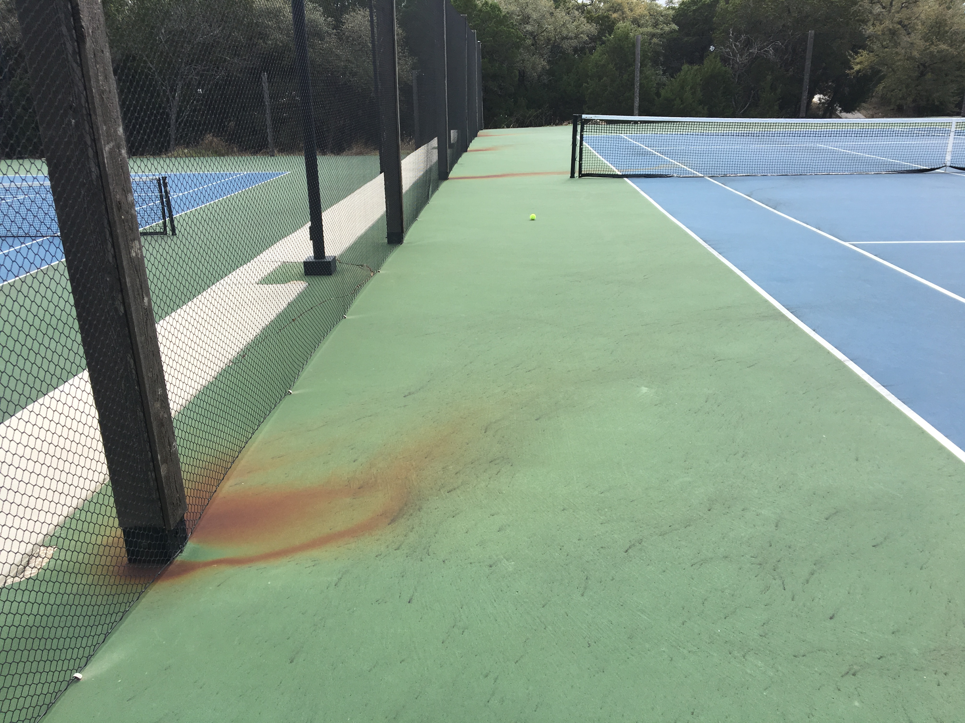

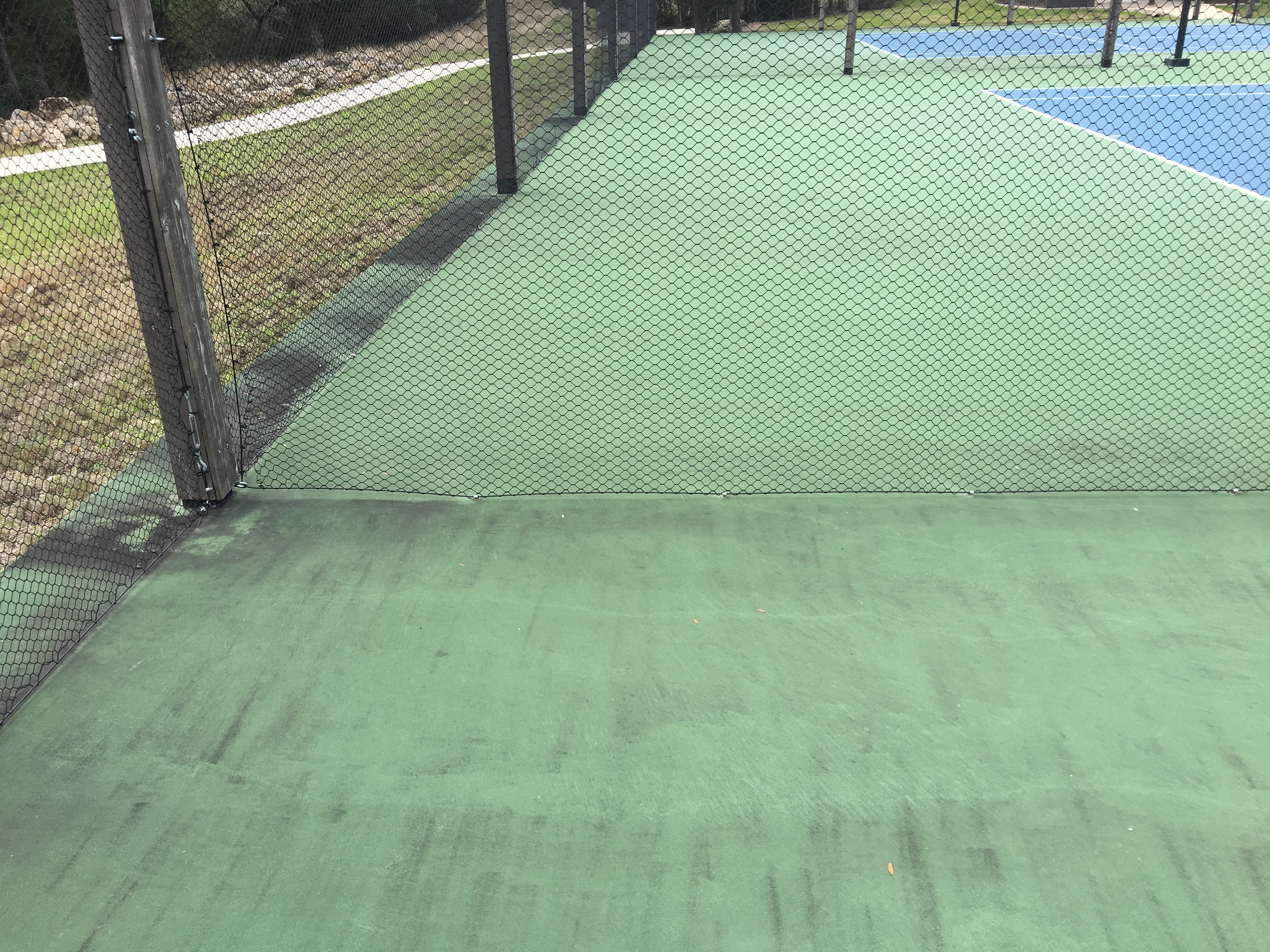

Not sure of the age of the courts but I believe they have had them done in the past judging by the wand looking strokes in that one picture. Ever had to deal with rust on courts?
Wow yah just seen your pictures. Someone butchered that court pretty good. That might be a good area to spray with a pump up and see the effect of the SH and what pressure will do.
Rust on the courts, no I have not. Test that too before throwing in a bid. You will know after that how much $ to charge and/or if it’s even worth it.

Ox acid will kill the rust but how much will it lighten the coating? Thats the issue. You could maybe use it and be ready to rinse as soon as the rust is gone. Not a second later

They are pretty easy. About 3% SH and a good surface cleaner. F9 is good for rust. The SH will help with the stripes, but take the slow and get it right the first time.
