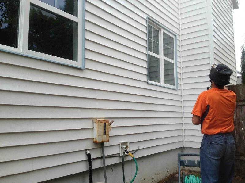

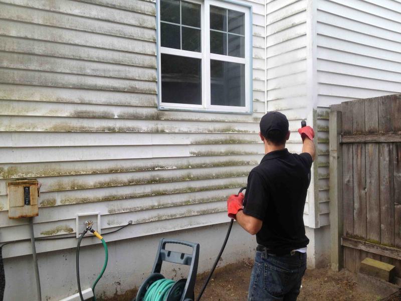

Just downstreamed a house today - whole house out of a 5 gal bucket. Nasty algae. Of course, the downstream attachement stopped working as the job got started. Having a backup injector is A NECCESSITY! Amazing watching the algae just melt off the house!

that’s about the nastiest house I’ve ever seen. good work :open_mouth:
