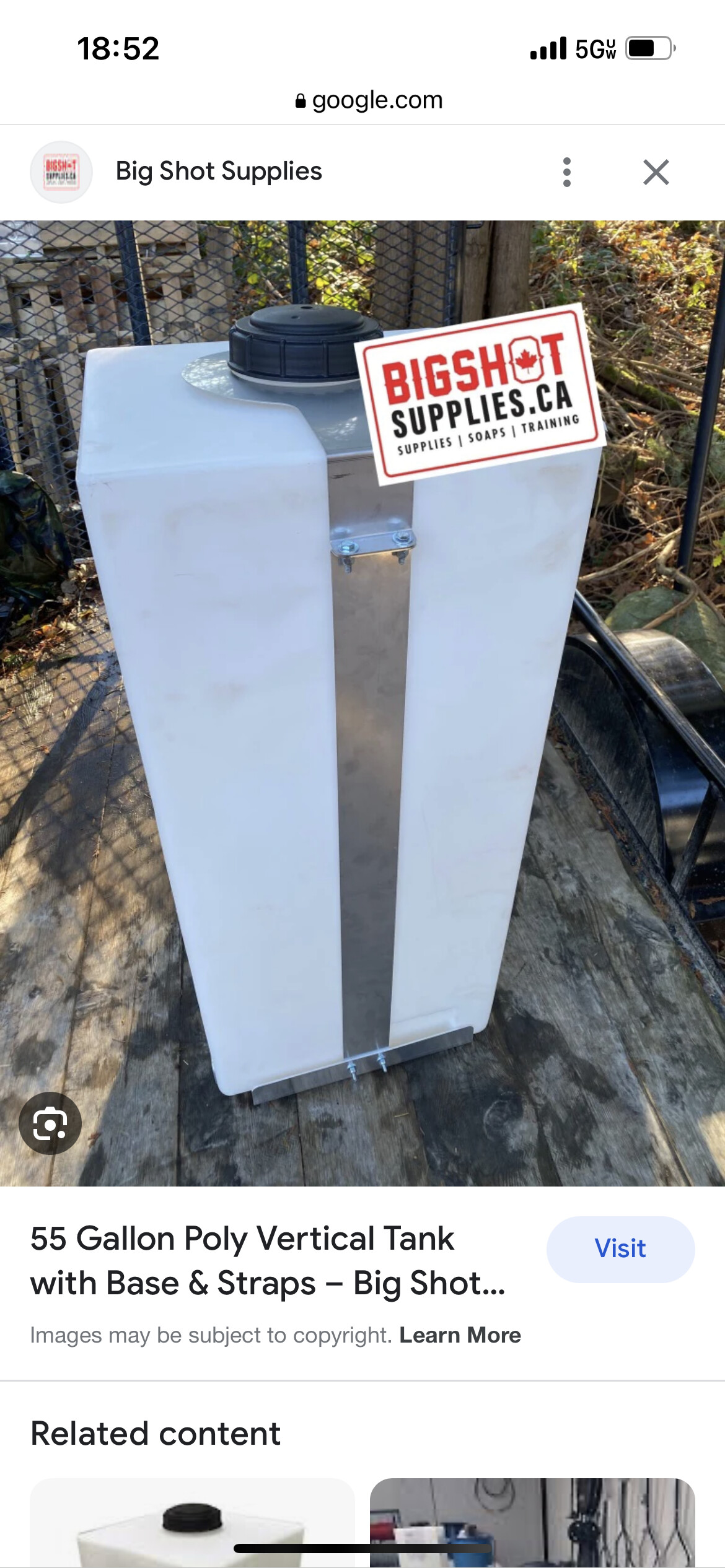

I use one of those 55 gallon vertical tanks with a bulkhead and it has never leaked

This is the type of tank I have. They make steel straps for them to secure it. I have had the same bulkhead on my tank for close to 5 years and it’s never leaked.

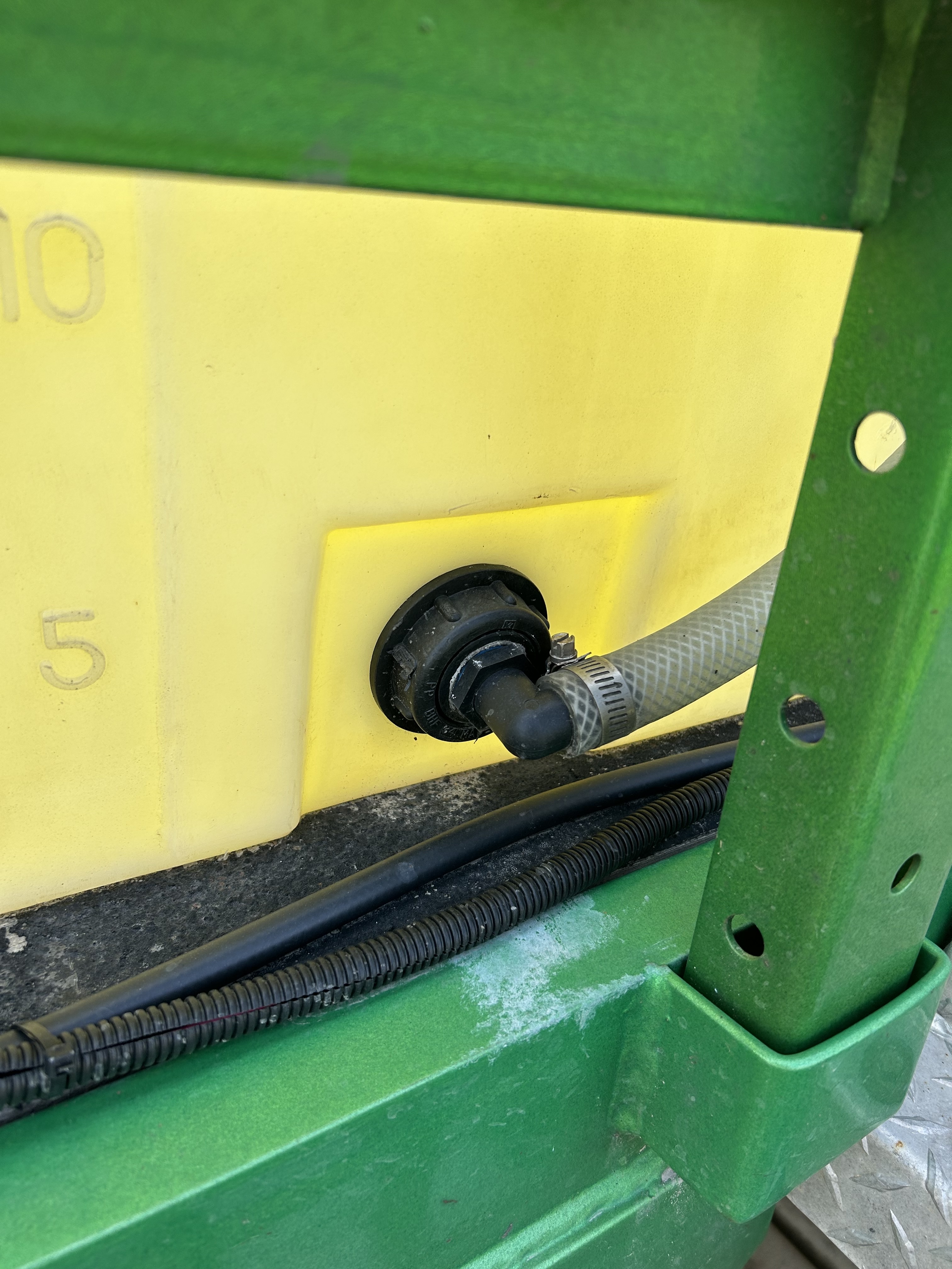

So there are some guys using sh tanks that have a bulkhead fitting at the bottom of the tank and haven’t had leak problems? Any particular way you are sealing it against corrosive sh?
