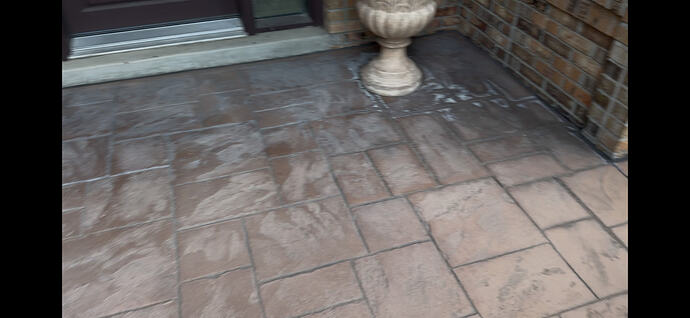

Retaining wall

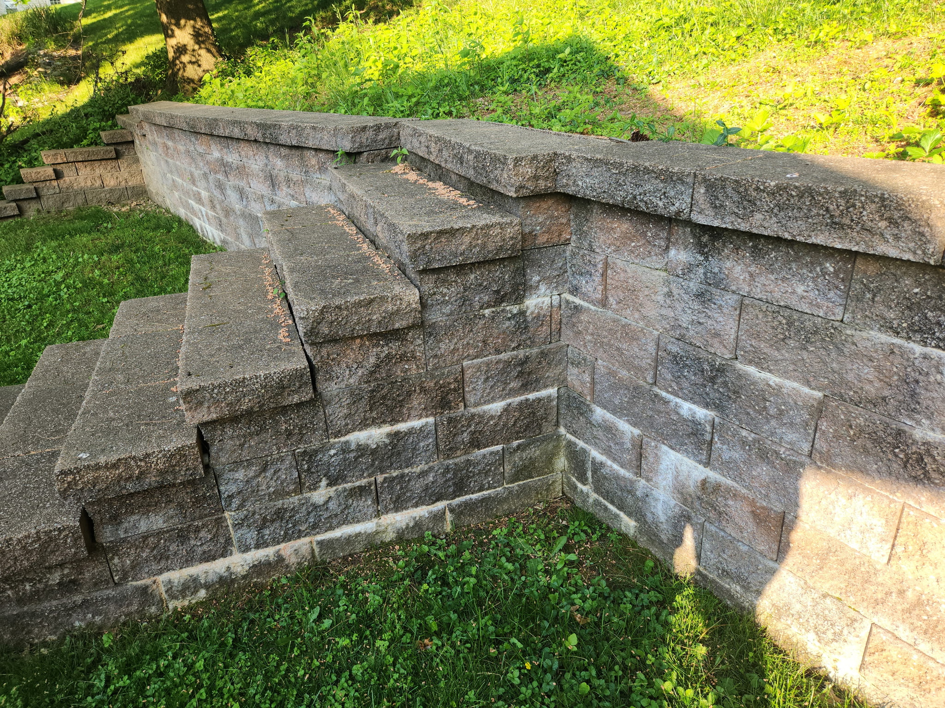

Plan is to hit with about 4% SH solution, let sit, hit again then turbo nozzle (lots of moss not in pic). Any suggestions or chemical recommendations on how to get the white off? Assume its efflorescence.
Any acid should take care of it. This was a brick wall I did recently that was just a 50/50 mix of aluminum brightener

On outdoor tile do you think aluminum brightner will work?
Generally speaking, if you mist it with water and it disappears it is efflo. If it doesn’t disappear, it could be calcite or white scum. This isn’t directed at you Qons, just thought I’d put it on here for the new people.
