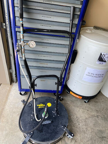

I use a pressure regulator on my surface cleaner to lower the pressure to clean new stuff…..works great.

got a pic or link? I don’t think I have seen this before.
is it like this? https://chappellsupply.com/pc_product_detail.asp?key=49768EA2938F4FFD8B46787EA3F3C581
Yes that’s basically it, just reduces pressure and discharges the water down under your surface cleaner deck. It works great, comes in handy for sure.

I don’t have castors, would that bypass still work with a floater? I feel like I’d have to drag it around
Thanks. I guess it allows you to ballpark it then, since the nozzles would still ultimately determine the pressure. So do you just keep your regular nozzles on and then when doing new concrete just bump it down? I really don’t need to buy anything else this year other than SH and fuel, but I’d like to own this. I’ve bought so much stuff the last couple of months my account is crying.

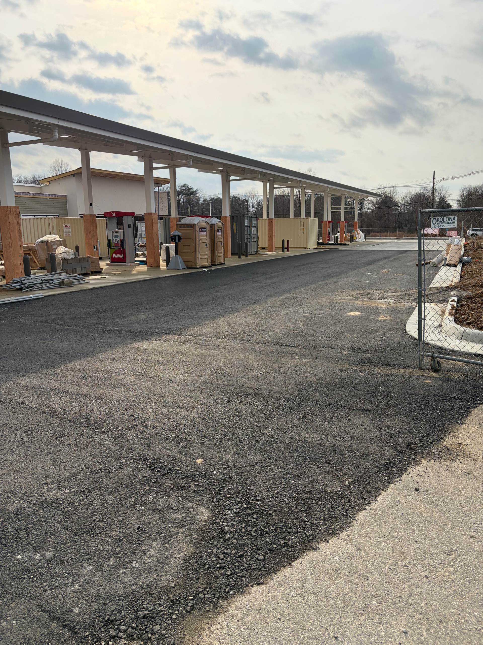

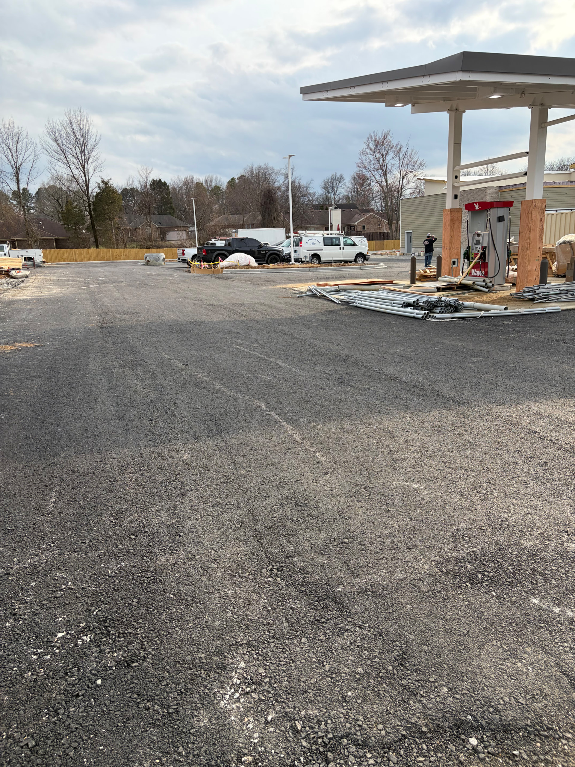

You got any pics of the wawa? How old is the concrete?
Yeah, I keep normal nozzles in…..I just lower the pressure. I’ve done a lot of surfaces with it and it works great. I think it’s well worth it’s price, gives you piece of mind when doing surfaces that need a little babying. And I label everything by the way. :joy: Anything that can save me time I will do…..time is all we have, right…..it’s precious.
I drove by it yesterday, all they really have up is the gas pumps and concrete immediately around them, everything else is just dirt
so what do they need cleaned if not even open yet?
She said “and will soon need the parking lot pressure washed”:person_shrugging:t3:

I got a couple quick shots, doesn’t really matter I’m sure someone else got the bid. I’m ■■■-u-ming the asphalt will be mostly replaced with concrete at some point
