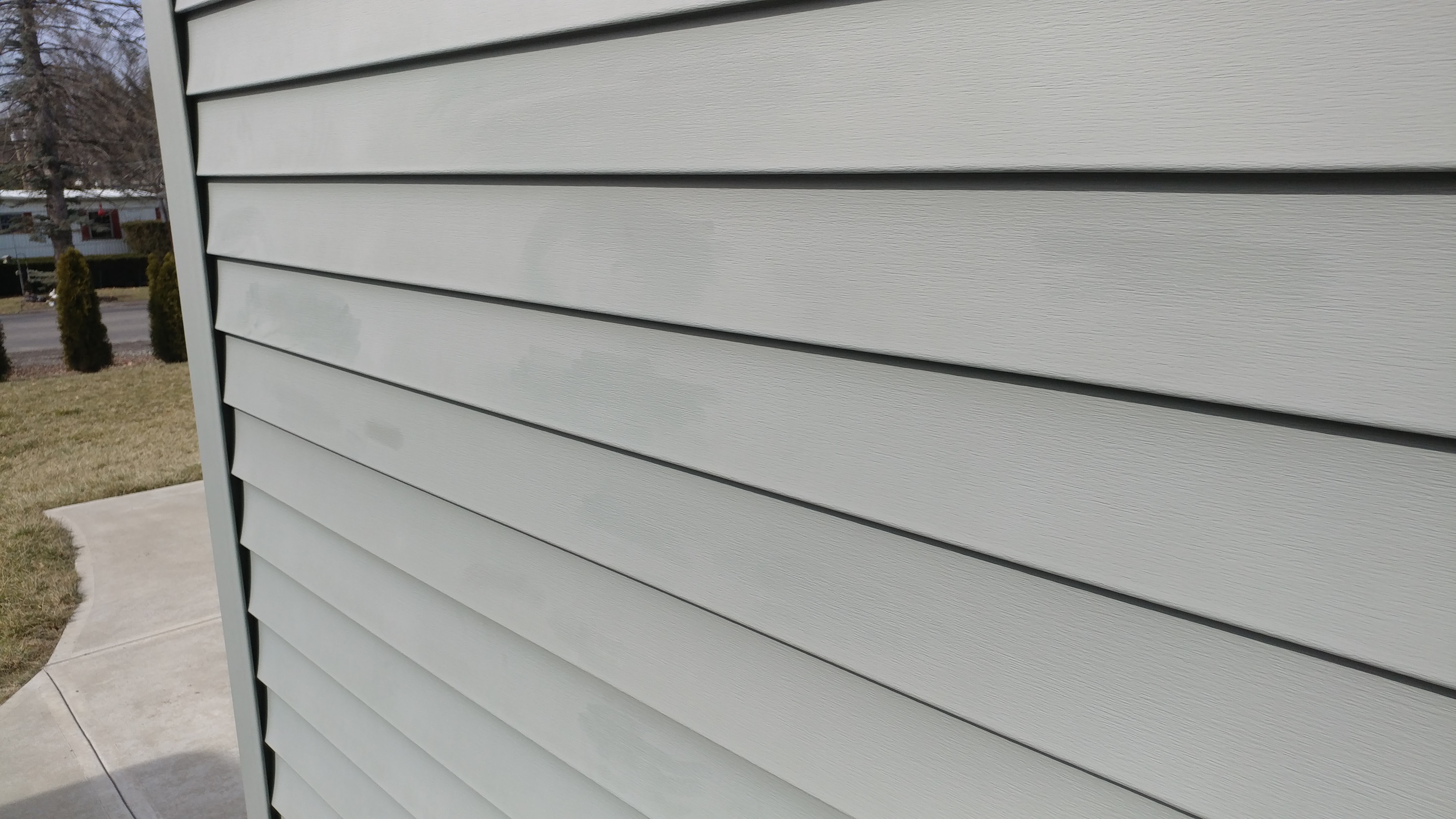

Looks great Dudette! I have a similar issue on a home I’m working on. I purchased a gallon of F13 and am excited to knock out the oxidation. I had a could questions about your tests… Was the 50/50 with water applied directly or DS? If it was DS, it would have been diluted further to say 10:1 by the injector, correct? Here is a picture of the South side of the home that experiences the most sunlight.
Thanks in advance!
Erick

Good question Erickm

I down stream it. 50/50 water and F13. I have a Jrod that has 4 different tips on a base (zero degree, 5 degree, 25 degree and 40 degree). I use which ever fan tip will get me to the peak, then if I want, I’ll switch to a wider fan. Let sit for 10 to 15 minutes, then rinse, rinse, rinse. Make sure you water the plants really well before hand - soak the ground. Then rinse/water the plants when you are done. Soak, soak soak those plants. F13 will kill them if you aren’t careful. Some folks will have someone constantly watering plants before, during and after.
#12
You just need to be careful. Don’t let it dry but give it enough time to work. We go about 10-15 minutes dwell time. Some folks downstream strait from the bucket, this mixes it with water. We’ve had good luck doing 50/50 in a bucket and downstream. Start with 50/50 and see if that works. I’d rather redo than put too much. Water any plants that might get over sprayed. Water them real good. Water them some more when you are done. Just be careful and you should be fine.
