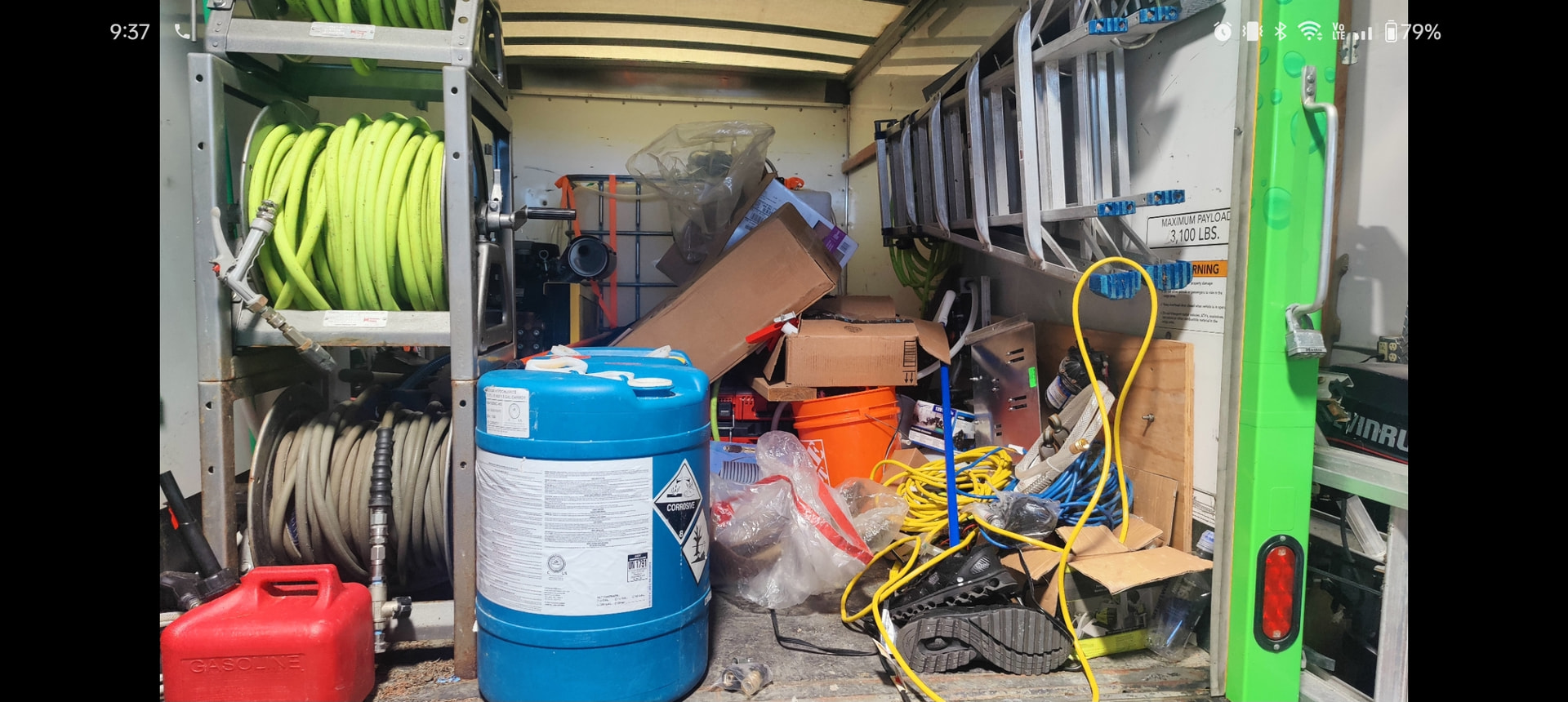

Nothing like doing this job and seeing what you never thought of initially for setup that REALLY annoys you now.
This is how I left my truck at end of last season. You know how I know this? Because old Joe left it for future Joe to deal with. And now future Joe is present Joe, and annoyed with past Joe.
I always start the season with organized truck and usually it’s one big mechanical breakdown away from just getting blown up and bugging me for the rest of the season as I almost never take maintenance days and band aid everything until end of season.
This next year will be better as I’ve moved into a boat condo and have room and heat to work on things. I promise!

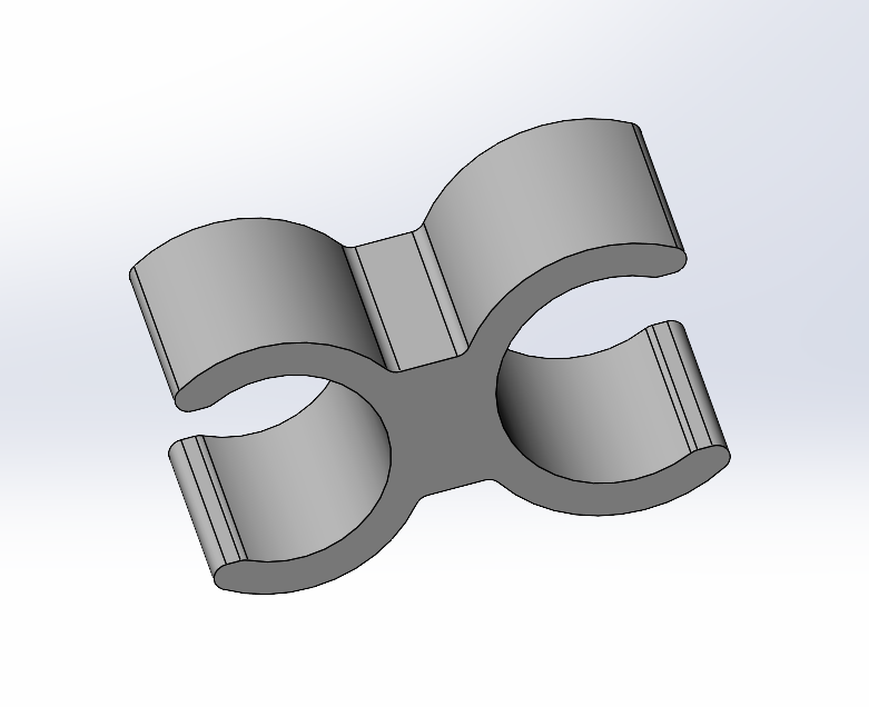

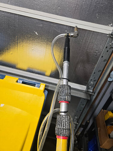

For my soft wash setup, I decided that I needed an easier way to get to really high or hard to reach areas without getting on a ladder or a roof. I mounted a nozzle to the end of a 24’ extension pole in such a way I could angle it. I then 3D printed a clip that holds one of the injectors I use to the pole. Instead of a quick connect on the output of the injector I simply have a barb fitting for the extra hose. I’ve already used it a few times this year and it’s so much easier than getting out a ladder. Also, those impossible to reach area above garages and what not that needed you to get on the roof to reach are no problem. Go up several feet on the ladder, extend this out and angle the nozzle how you need to.
Thats very neat. I think I made a post regarding the telescopic applicator a while ago.
What flow rate/hose diameter are you using for this? Does the hose go straight from the 12V pump or is there a connection piece between the main pump hose to a small diameter hose for the pole?
Thanks
For this pole, I’m using a smaller flow rate injector, so it’s only a #20 nozzle. It’s 5/16” ID hose, so more than enough for this nozzle. I use a 0020, so I get good distance and control. It’s only for those areas I can’t normally reach, so no need for a ton of flow. Water is supplied from my own design booster system. 100 psi through a garden hose. Cleaner is pulled from a jug right to the injector on the pole.
A nice carbon fiber pole would get you even more height and control due to rigidity. Totally worth the couple hundred. Nice setup.
I only do residential, so even when I use this, it’s barely extended past 12’ or so. I haven’t had a situation yet where is been fully extended
You gave me an idea for my setup. I like your creativity.
