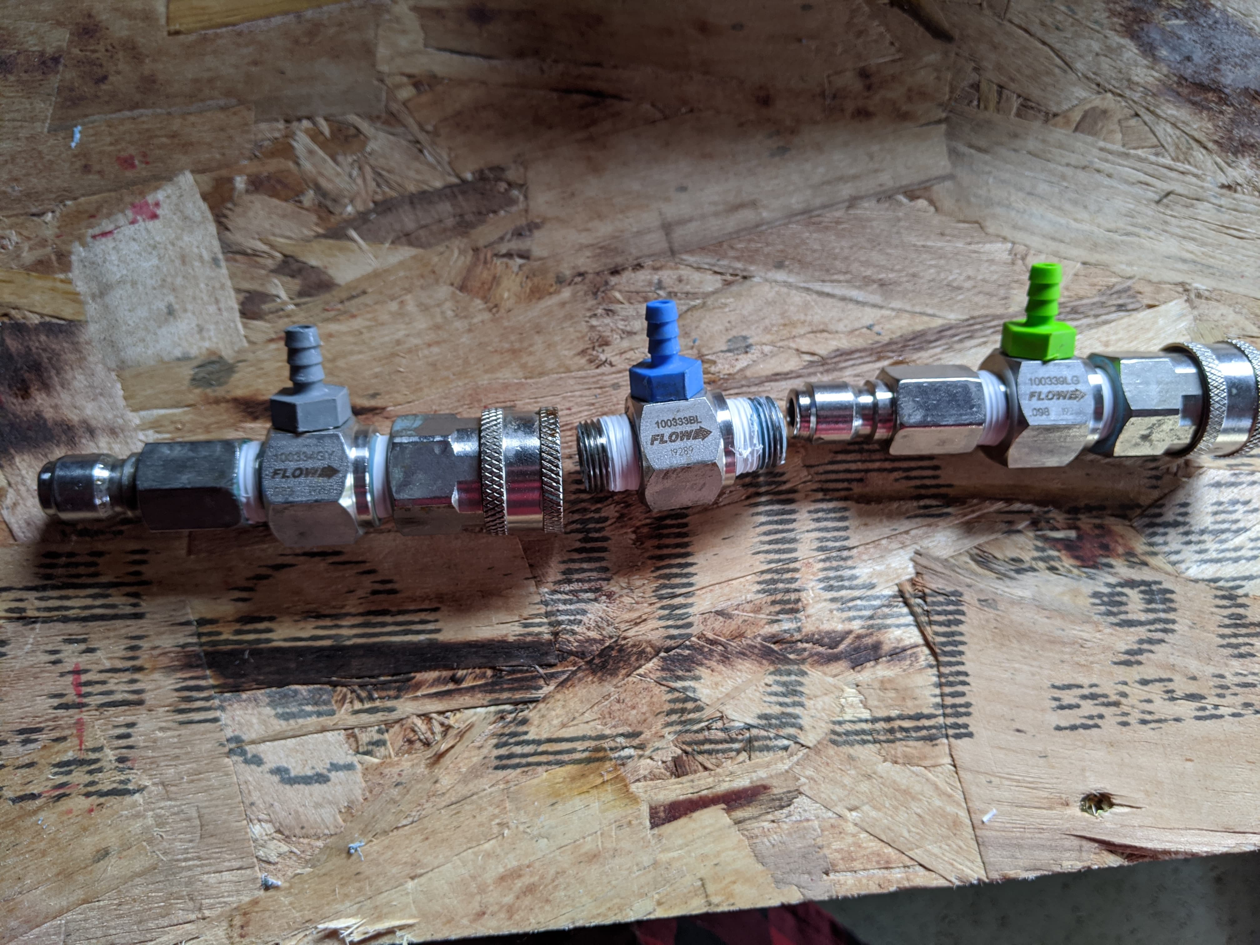

So, I just upgraded to a 9gpm machine with 200 ft of pressure hose and have been testing it before I actually go to a job with it. 2 have happened that I can’t figure out. First, it doesn’t matter which size DS injector I use, I can’t pull at more then a .6 percent assuming im using straight 12.5% SH. nI did a bucket test and im getting 9gpm. I heard I was supposed to downsized my injector from watching one of @squidskc videos since im using 200ft of hose. @squidskc I am using the GP injectors you recommend. I have tried all of their sizes .083, .086, and .098 without a tip on them and they all draw about the same. I did tried all of these with just my ball valve on. Im not sure if it matters but I am using a Schertzbox to turn my chem on and off also.
I then put on my gun and used a 6560 tip (should draw solution) and it didn’t draw anything into my injector. I took purposefully didn’t schedule any jobs for a week or as so I could set this machine up and make sure its working well. I have a couple grand scheduled on Saturday and don’t really want to reschedule them since my calendar is booked for the rest of April and half of May.

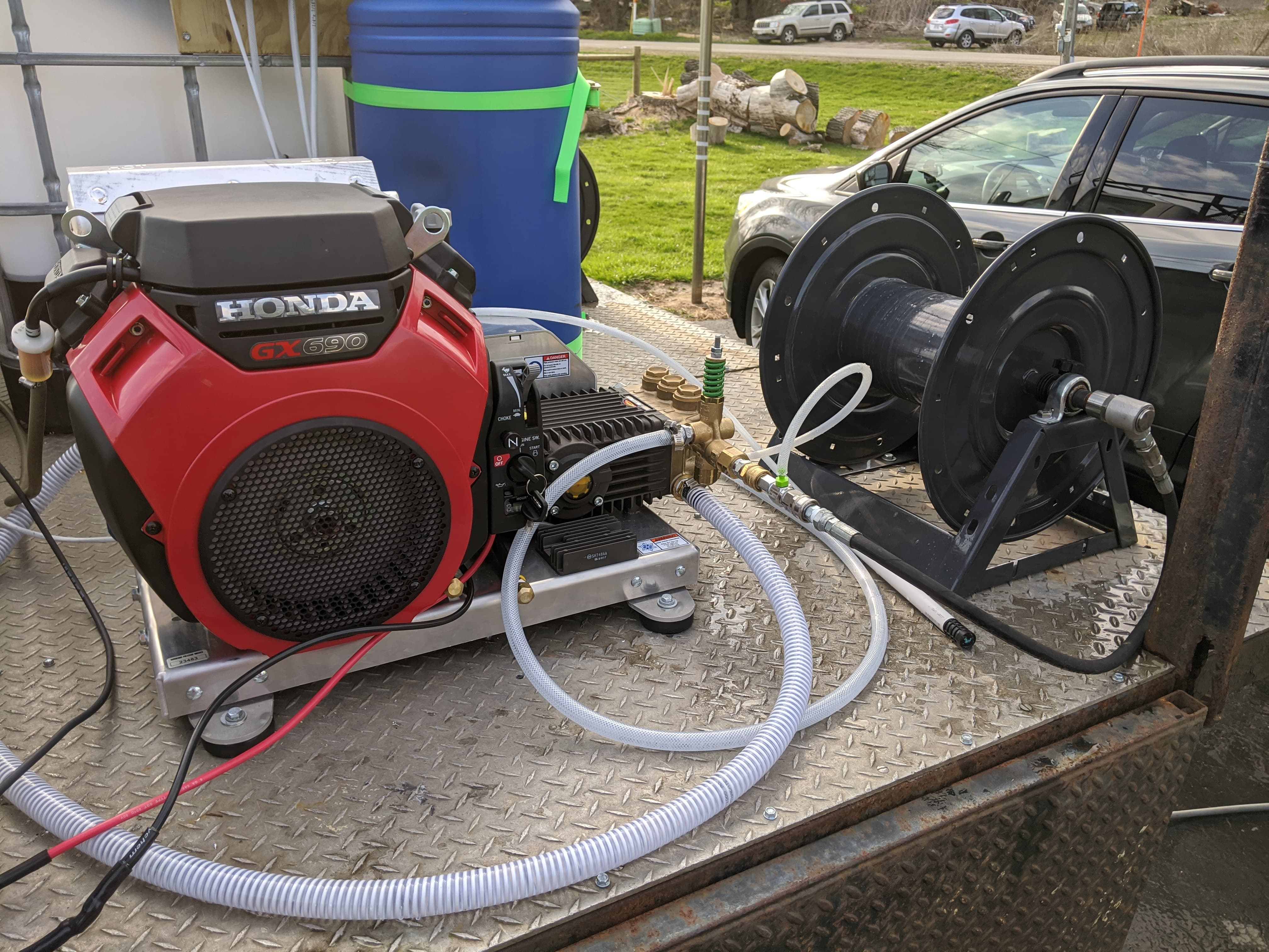

I am at a loss for what is happening and don’t really want to take everything apart to put my 4gpm back on. Any advice would incredibly helpful! I attached a few pictures of the injectors and of how I have it plumbed.
I also run a homemade remote box and frankly it will be restrictive with the extra hose length and various valves to work through.

@WiscoWashPros try moving your injector further downstream from the pump. I’d recommend putting it right at the swivel inlet of your hose reel.
I thought about that. My hose reel is right next to the machine so the line is about 2 feet long. With the whip lines I have, I can move it about 4-6 feet away from the pump. If you think that will help, ill give it a try tomorrow.
I’d bet a shiny penny that it will help. You’re not going to get 1+ % with a 9gpm unless you’re force feeding. .7 is sufficient to wash almost all vinyl or painted surfaces. Stucco and other more porous substrates will require slightly higher.

I would try a 1/2” whip line from the machine into the reel and move your injector away from the unloader too. Once you get up and running these will help get your ratio stronger. If you want there is a way you can get 3% on an 8gpm so somwhere in that ball park for your 9 2.6 to 2.8% at the nozzle.
