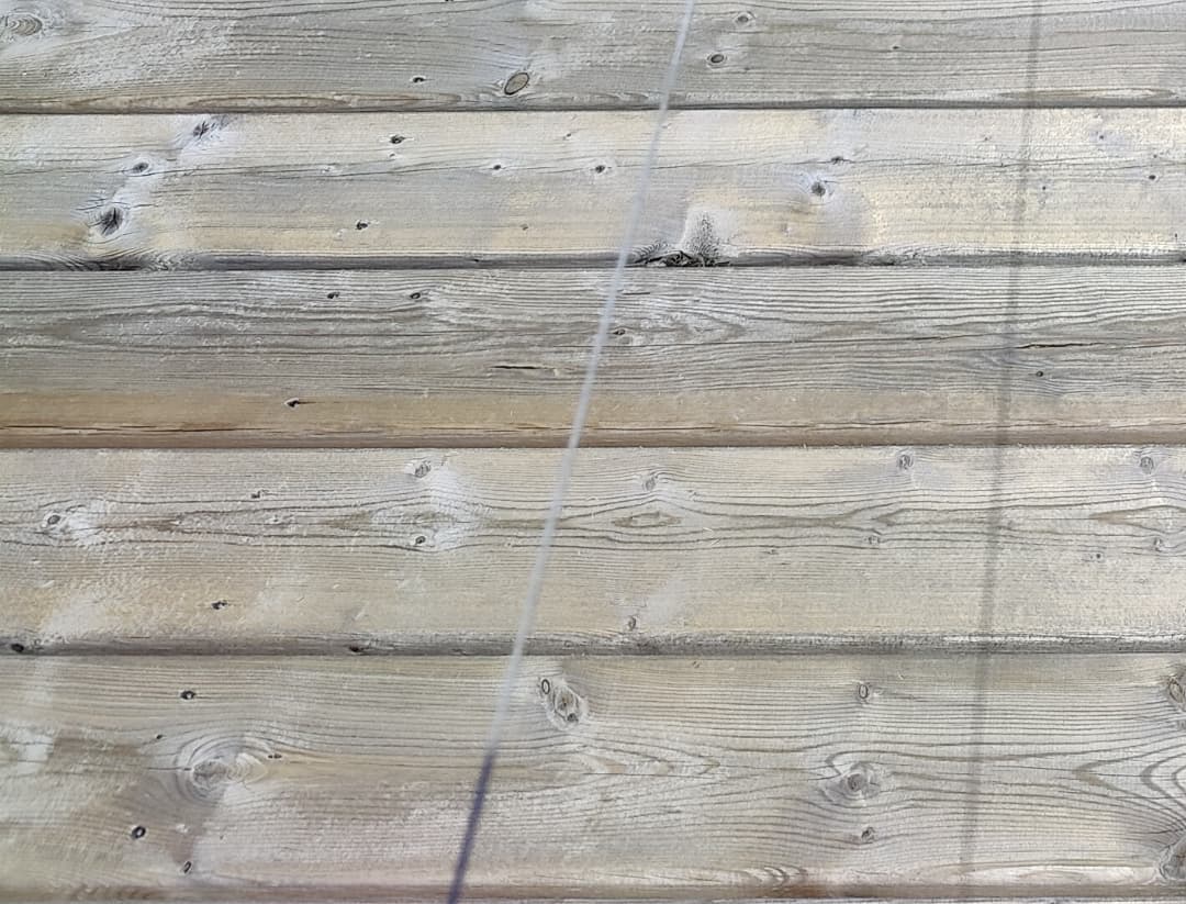

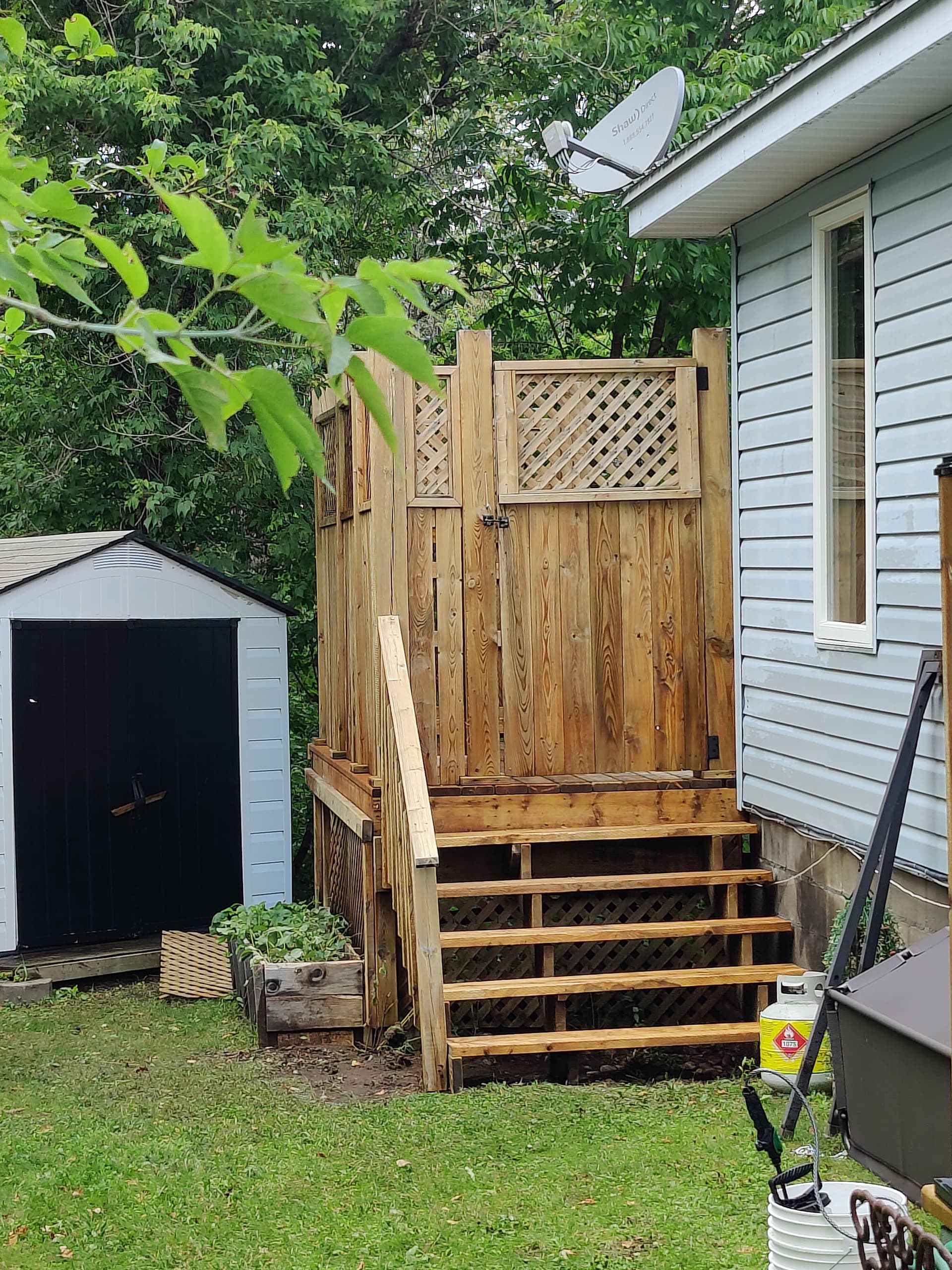

After I clean wood it seems like there’s always white residue left behind in the wood, specifically on the nuts of the wood. I’d like to avoid that in the future because most of my projects involve staining the boards at the end and it’s takes a long time to sand down an entire deck. You can we the colour difference through the stain. I’ve attached a photo of the issue below
I have been letting metasilicate sit for 10 minutes, rinse with a 25/12 nozzle on my udor 30/24s. Sometimes use a 40/15 nozzle. I like the 25 better. I then follow up with oxalic and let it sit for about ten minutes before rinsing that off. I usually rinse the oxalic off with my M5.
I think I am probably not rinsing enough after the metasilicate, but I don’t want to have to go over every board twice. I have also seen a lot of people say the leave the oxalic on without rinsing at all, which makes me think the oxalic isn’t the problem.

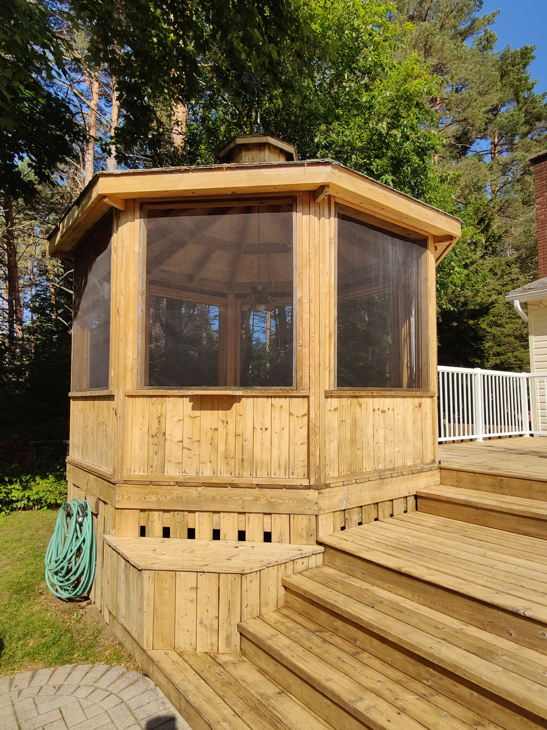

Also attached a couple photos of some recent projects.

Couple of questions - are you letting the metasilicate sit too long or letting it dry or mixing it too strong? That wood looks like it’s been bleached out. I’ve never used the stuff, so don’t know how it reacts. Maybe try doing smaller areas at a time. Sure someone who uses it regularly will jump in here soon @DisplacedTexan
I use metasilicate. We do a cup per gallon and it never comes out that bleached even after an ox wash same amount of mixture per gallon. We also don’t have a fur problem like that either. Which could be a too much pressure on the wood problem. We have the same dwell time as you pretty much but we also don’t let it dry until we walk away from job
Also I could be wrong but I think if you leaving oxalic on it’ll not be good. Rinse everything a lot. We are almost flooding every yard when we do decks. Have you done many other jobs with meta or are these it.
What type of mix are you using with the SM?

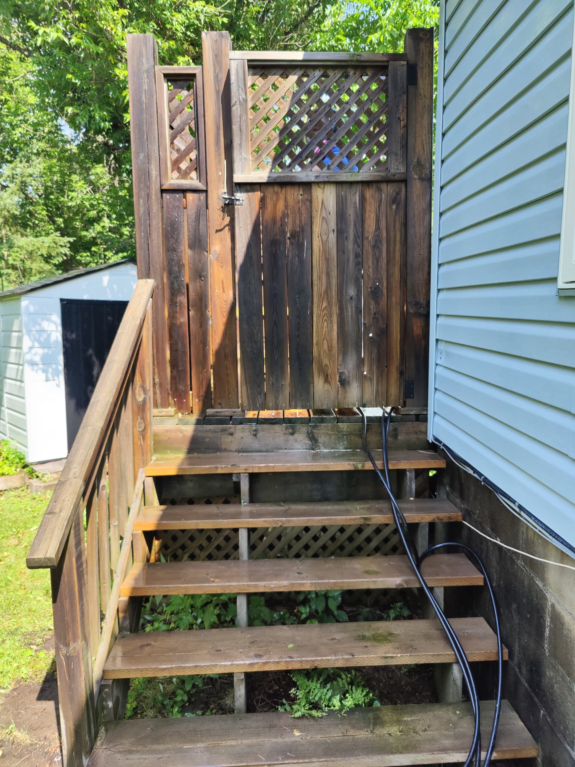

I typically don’t let SM dwell for more than a minute or so. Once it turns the wood black, it’s pretty much ready to be rinsed. You also have to work in smaller sections with the SM so you don’t get behind on rinsing.
For example, in the picture below, I would treat the vertical boards first and by the time I’m done applying the SM I would immediately start rinsing at about 800psi. Then do the steps and so on and so forth. Just work small sections.
Also, I have gotten into the habit of pre-wetting any wood before washing. Seems to help.
One thing to remember is that wood furs. There’s really no getting around that. You can do your absolute best to limit the furring (and you should) but if you’re going to be staining afterwards then 90% of the time that means you’ll be sanding anyhow so don’t get too caught up with the furring.
Renting floor sanders is CHEAP. Don’t be afraid to spend a little money to make life easier.
Missed a spot :grin:
Iv never heard anyone rinsing the SM that fast!! We may try that next time. Do you agitate the wood at all? Like a nice deck scrub?
It all depends on the condition of the wood. If it’s really, really neglected then you may have to let it dwell longer but most of the stuff I work with is in relatively decent shape. The only time I’m scrubbing anything is if there’s dirt buildup, lichens or anything sitting on top of the wood.
The deck posted above looks to be in pretty nice shape. Usually the steps are the first thing to show signs of neglect and those look fine. In my opinion, SM wouldn’t even be what this one really needed. I’d be surprised if it didn’t clean up just fine with just down streaming from a 4 or 5.5gpm with one of the Gold Standard injectors. Sometimes that’s my preferred way since I can let it dwell a bit longer and work at a slower pace. Just have to do an OA post and rinse the snot out of it.
