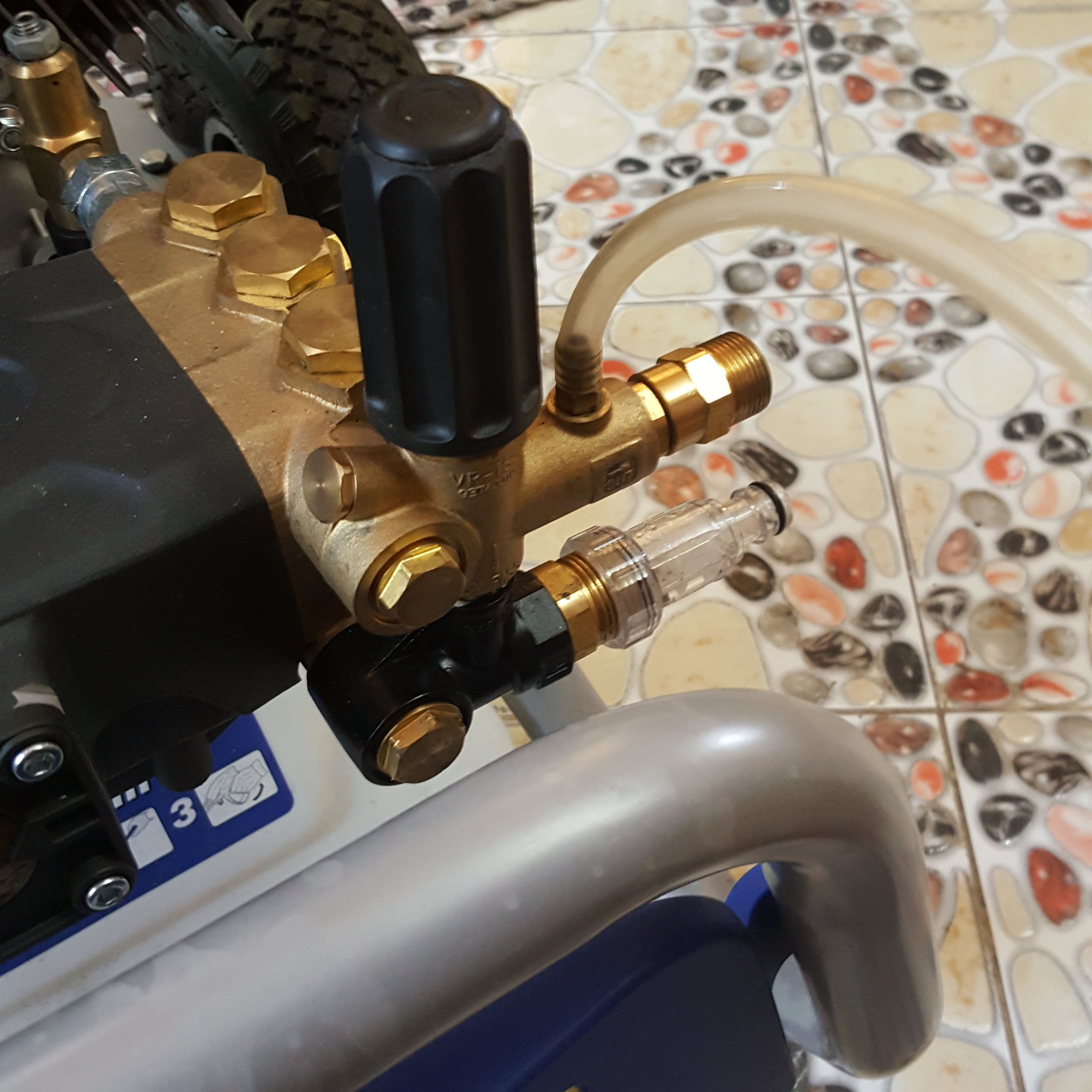

If I buy the hi-draw injector from Pressure tek. How can I connect it to my outlet. Would it work if I connect it it to the outlet I currently have then just close out the old nipple for soap. Not sure if its built in but looks like in can be removed from.the side but it wont be compatible with the hidraw injector. So was just wondering if connecting it straight would be fine

Clean homes and driveways. 4gpm 4000psi. I just feel that my downstream Injector pulls slow so was wondering if the high draw one would help me pull more.

Search for it on here. There are a few other threads where members talked about plugging the built in injector and adding one before their hose reel. I think they just took the guts out, removed the barb, and capped it off.
What’s that clear plastic quick connect right below the inject where your water supply is? Is that some kind of filter with media inside? Looks like a pretty small opening. I’d probably get rid of that. Add a better filter. I use those Blue Top filters and like them.
Ok will search it. Yes that’s the stock filter that came with it sadly but yes I already have a better filter. That’s moss in there btw flew into my water supply while I was playing around and blasting away to test and get a hang on things. Still got a lot to learn though and thanks to this forum I did learn a lot
