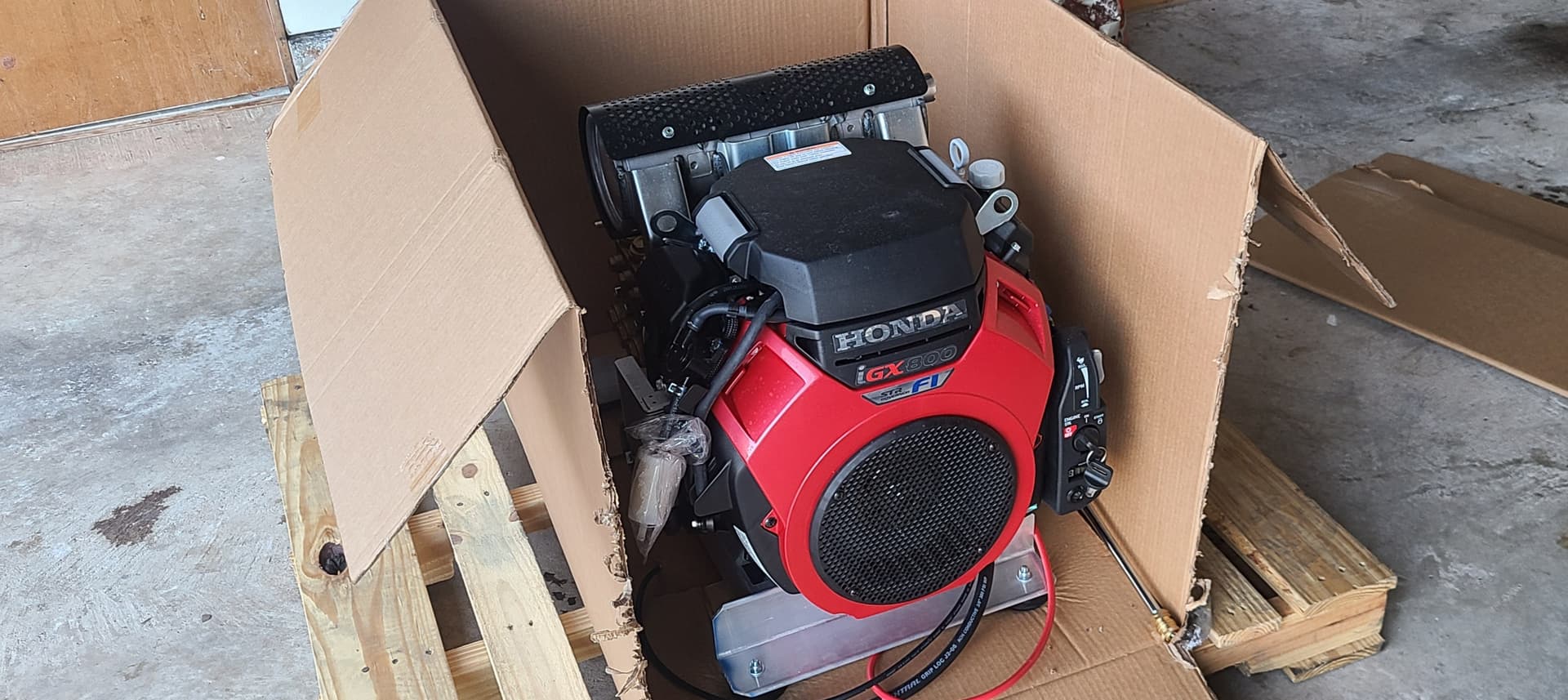

Nothing like unpacking a fresh Honda

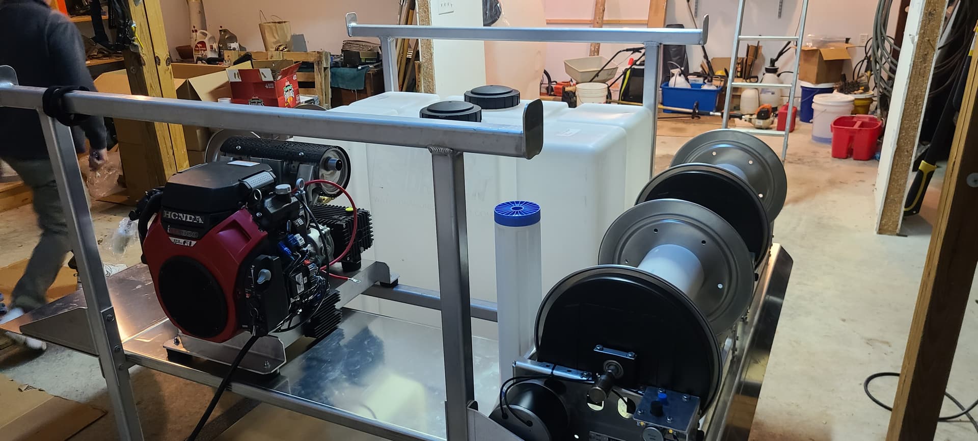

Finished cleaning up the wiring & hose. This skid is getting pressure tested tomorrow & loaded Sunday…

Nice looking build, need more pics. Show me where you’ve got Flow Pro actually mounted.

The actuator is held by (2) stainless steel rubber cover clamps (1’’) Mounted over the DN10 inlet & output… base has velcro cushioning… Rock solid!
Control box mounted with angle aluminum, stainless steel self tapping screws, & bolts…
