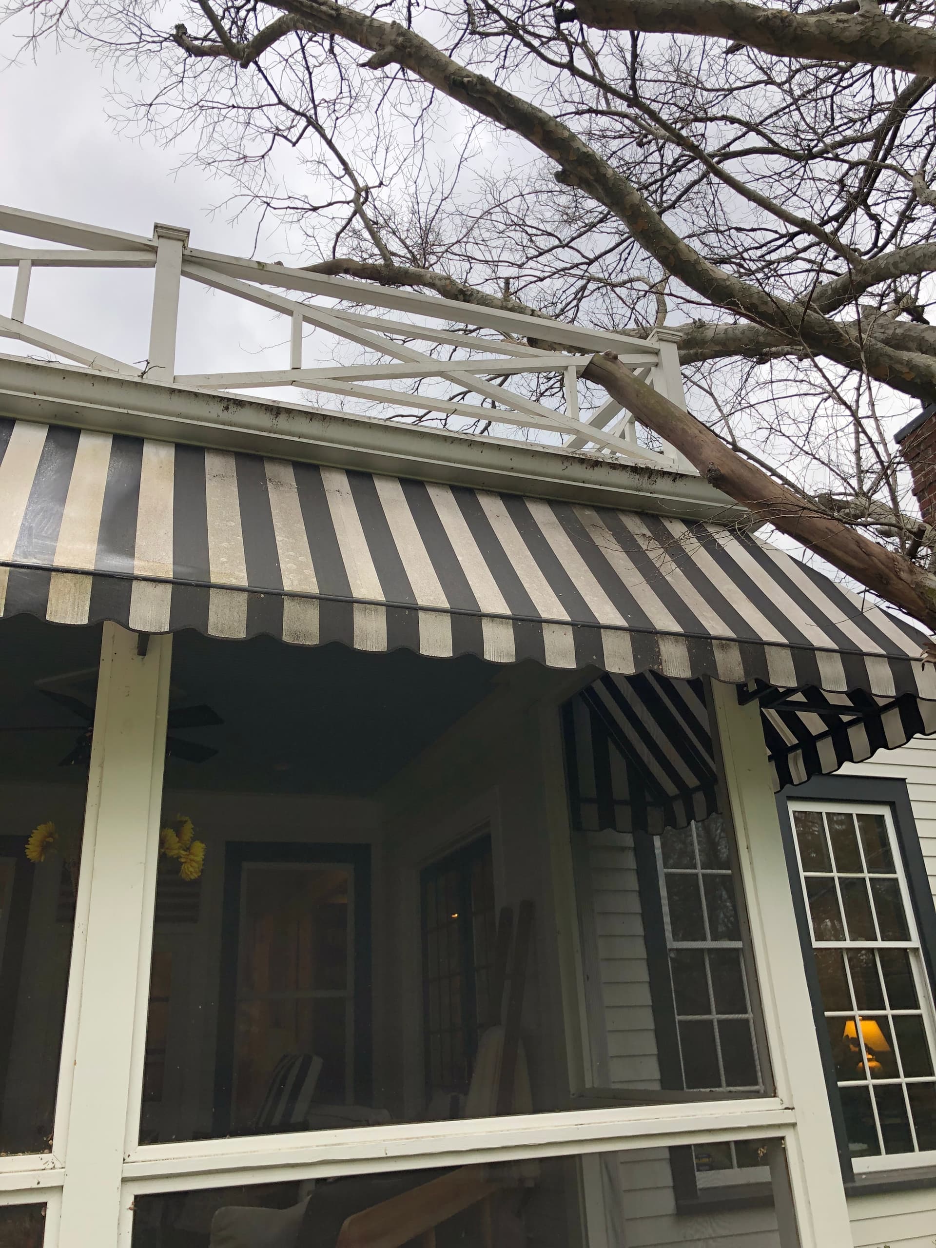

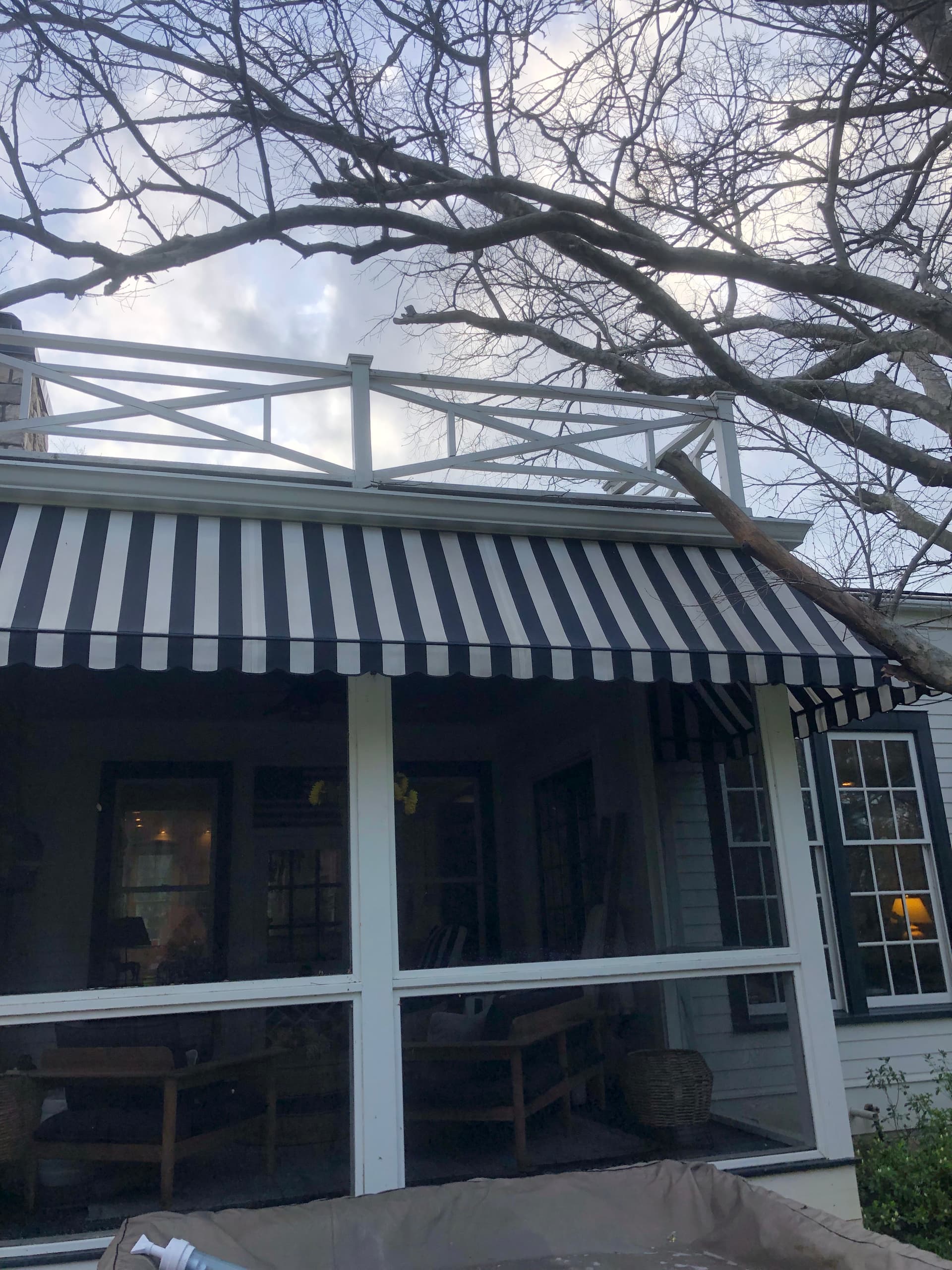

I just did my first black and white awning today.

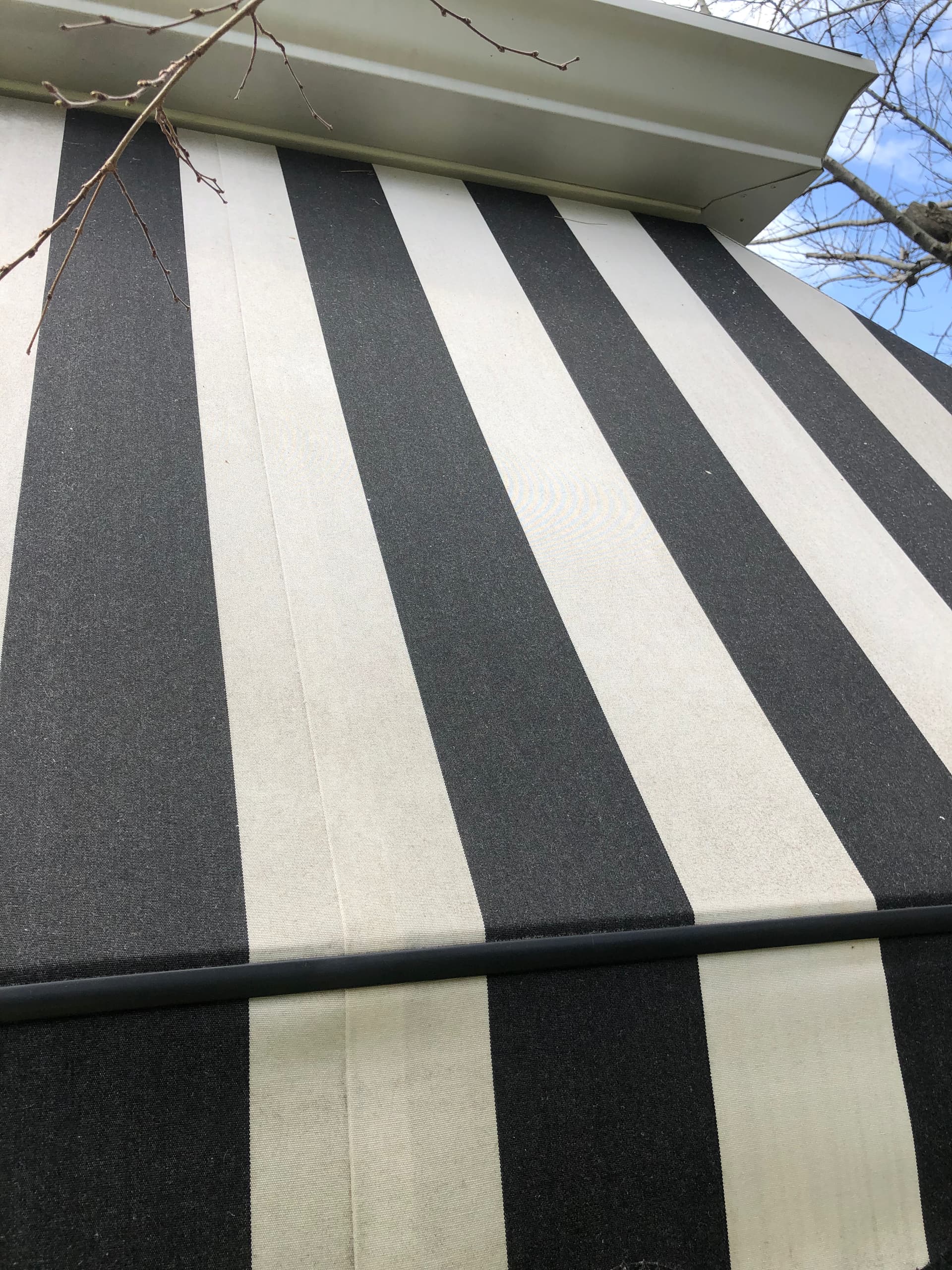

Pretty nasty, picture doesn’t show how bad it was. I did the usual bleach/scrub/bleach/rinse procedure and frankly I’m disappointed.
The dead mildew turned brown as usual but made the white stripes a light tan color. I talked with the customer and she said it’s a vast improvement and go ahead with the rest but I’m not happy. Sorry the pics are reversed, dirty one is on the bottom.
What more can I do? Will the sun eventually bleach it out?
I think it looks very good. Sometimes we can not fix what a homeowner has neglected for years.
Idk Brock it looks perfect in your picture. :grin::+1:
We’ve done quite a few awnings 4.5% bleach and rinse and repeat as needed lol thats all we can do.
Customers have always been happy
Looks like you need a little stronger mix. What % did you use? Doesn’t look to bad in pic though.
I’ll try and get a better ‘after’ pic today, need to go back for the window cleaning.
I’m with everyone else on this one…I’d consider that for a solid before/after promo pic for awnings if the angles were better :joy:

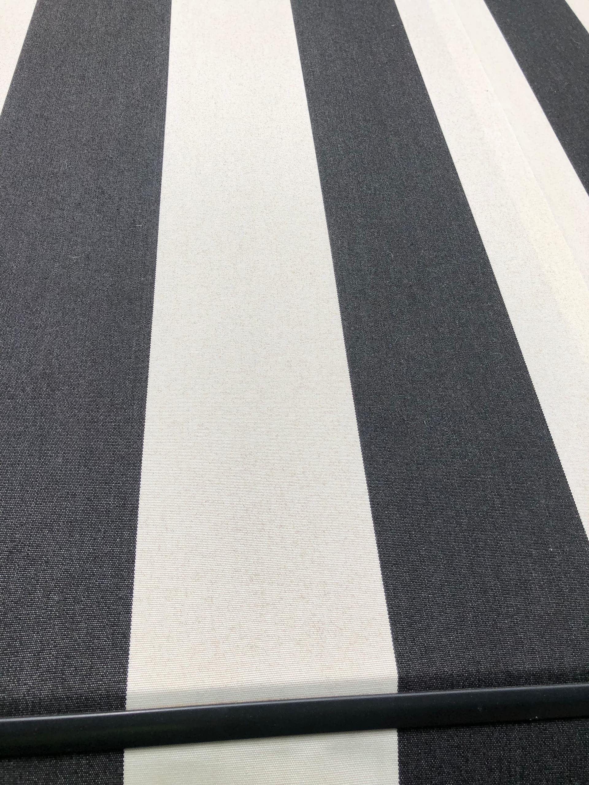

Here’s a better close up shot if you can see the grey spots on the white part.
Looks pretty good to me….I wouldn’t worry about it.
