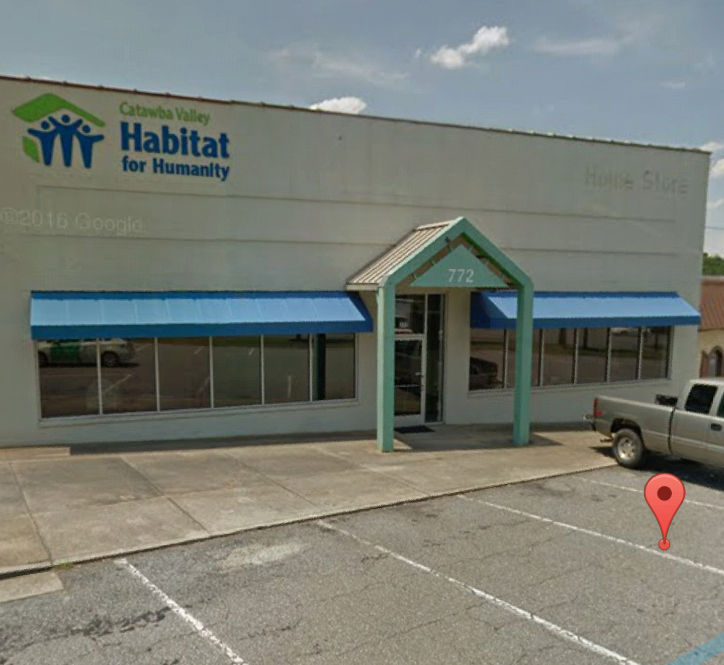

@squidskc how would you go about this. It’s my first commercial job bid so I wanna make sure my hw mix will be OK on the awnings. Can I just DS like I do on a house and just rinse?
BTW it’s painted brick
If that’s stucco/EIFS you’ll need something stronger most likely. It doesn’t look that bad though. I’d probably ask to test a section and see what downstreaming does on maybe a 6 foot wide swatch.
Do you DS straight 12%? What’s your injector’s ratio?
I withdraw post from the other on after I found this one lol
I just saw where you said painted brick too. I’m bad at following directions today. DS should be fine.
No I have only been able to get my hands on 10% but I am setting up my 12v pump system so if needed I can make mix as strong as I need to.
Test a section DS ing where the removed letters were. If it works then no need to waste SH.
Oh it’s not habitat for humanity any more. That’s a old pic off google maps
Just the front with awnings I’d probably charge $800. That’s a small store front. Half a day and I’ll fish the rest.
Gottcha. Thanks I knew I could count on you lol… I gotta ask about the flat work he didn’t say anything about it just store front.
