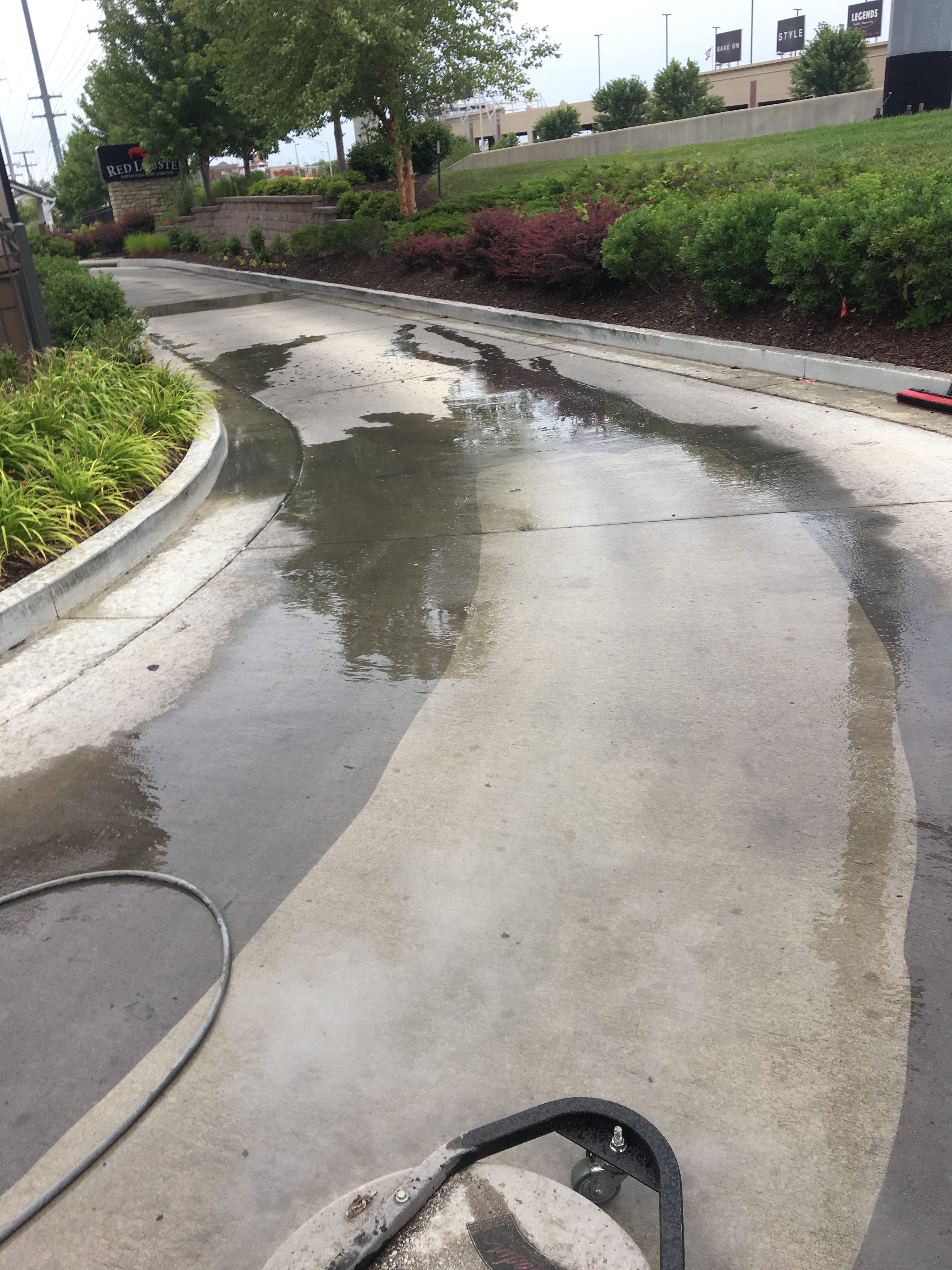

Tire tracks will go away with hotwater too. Do it all the time with drive through and dumpster pads.
