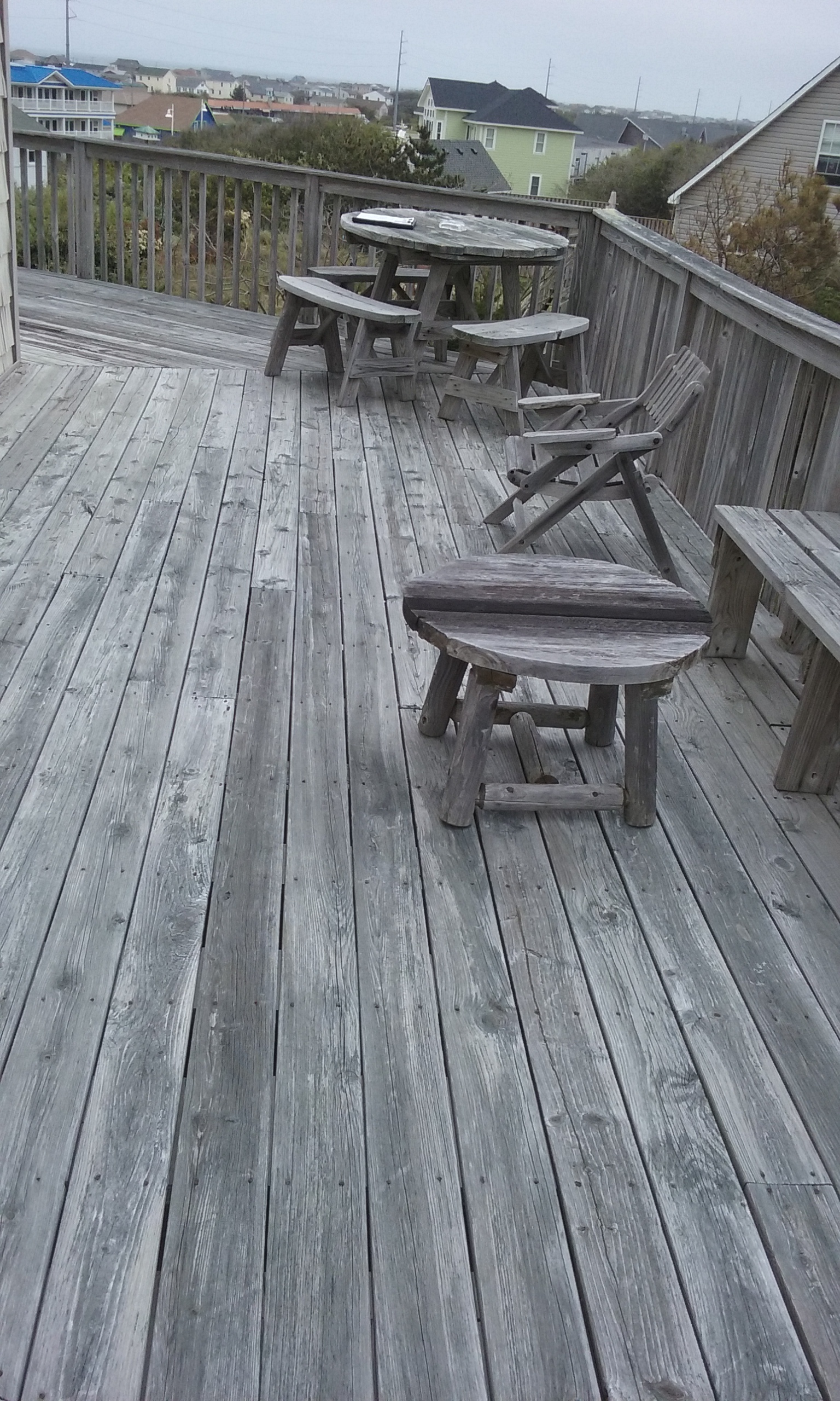

I have attached pics of the deck, there are two levels of deck and etc, only doing inside of pool deck fence.
Carolinaproclean,
Nice job. That PT SYP will clean up nicely. From the pics, I’d use a sodium percarbonate wood cleaner followed by an acid neutralizer. That wood will glow! Rinse afterwards if not using Ready Seal.
