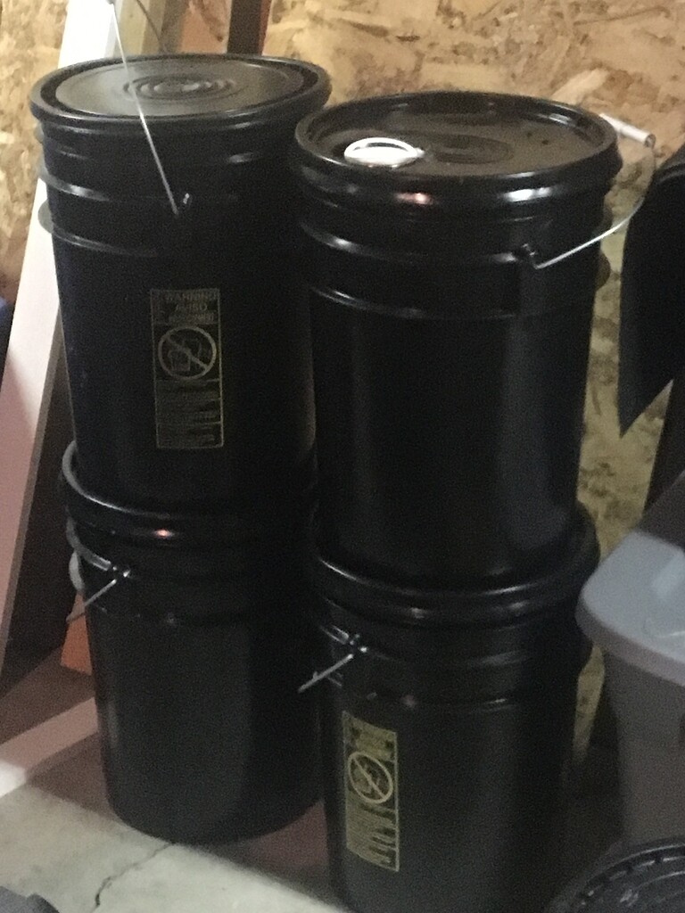

Hi everyone. Just starting a pressure washing business. I am starting to learn about the different chemicals and how to use them. I want to do standard pressure washing (driveways, patios, ect.) and also roof washing and house washing. I wondered what type of storage and application methods you have. I have an x-jet and a downstream injector. I originally thought I would get a 1 gallon sprayer for every different chemical for direct application on stains and such. Then when doing house and roof washing mix it up into 5 gal buckets. Does this sound sufficient for just getting started?
Thanks in advance!
-Evan
Yes, you can mix your bleach and soap into 5 gallon buckets, and then downstream or xjet out of them. Roofs you will need something stronger to apply with, like a 12V dedicated pump. Roofs take a lot more mix than a house… 30-40 gallons or more isnt uncommon, even on small roofs. Best bet there is to mix it in a 55 gallon drum, which you can find on craigslist for $15-$20.
You can find better mix tanks, of course, but thats a start.
