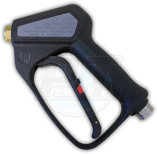

What is your gun rated for? Injector can’t be mounted directly or close to the pump.
The gun came with the machine, so I would assume it’s suitable for it? I have the injector as the first thing out of the pump. I didn’t know that I could put it anywhere else…

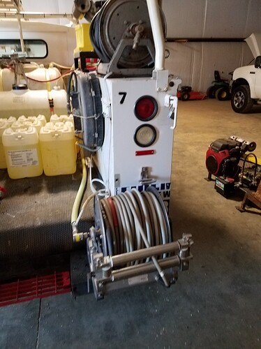

Gun that came with machine is probably junk. Put injector at hose reel. If no reel run a 1 or 2 foot jumper from pump. Water needs to straighten and be less turbulent when it hits the injector.
My injector is coming right off of my unloader. Is that not the right place for it?
I have a reel. I’ve never seen it done that way. This is like starting all over, lol.
I also didn’t know gun quality could vary so much. What type would you suggest?
Put the injector at the reel swivel
I learn something new every day! Looks like I will be relocating my DS injector tomorrow.
